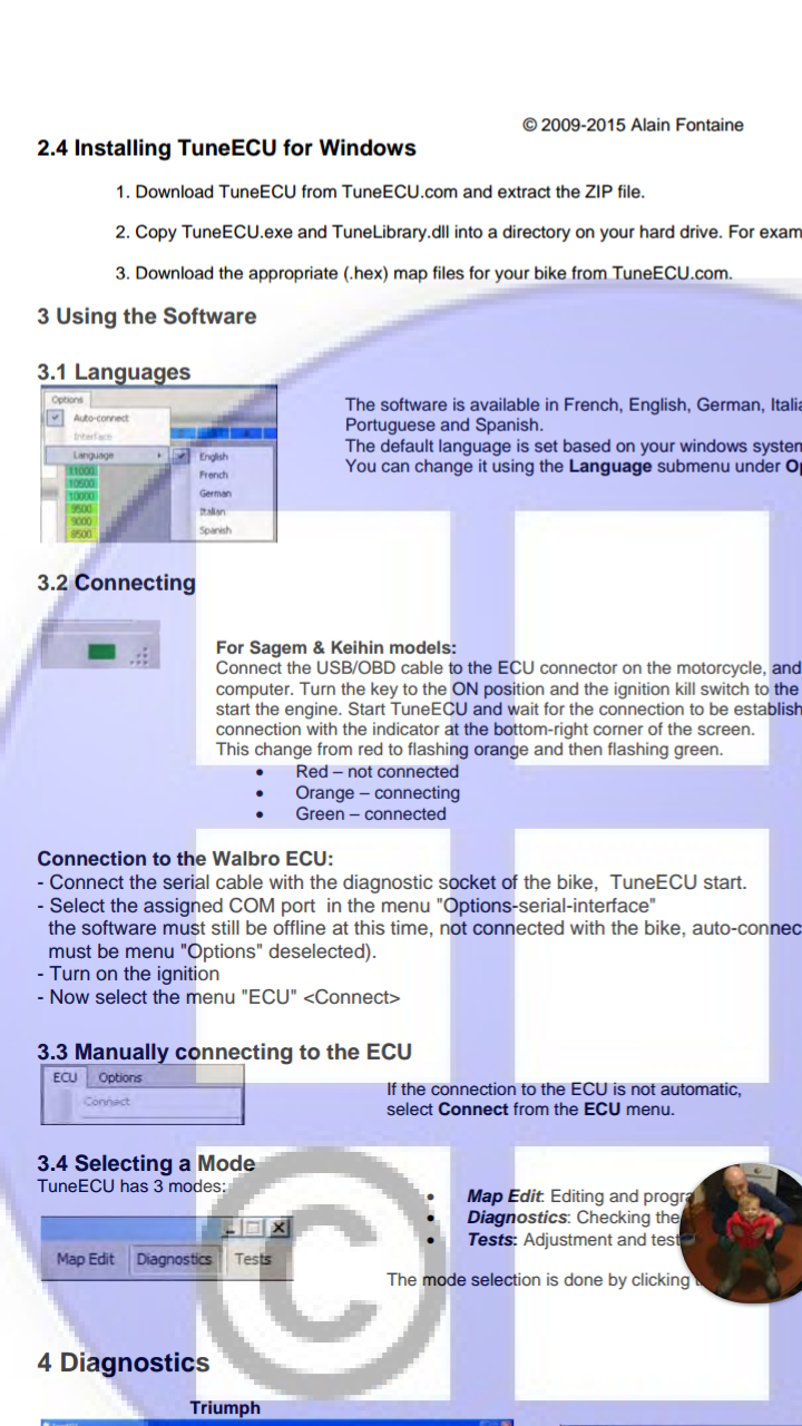

    The best advice for using "tuneecu" is on the tuneecu website, I would recommend using battery charger on bike battery during use of the program and if using a laptop plug its charger in to ! Pull headlight fuse if you don't have a battery charger. Make sure you have the correct cable driver and if using windows 7 or 8. Have all recommended updates , check tuneecu website, if windows 10 turn off internet when installing cable driver. Use only the recommended driver, this works best, if you leave internet connection active windows will search and installed the driver it recommends, this will work but the connection can be intermittent or slow on each first use .

    Was goin use the android app on my phone dude.but I might install ecu tune to my tablet it's on Windows 10.
