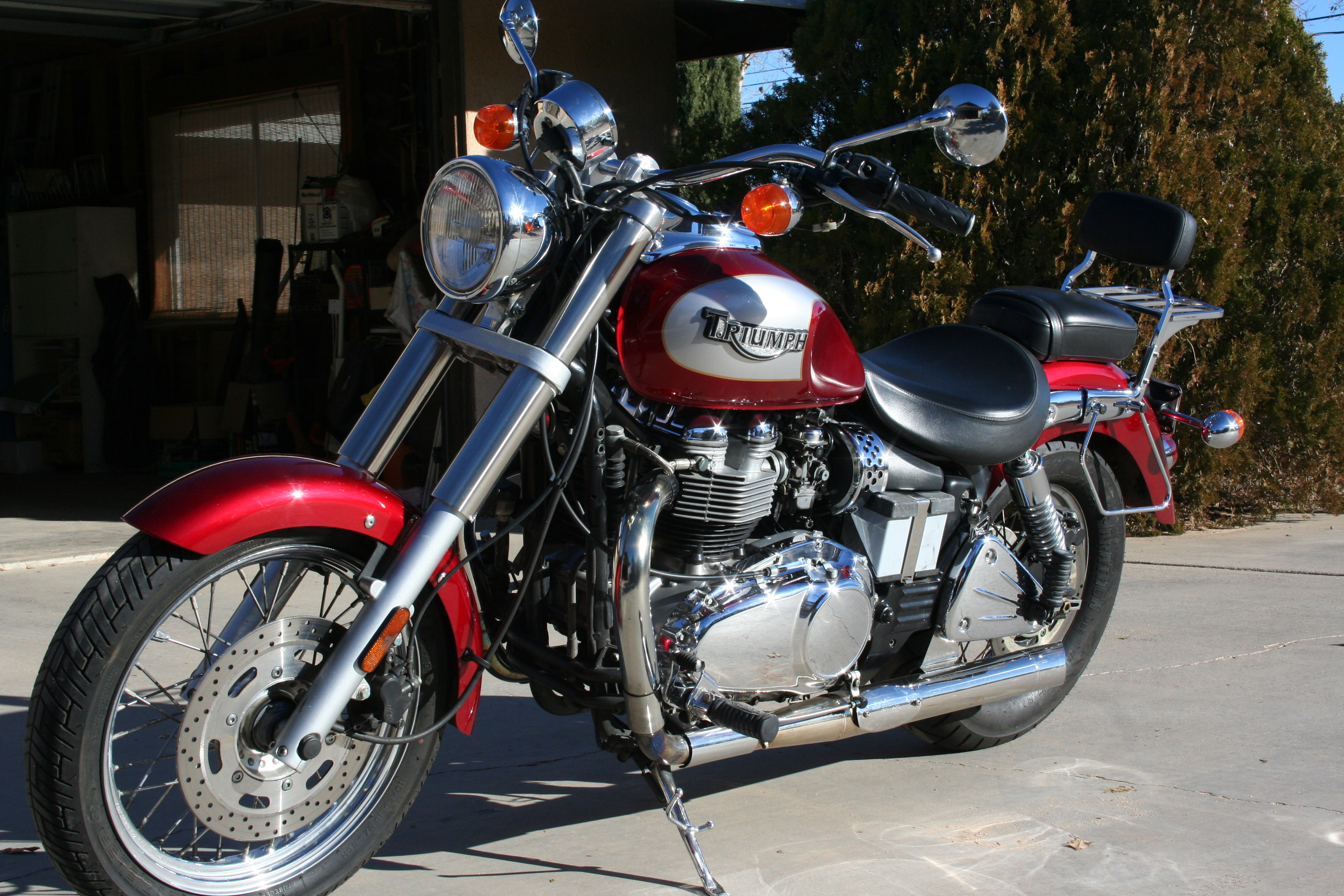

    Triumph Bonneville America.JPG DRW: I am riding my America more and more as I get older. My knees, hips, and ankles are all showing a lot of wear and tear.[I am pushing 75]. All the Bonneville series shared many of the same parts. Engine, brakes especially. They shared as many parts as possible to keep production costs down. Among the air cooled bikes there is an early and a late version. Generally speaking, the EFI bikes are the late version while the carbureted bikes are the early version. Used parts for.these should be abundant and cheap. :)
    ...J.D.
    I just added an old left side picture I found of my America as it was when I bought it. If you look close, you can see how they just brought a shift rod forward from the BONNIE transmission and moved the footpegs. This is how all Americas and Speedmasters were set up. That is not an add on.
