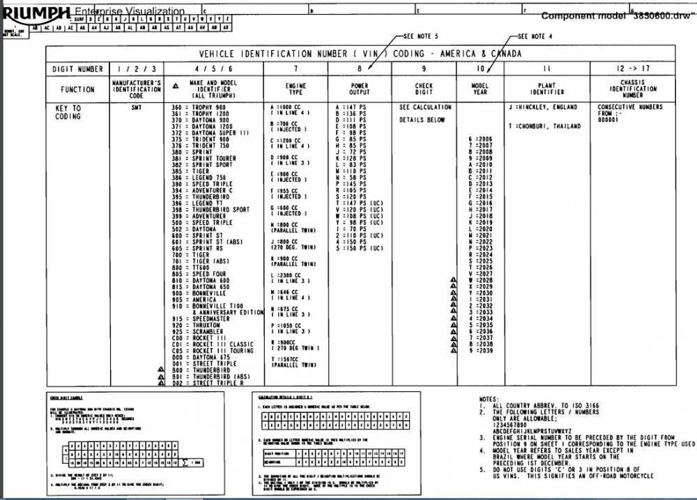

    as I needed to know the answer, not because I care where it was made, but just because I like to have the answer to an enigma, the European system, including the UK has the world manufacturer id as the first three letters, SMT for triumph, the 11th digit plant id only applies in north america, as far as I can tell it is impossible to say from the UK vin where your bike was built.
    SMTTJ9102G7xxxxxx

    InExactly right! the European plant code is the 5th letter
    J for Jacknell Rd Hinckley
    T for Thailand
    Remember it is the assembly plant code and they ship parts in both directions.
  15. Tom Gillam
    Tom Gillam Guest
    I have the the same vin code as above,and somebody mentioned that the j is for Jacknell,so I believe this is a U.K. bike.
    Thanks for the replies.

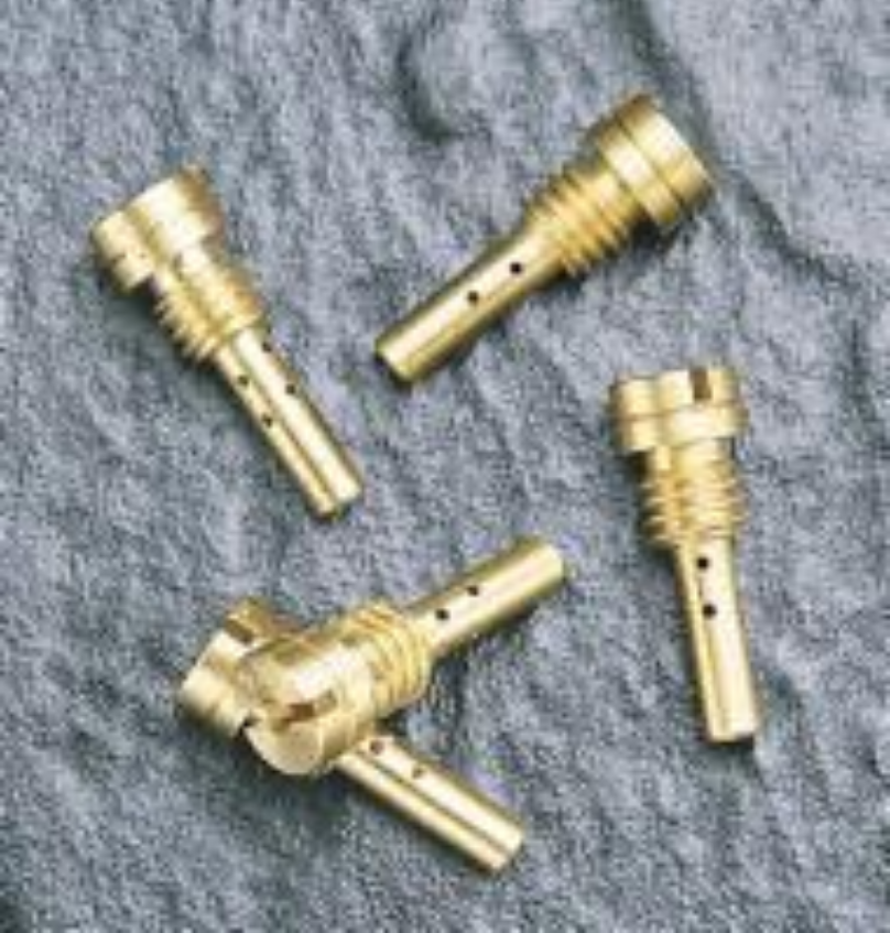

    Can anyone please tell me whether the pilot screws are slotted or Phillips or something else?
    I’ve tried taking a photo from underneath but it doesn’t show what they are.
  17. MadMrB
    MadMrB Elite Member
    Dec 24, 2018
    3,566
    Northamptonshire, UK
    #77 MadMrB, Dec 9, 2019
    The pilot jets themselves are slotted...
    The mixture adjuster screws are a D shaped head, and you can buy a tool: https://www.squaredeals-ltd.co.uk/d...keihin-carburettor-adjustment-tool-6617-p.asp
    Or apparently you can also get mixture thumb screw adjusters to replace the D head screws: https://www.squaredeals-ltd.co.uk/d...xture-thumb-screw-adjusters-3-only-3976-p.asp
