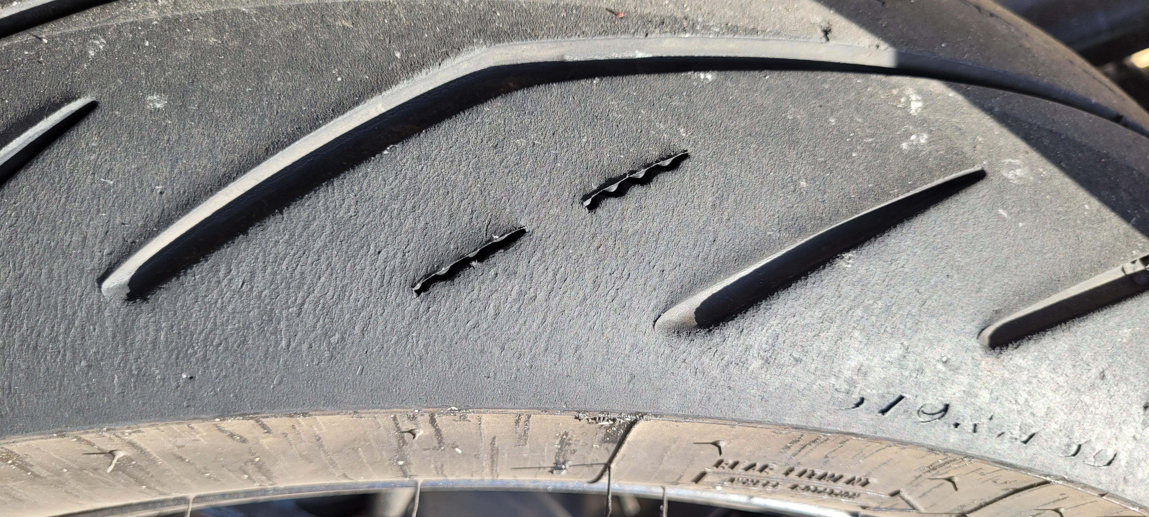

    So, I have my Street Twin with me on holiday in Devon, UK, and I picked up a slow puncture 3 days ago. What a pain in the a**e I thought, but a trip to ProTyre in Plymouth ( outstanding service) and I am now shod with a pair of Bridgestone BT023’s. I’ve read a lot about just how shocking the standard Pirelli Phantom’s are, but until today I just didn’t get it. Wow, she is like a different bike - no twitching over white lines, grooves in the road surface, no problem. To say I’m over the moon is putting it mildly!

    The Street Twin was never intended to be a sports bike but as you've discovered the handling can be massively improved with a decent set of tyres. Most ST owners have by now realised what a mistake Triumph made with those terrible Phantoms and swopping to just about any other tyre is an improvement. I lived with them for a few weeks, thinking the twitching and inability to cope with our crap roads was somehow down to me getting used to a new bike. But it wasn't me. The Continentals on mine have made a significant difference. I'm glad to hear you've seen the light :sun:
