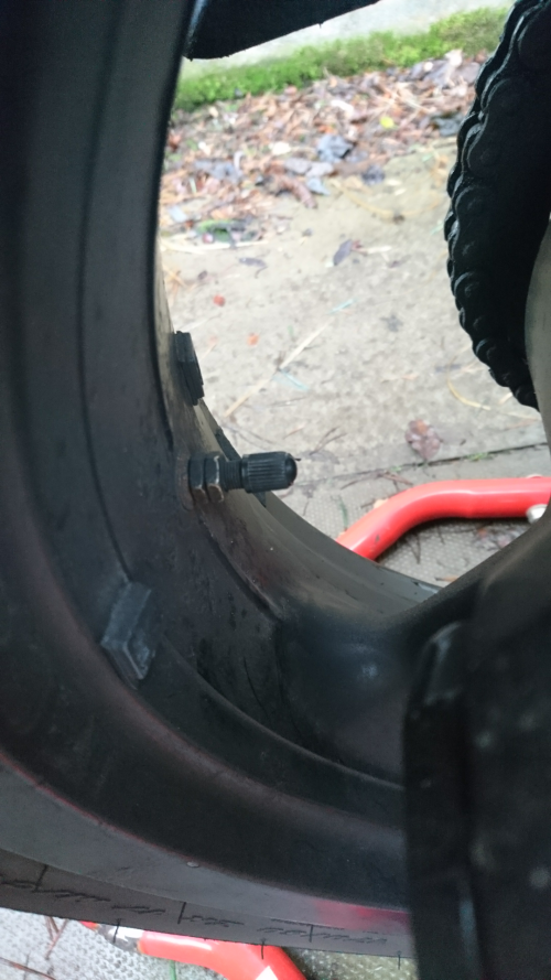

    My Sprint has two different sized tyre valves. The rear wheel is normal, same size as any car or bike valve, and is at right angles to the wheel. Despite the chain and the brake disc being in the way, spin the wheel a bit and it's easy to get at. (easy enough...)

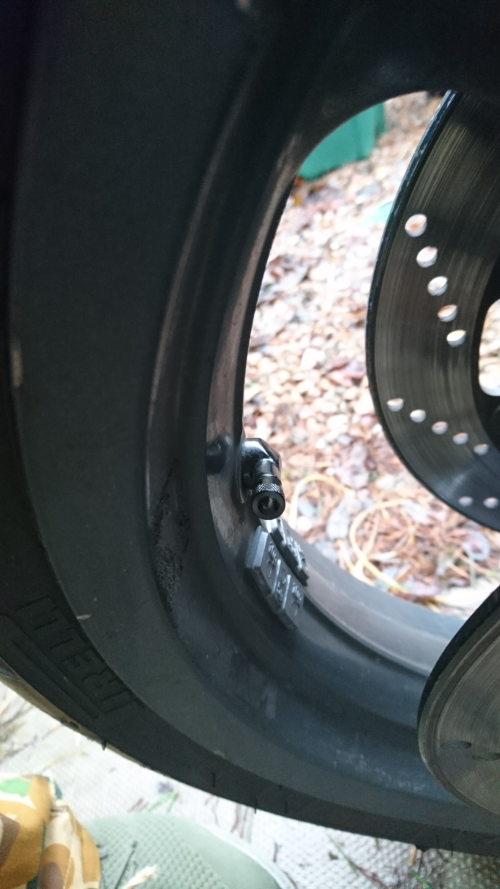

    The front though? It's cranked, aimed over to the left. And for some reason its a smaller diameter. I have to use a different pump for the front.

    Some piccies
    The front wheel....
    The rear wheel

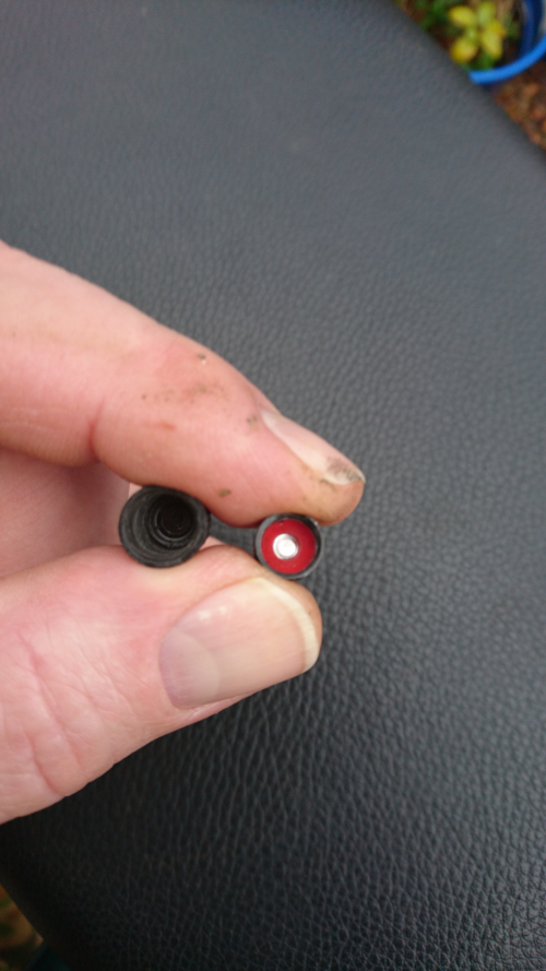

    And the difference in size between the two.
    And, look! I gots clean hands. Well, cleaner than usual :p
    My compressor tyre inflator is a push on type, it fits the back easy, but not the front. It won't seal. Foot pump with the flip lever fits both, so I suppose its going to depend on what a garage has if I need to use one.
    Wheels could do with a clean, huhh? Been either freezing or raining here so not had chance to clean the last rides dirt off.

    Planning on new tyres in spring hopefully so will get the front the same as the rear I think. Will make life easier. Just a shame to change the front tyre, there's a lot of life in it yet. But I suppose its of an age to change anyway. Its a matched pair of Pirelli Angels, so soon time to do some tyre research.
    That rear valve..... Does that look like it's a tube to you?
  10. andypandy
    4,083
    Having looked again, yes it does, but I couldn't be certain.

    The rear is almost certainly non standard ! My '99 '00 sprint had angled valves front and rear ... ! When you get new tyre on the rear be ready, look now for a new valve stem .. get an angled one to match front.
    Cheers capt.

    The straight one on the back isn't too bad access wise. But can see how a cranked one would be easier. Front would be worse if it was straight.
