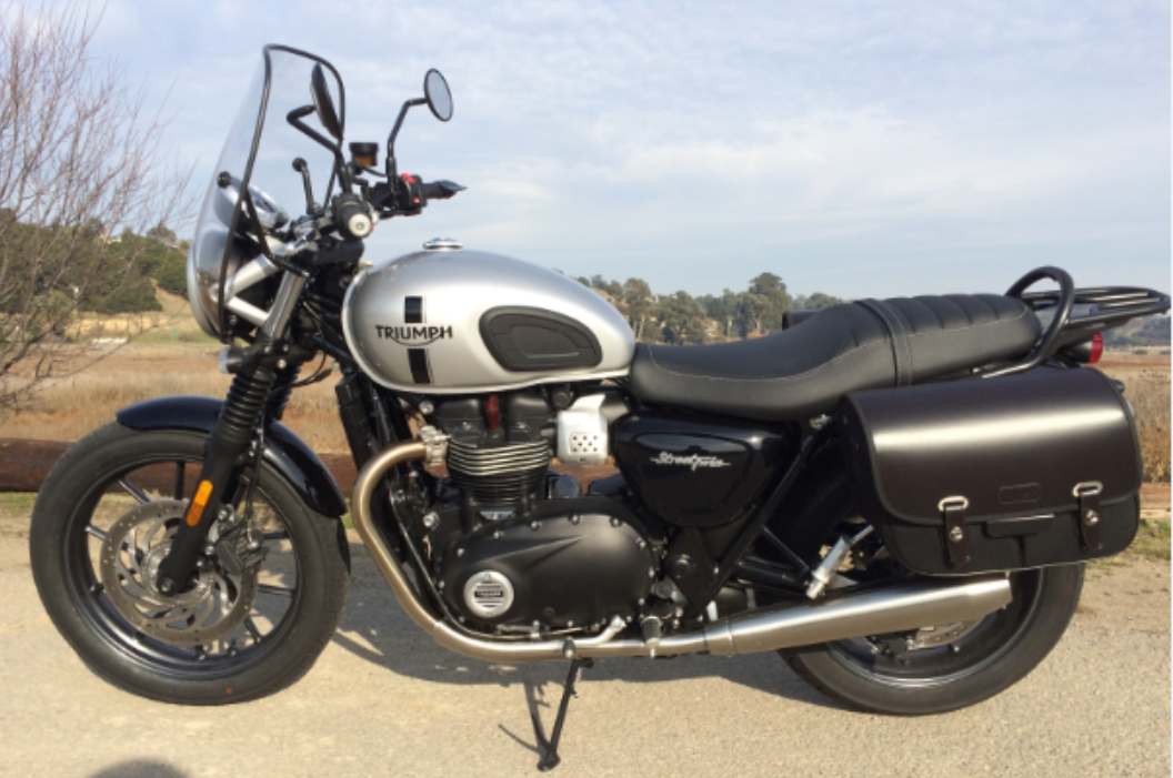

    I have a 900 Street Twin. Mine below. My wife and I are fine 2 up. True the seat is smaller than the T100 but I wanted the tubeless tires (cast wheels) for safety reasons versus spoked wheels and inner tubes. Also I can fix a flat on the side of the road if needed.
