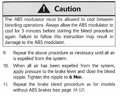

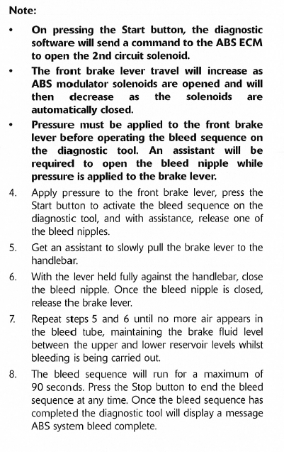

    I bled my ABS system last year using TuneECU but it didn't have an automatic time-out on the modulator, did you find the same?
    I mention this as the manual states the following -
    I may have let mine run for 2 minutes before stopping and probably didn't wait the full 5mins between restarts, but the modulator didn't even get warm.
