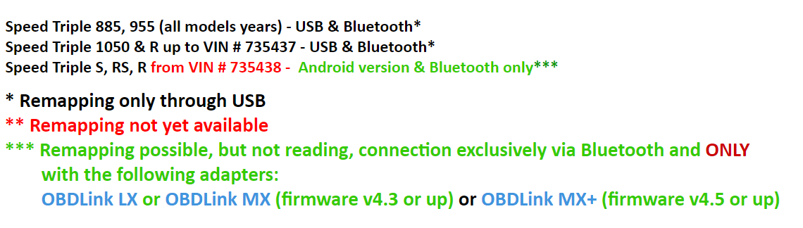

    Looking at getting TuneECU or Dealertool for home servicing my 2016 Speed Triple R.
    Anyone used either of the above on the 2016 Speed Triple R ?
    TuneECU seems popular but its £77 for an obdlink lx dongle then £10 for the software on the playstore so £87 all in.
    Dealer tool is £60 for everything.
    Just wondering which is best for my needs.
    Basically want to look at fault codes, reset the service symbol and carry out an ABS brake bleed.
    All help and advice appreciated.

    Thanks but the free version doesnt work on a 2016 Speed Triple R.
    I have to go bluetooth via Andriod I believe

    Yes, sorry it does look like Android & BT only...

    Probably depends on how much importance you place on the bluetooth side of things.
    I have the dealertool & only use it for exactly what you are stating you will use it for & its fine. The obvious downside is you have to run a cable from the bike to a laptop, but to me this wasn't an issue & was my prefered option anyway.
    Come to think of it, from memory the TuneECU didn't do a 2019 RS which may have made the decision easier!
    So if you think the 'portability' of the TuneECU is worth the extra, go for it.
    Being connected via cable will have less complications, but at the end of the day if you want the ability to check things anywhere, its only a few less lattes you have to go without on a few of those weekend rides ;)

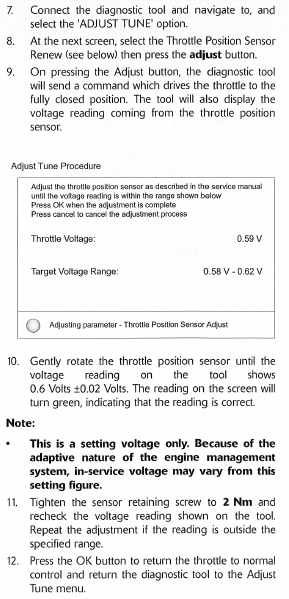

    I'm also on the DucatiForum. Resetting the TPS is a big thing on there. Is this necessary occasionally on a Speed Triple? Can you do it with Dealer Tool?

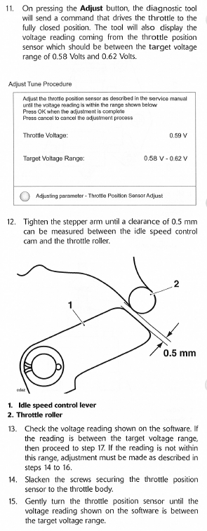

  17. Col_C
    Col_C I can't re...Member
    Aug 5, 2015
    1,435
    You can set the TPS using TuneECU so I would imagine it's available in DealerTool also. However (IMO) it's not normally necessary unless it's been removed or replaced, according to the workshop manual the adaptive ecu adjusts the output automatically (I'll post an extract when I'm back at PC).

    If you are "messing" with the TPS you also need to check the clearance on the ISC stepper motor is correct

    Brilliant. Thanks for that! Is that Dealer Tool or TuneECU?
  20. Col_C
    Aug 5, 2015
    1,435
    Neither, that's an extract from the Triumph manual so is refering to the genuine Triumph tool the dealers would be using.
    However I know TuneECU reads the throttle position/voltage, not having any need to run that procedure I don't know for sure whether it also drives the throttle closed for the adjustment procedure - I imagine it must do.
