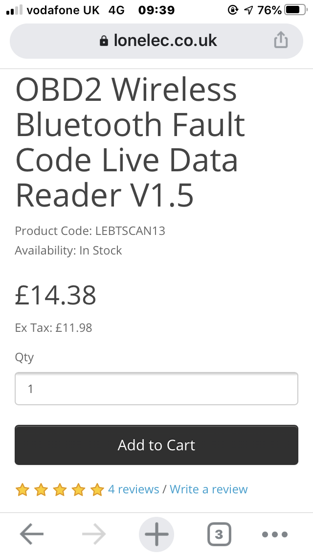

    I would say yes. The triumph architecture/bus system is probably the same and it’s only £24!
    Pic below is the one that I have.
    If you want to load maps, you need a obd2 Mx which is about 100. if you want to adjust things and reset (and not bother about maps) the below is fine.
    Also, MAKE SURE THE ENGINE IS PRIMED AND READY TO START (BUT NOT STARTED) as it’ll fail to communicate and you will think it doesn’t work! I know that...
