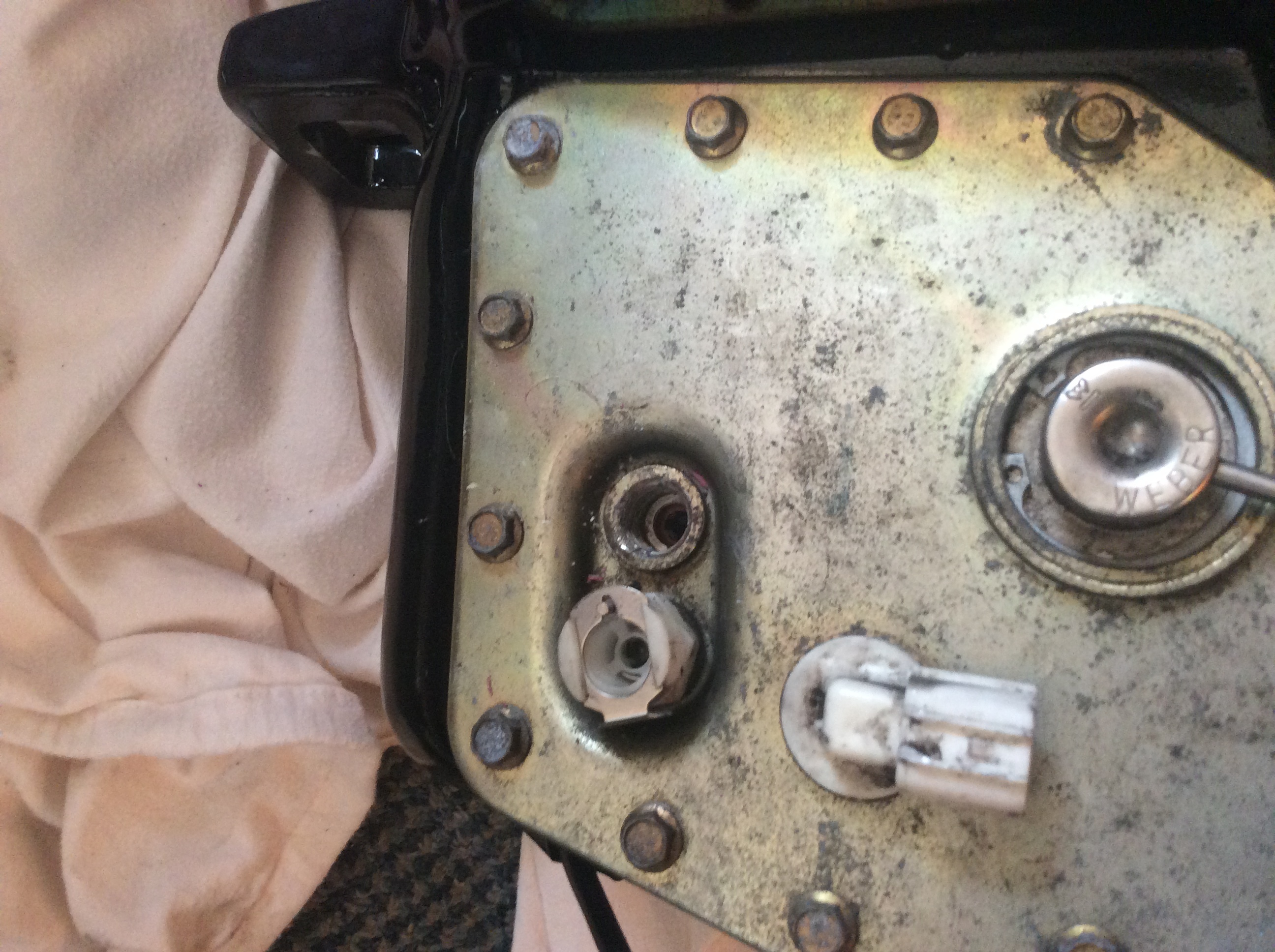

    I'm on newer system of connectors now, but remembering back to my 955i.......
    I think it's bad news, think the part that's snapped is part of the fuel pump. :(o_O
    Hopefully someone will prove me wrong.

    Its threaded so its not part of the fuel pump

    not part of fuel pump just got new steel conector from rs uk for 19 quid sorted

    yes i ordered that yesterday cheers

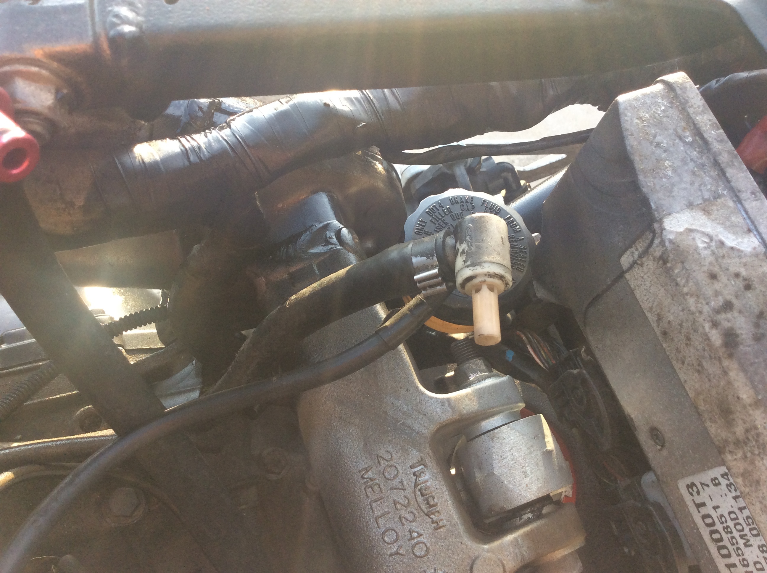

    Personally unless you REALLY know what you're doing I would stay away from adjusting maps (and also maps others have adjusted) - unless it's being done on a dyno. Outside of having some dyno work done I would stick with Triumph issued maps, and of the correct match to your bike's VIN number.
    If you want to avoid/minimise the pops & bangs then you need to make sure the SAI valve has been disabled both physically and with the correct map (one of the hoses needs to be blocked to disable the valve physically) - but see caution below.
    10170 map you have on at present by default is for TOR/aftermarket can with SAI enabled (you'll find a tick box to switch on or off in TuneECU), running in that mode it's worth checking the hoses haven't been blocked from a previous owners set-up (I used a marble between airbox and valve when I had a SprintST).
    Just decide whether you want to run standard or your Pipewerx exhaust and then if you want to minimise the pops choose the appropriate SAI disabled map and block the valve (many don't realise a physical block is also required).
    Caution - I have read accounts of disabling the SAI as being a bad thing if a cat is still in the system, apparently the cat can disintegrate and start blocking the exhaust. (my SprintST had a TOR and de-cat link pipe, so was ok to run SAI disabled)
