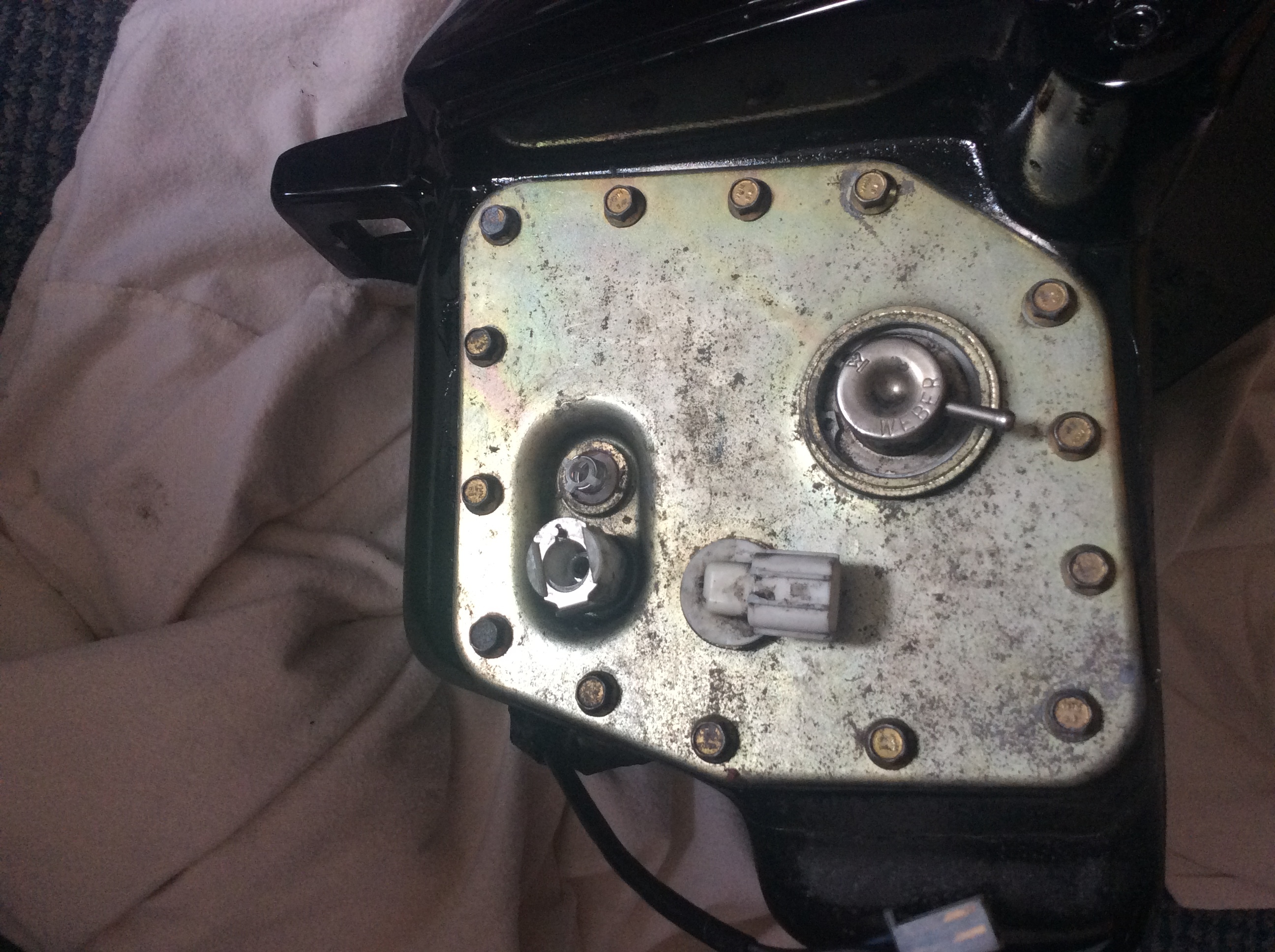

    Need help soon as please as you can see one of my fuel connectors has snapped off what is it called so i can try get one or do i need the hole plate
