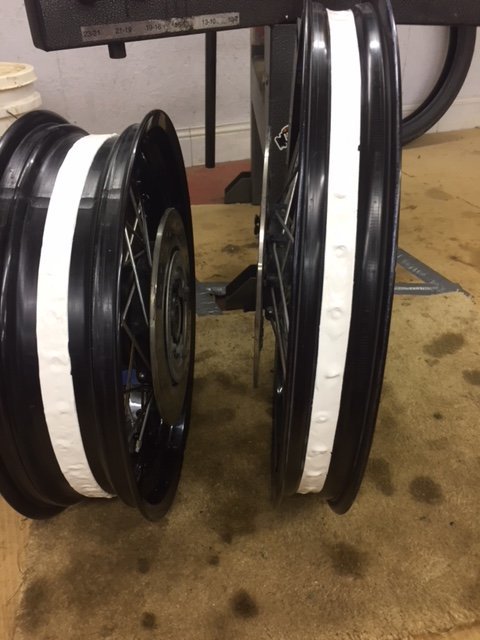

    You got that right no pressure drop thank you

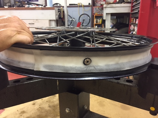

    About 3 months ago , still no pressure drop . I got a nice neat edge before applying the glue I used blue tape then once applied pull off the tape also tape over the valve stem hole
