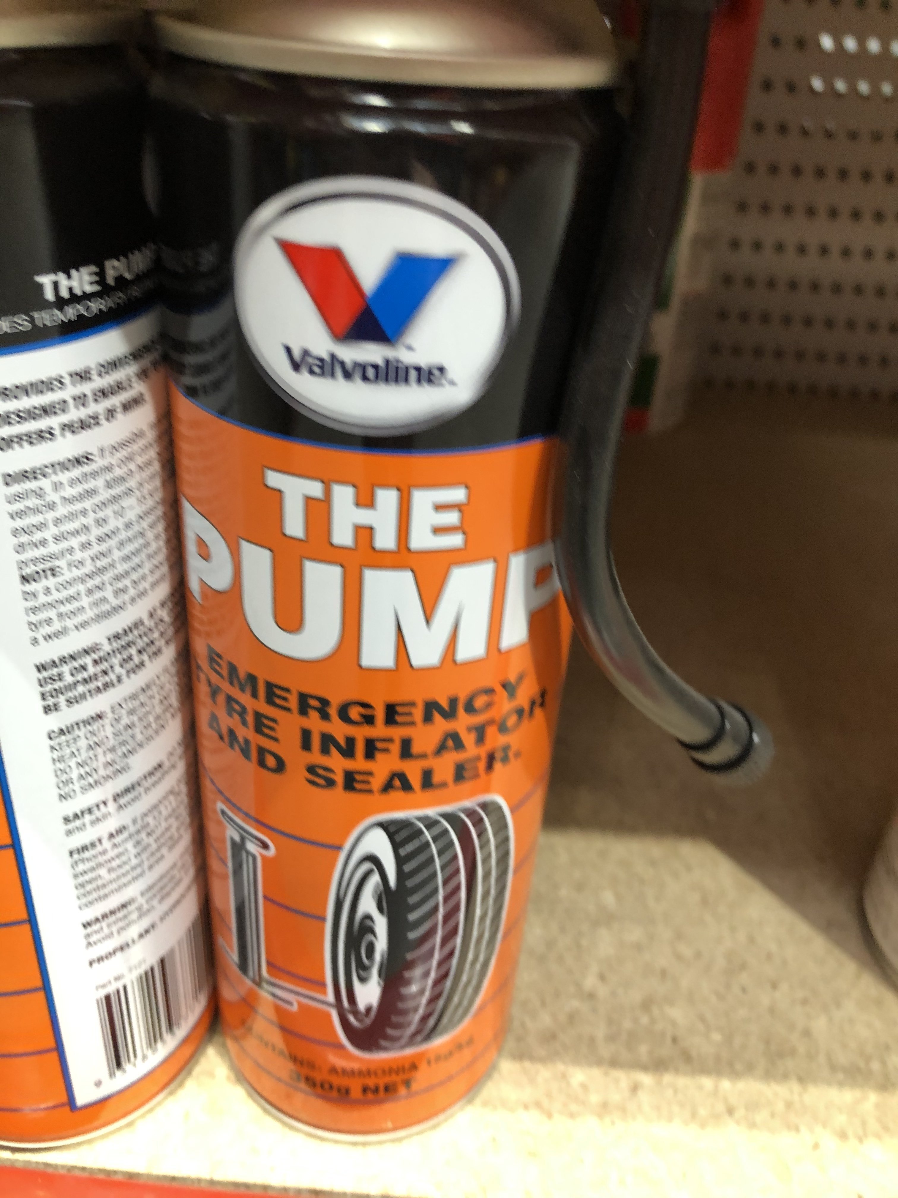

  15. Jadorff
    Jadorff Noble Member
    Apr 14, 2019
    879
    Adelaide Australia
    This is the can
