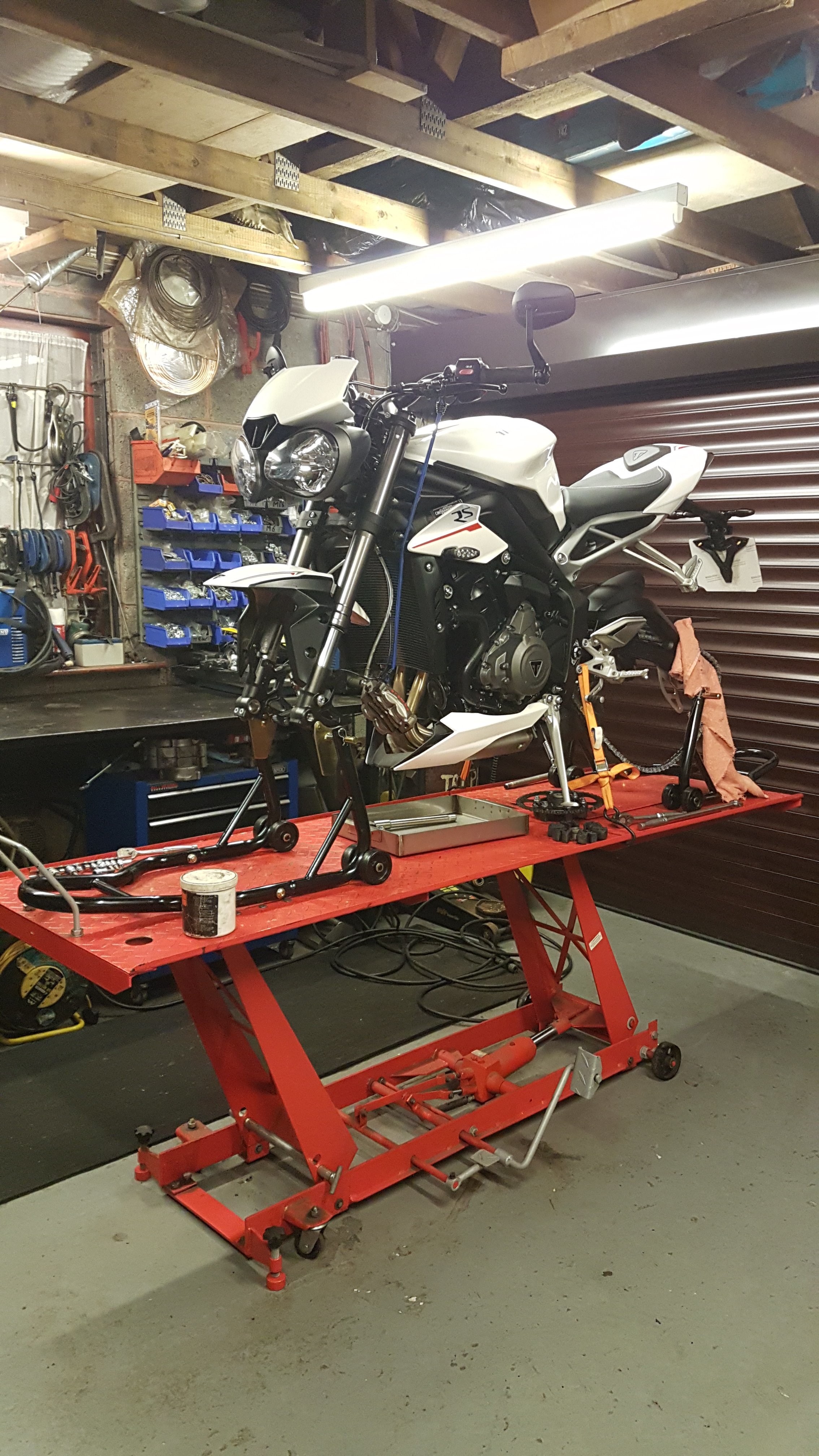

    Here is my 500 mile old 765 undergoing scrutiny lol
