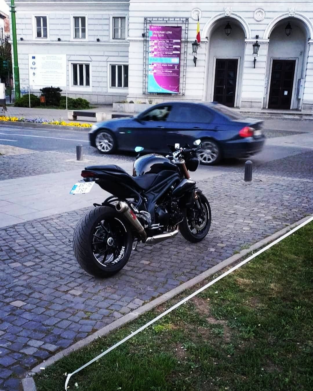

    I'm going to post a pic of the bike maybe someone can tell me what's wrong with it and how to fix it just by looking at the photo.
    Thanks

    Nice bike ! Sorry, no idea re how to fix it from the pictures ;)

    You bike should have a specific map for a low boy, two into one exhaust system.
    I don’t think a change of air filter will make much difference
