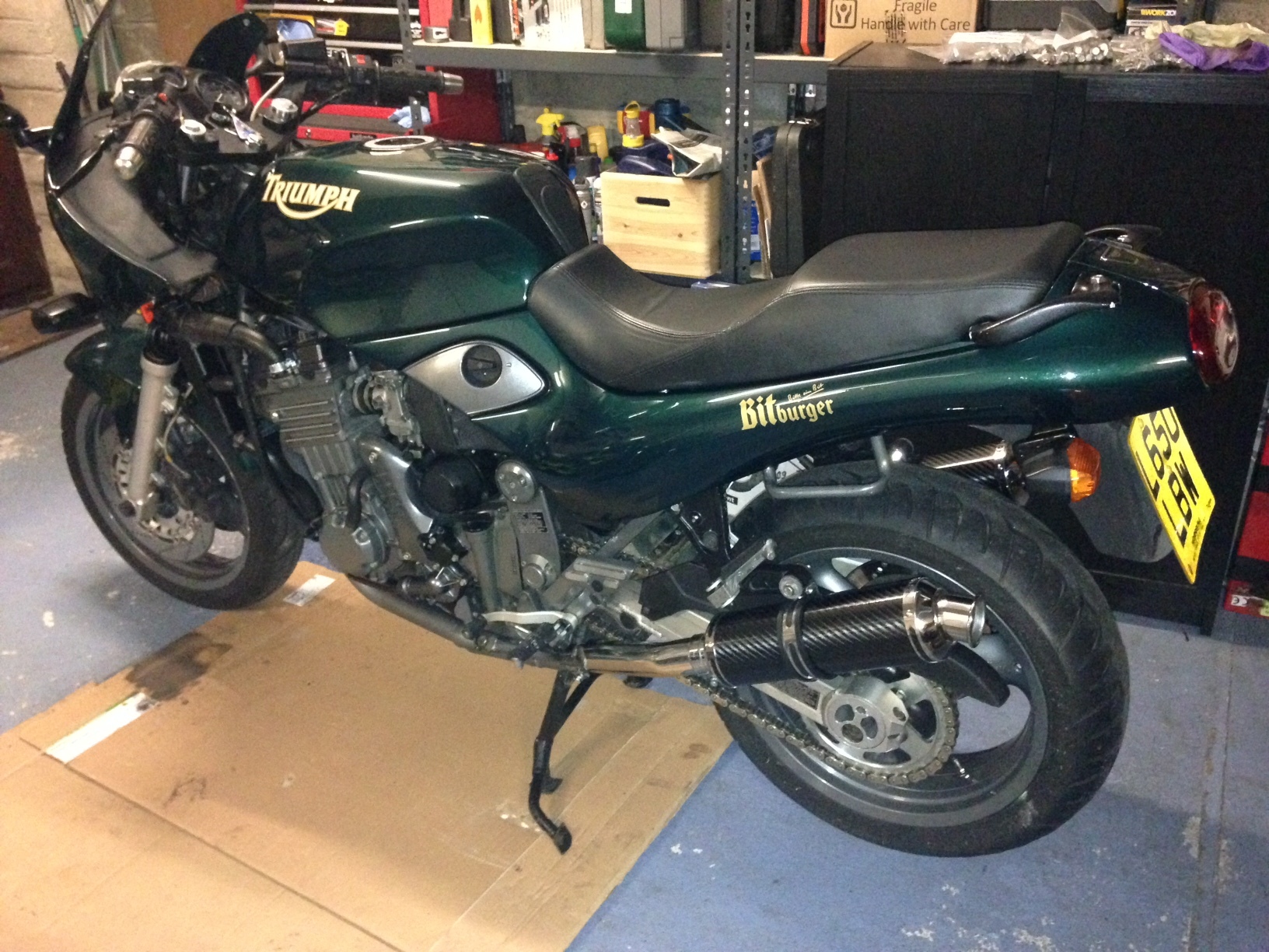

  9. cavsp3
    cavsp3 Member
    Dec 29, 2017
    39
    Highlands
    Here's where I'm at right now. Not too much done, just fairing sides removed, oil cooler has gone, later side panels and back light, Daytona exhaust hangers/pillion brackets, pillion grab handles and SP Engineering silencers. I have painted the exhaust headers in metallic graphite VHT paint, cleaned callipers and fitted EBC HH pads. Oil and filter change and general good tidy up and got her on the road.
    She is just what I expected, heavy old beast when slow manoeuvring but handles well enough, just got to push her into bends and pulls like a train.
    Lots more to be done yet but just wanted to get her out on the road for summer months and get some use. The headlamp fairing won't be to everybody's taste (not sure it's to mine really) but the front end is for next winter.
