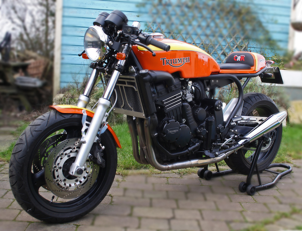

    I therefore began searching the web and found Cafe Racer Kits and their offering for the 900 triumph. Whilst its not a twin shock like some cafes its still a nice looking thing. I would want to add a little bikini fairing as I like that look but otherwise all is good.
    This is a terrible paint version of the intended end product

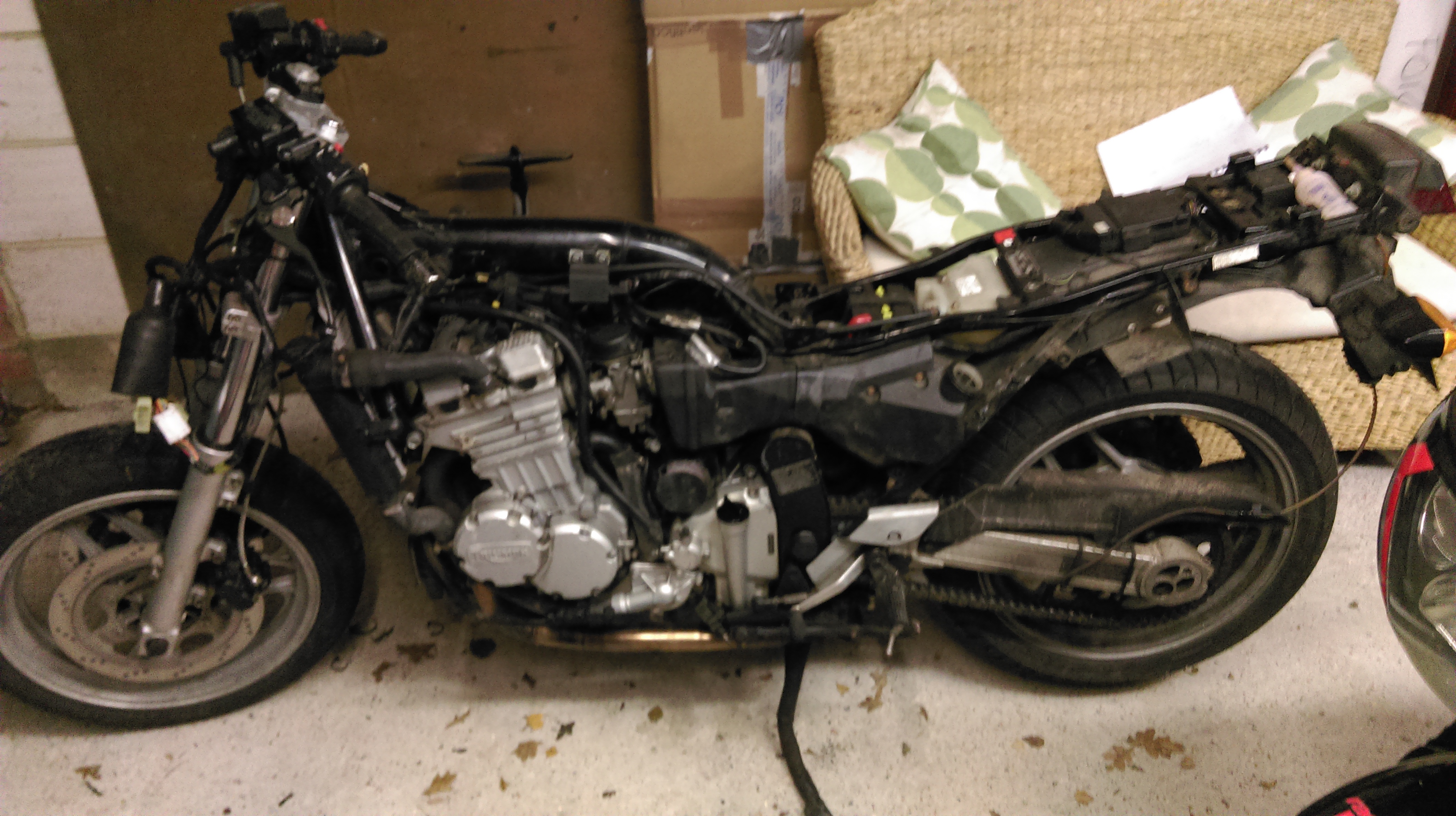

    I found on gumtree a nice looking Trophy 900. 30k on the clock, a few little scrapes but recently serviced and MOT'd, new tyres, a new dual Quill exhaust and freshly reconditioned brakes. A good base!
    I never took a picture of it but it basically the same as this stock image. trophy.jpg
    I got my instructions and a haynes manual from Cafe Racers and set about stripping the bike down.
    First job fairings and tank off
    All fine so far - Discovered the bike had a scottoiler that I hadnt spotted previously - If anyone wants one let me know!
    Next up remove the airbox, carbs all the electrics and plastics at the back
    And then the scary part - Cut off the subframe!!
    From here it would be possible to build up with the Kit parts however these havnt arrived and other parts of the bike look a little shabbier than I want them to on a bike that essentially needs to look nice!
    Therefore, wheels off - they both need blasting and powder coating
    engine covers off - they need the same treatment and I drained the oil whilst I was at it (spilling some!!)
    Exhaust off - Ill get onto that with some autosol - managed to remove 5 out of the 6 studs and only snapped one! - I have lots of the stud sticking out so hopefully a blow torch some mole grips and lots of cursing will get that out!
    Radiator off
    looks a bit sorry for itself now!!

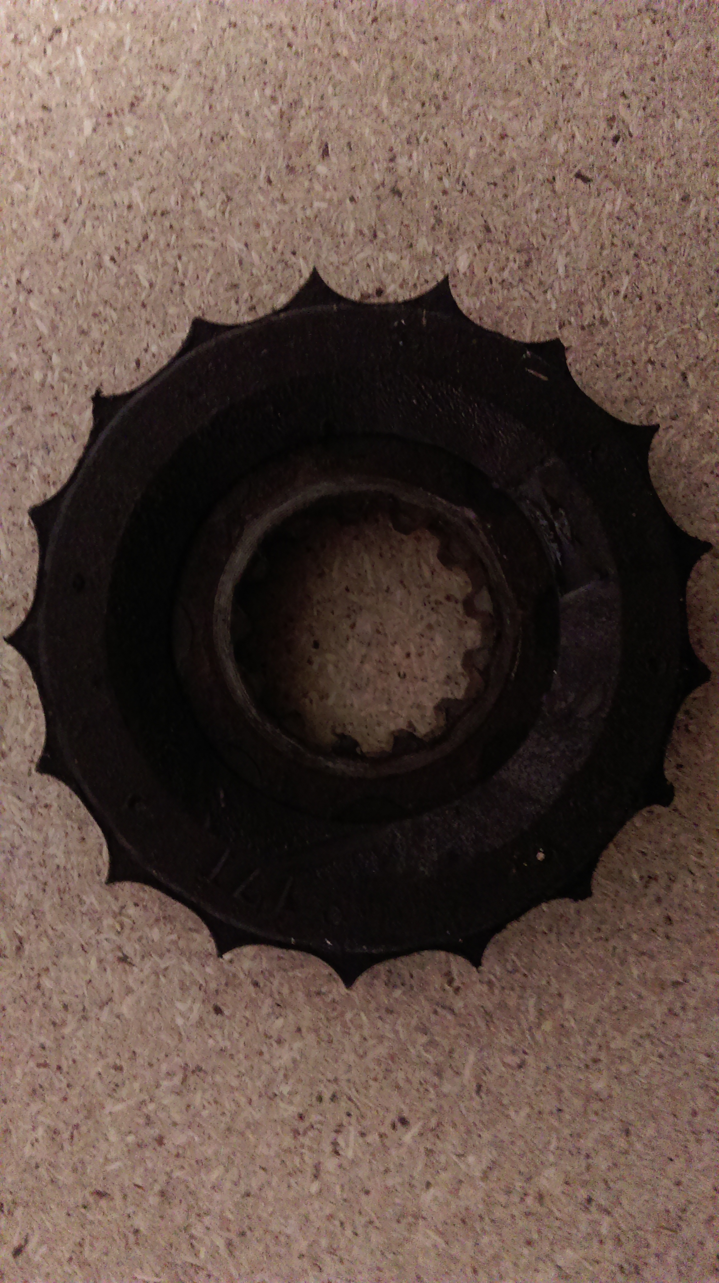

    Sprockets were in bad shape so off with those. Gold chain and new sprockets to follow. The front sprocket really had seen better days!

    So this weekend I had another morning playing with project.
    I managed to remove the snapped and rusted exhaust stud without damaging anything else. Whilst I was down there close up the front of the engine has flaking paint work. Whilst I know it will be hidden behind pipes and rad it bothers me so might have the engine out of the frame and get that sorted (yep project grows ever larger!)
    Then finally got the swinging arm out. Just needed to be brave and use a larger hammer!
    The swingarm doesnt look too nice but will take everything apart and get it coated and looking right! Im also fairly set on buying a new shock now. A Hagon unit looks like the way forward. however I have seen a few cheap shocks from things like the 675. Does anyone know if they will fit without too much messing? A clean used one seems to be less that 100 quid which is a bargain! If im doing the rear from Hagon I might do full hog and strip the front forks and put in progressive springs (yes project budget is creaping up! its only money right!)
    I then removed the loom to get it out of the way!
    I also stripped the wheels of their bearings. Will get a local place to remove the tyres and then these can be blasted and painted.
    finally gave the Headers a quick degrease - might wrap them - not sure yet! I believe they are titanium and they are in good shape if a little discoloured. Not sure yet - maybe paint them matt black to match the frame!
    Still lots to do especially if I do drop the engine out for a full clean up - But the kit arrives soon - just been emailed saying its ready - the temptation will be to rush to get something on the road but I must remain strong and make sure the end product gets the right treatment and is the stunner I'm aiming for!
