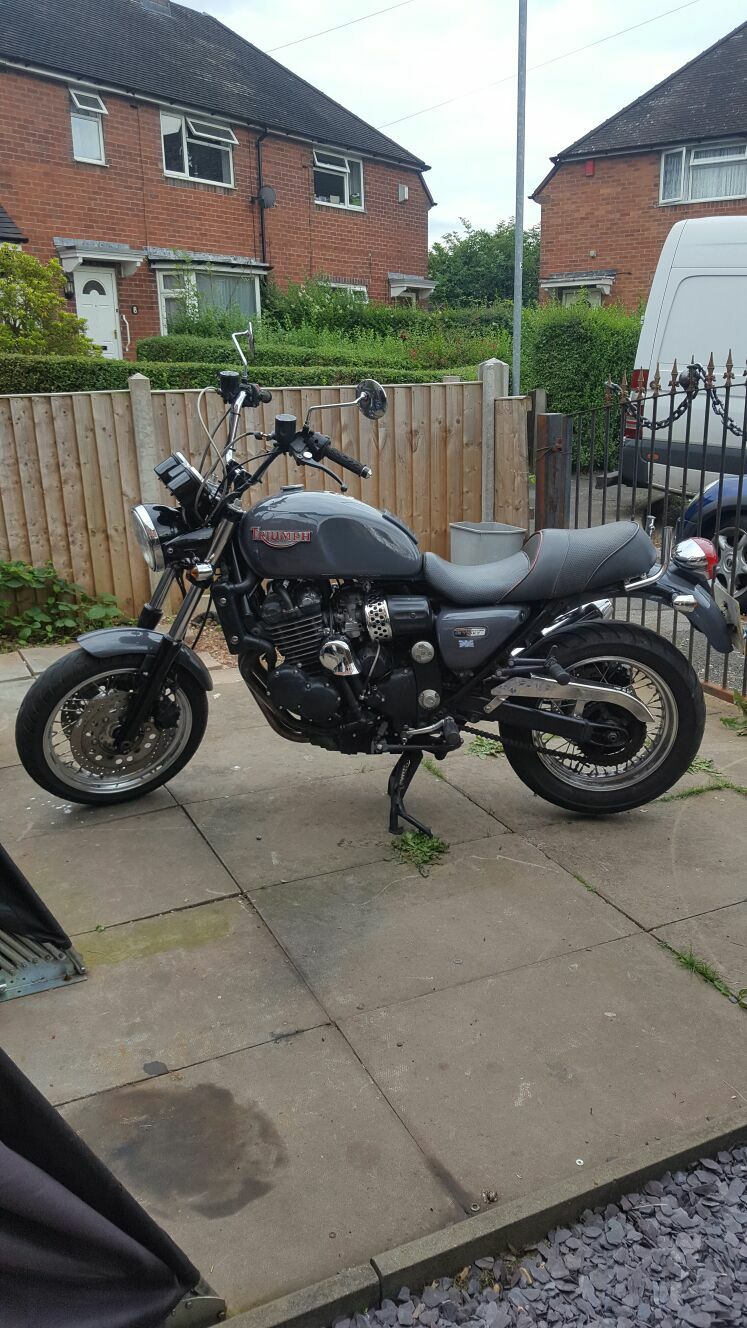

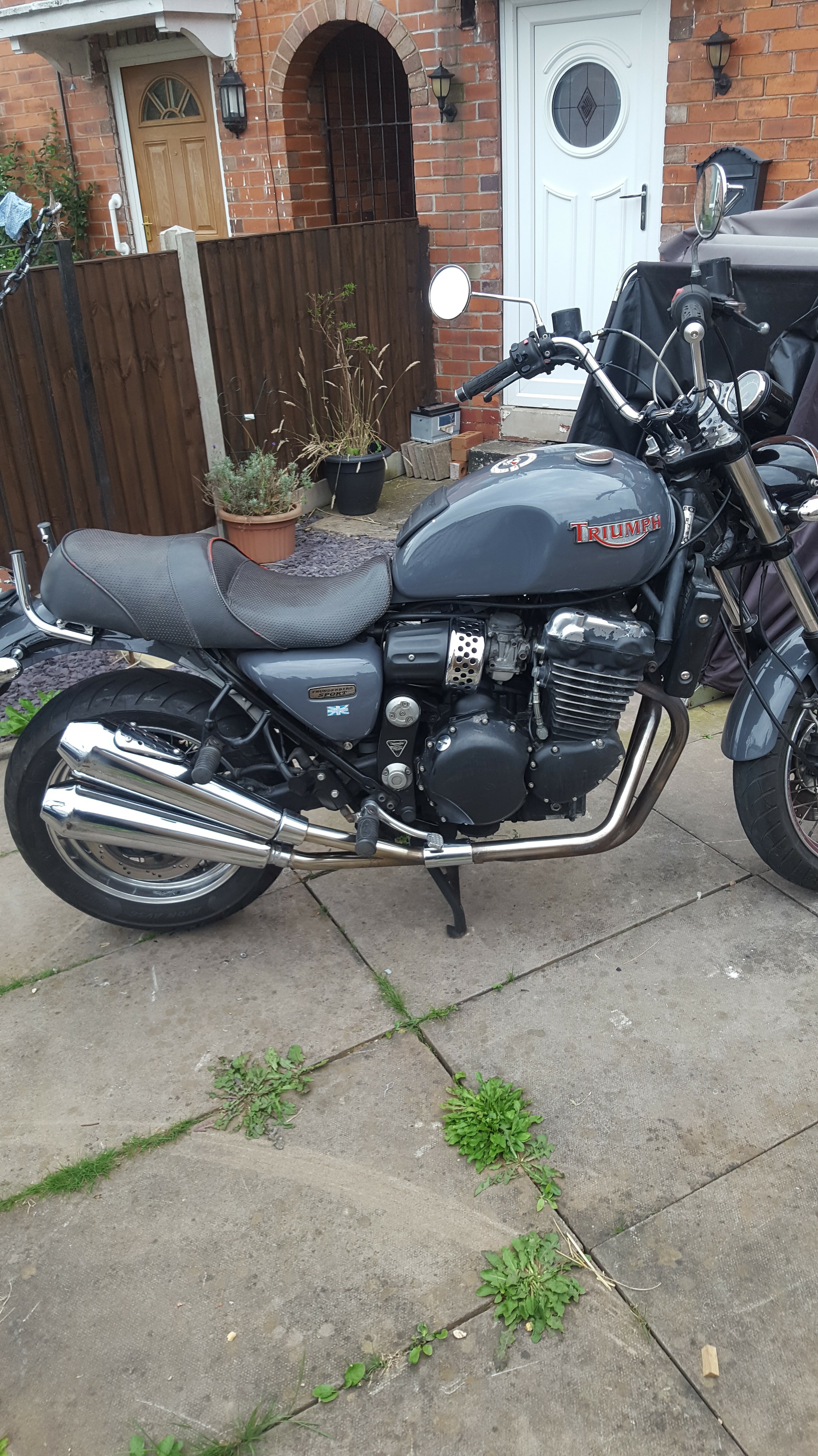

    Could we see some pictures of it?

  8. GypsySOHMC
    GypsySOHMC Member
    Mar 18, 2019
    Stoke on Trent
    It's had new tyres, chain sprockets, full service, new battery, carbs cleaned and balanced, new pick up coil, list is endless since these pictures. Unfortunately it owes me over 2.5 grand and the only way to get it back is to break it.
    Triumph trained mechanic has had it for last two days and cannot find any reason why it should not start.
