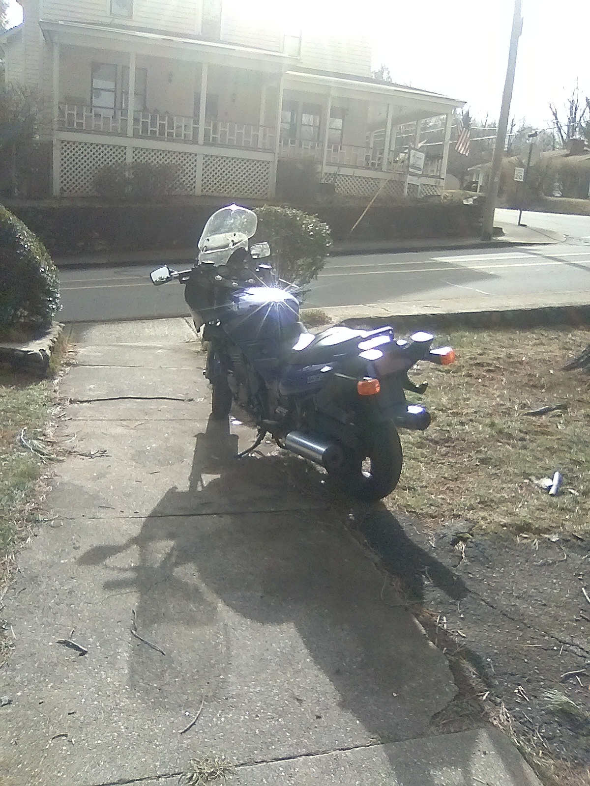

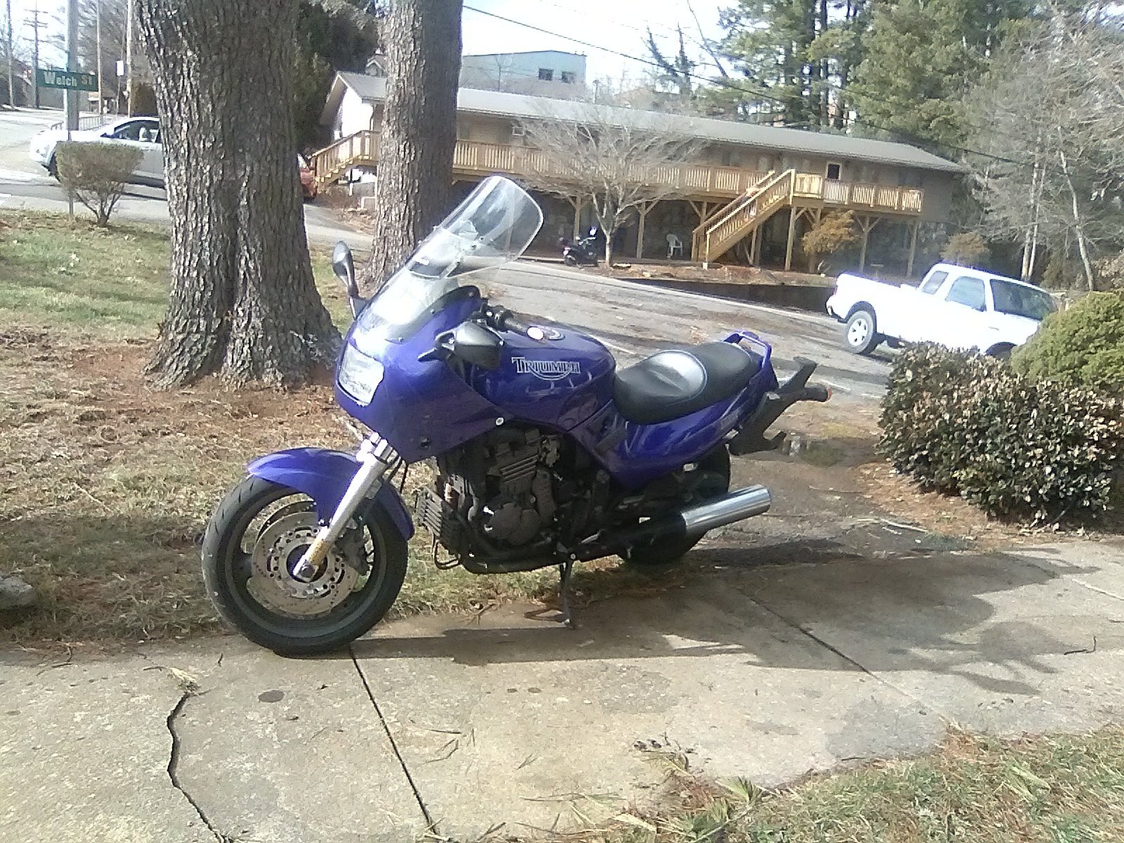

    I will try some carb cleaner, and report back. The tank was full when I bought it which doubled the value... My plan is to drive the old gas out. Yesterday I got it started with a bunch of starter fluid and then took it out for a fun ride. I will definitely post pics, but it will be a few days. This morning I pulled a back muscle, and any trip off the couch requires crawling.
    Bored to tears laying on the couch so I did hobble out for a couple bad pics.
