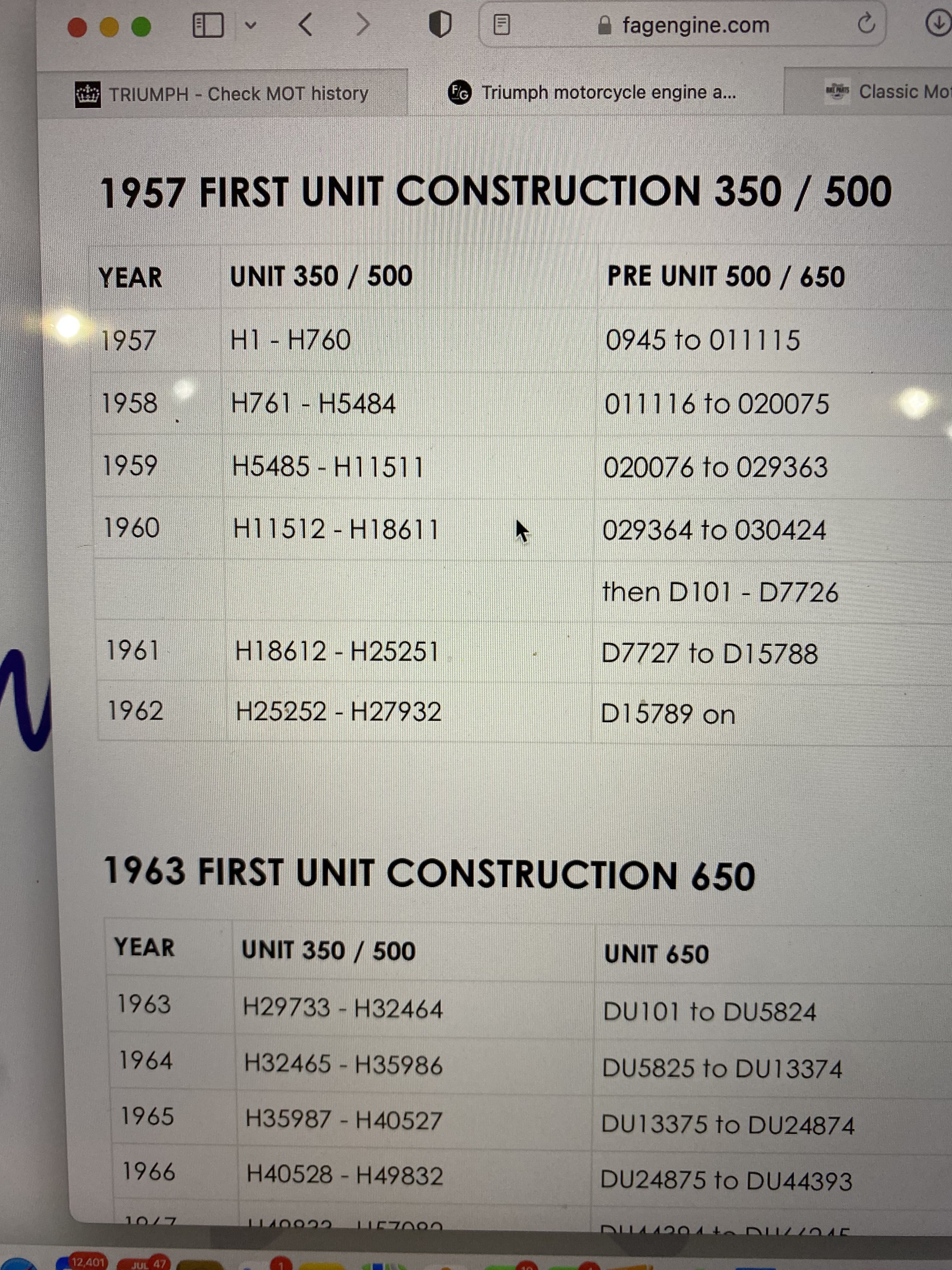

    2,753
    943
    Bob Ross Studios

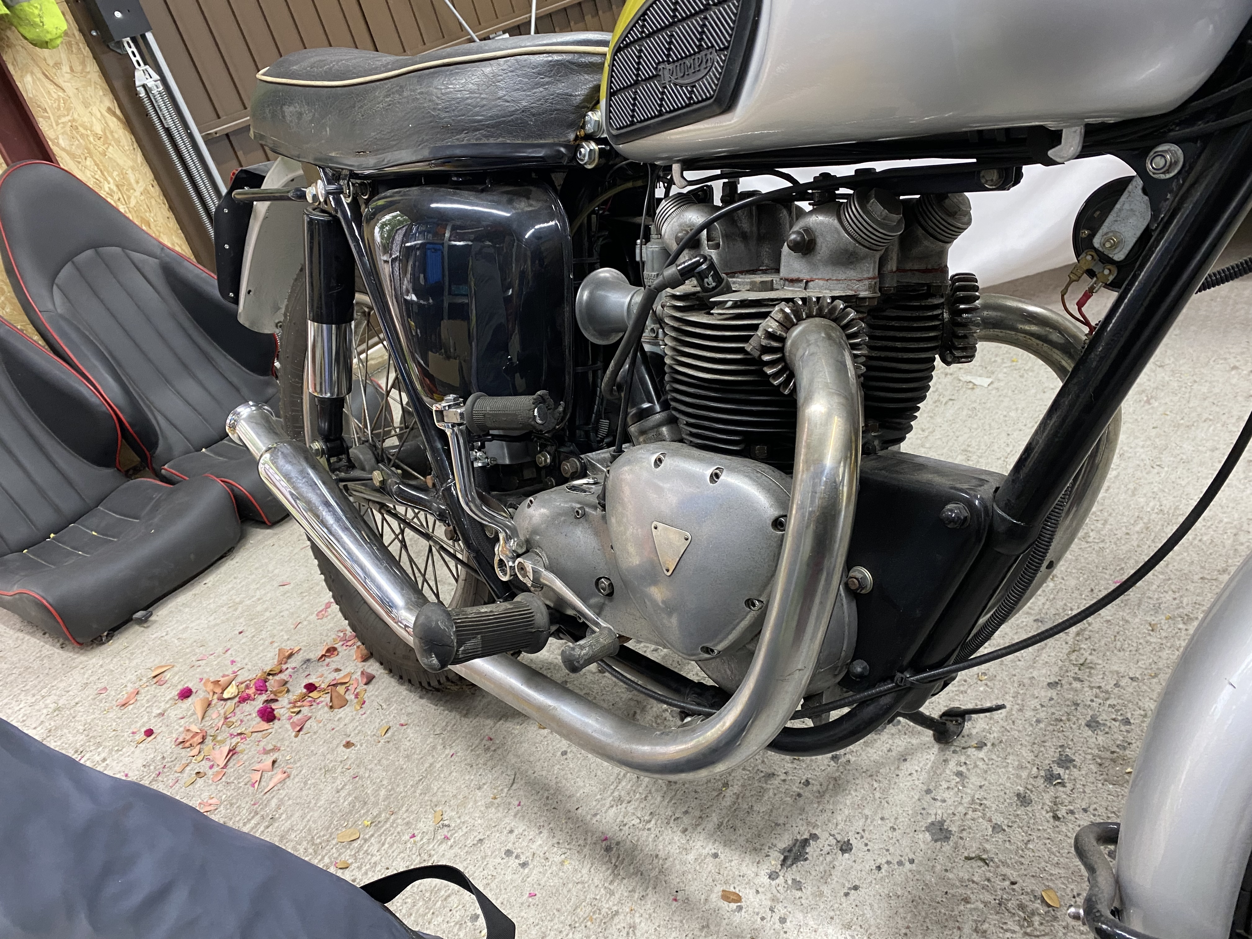

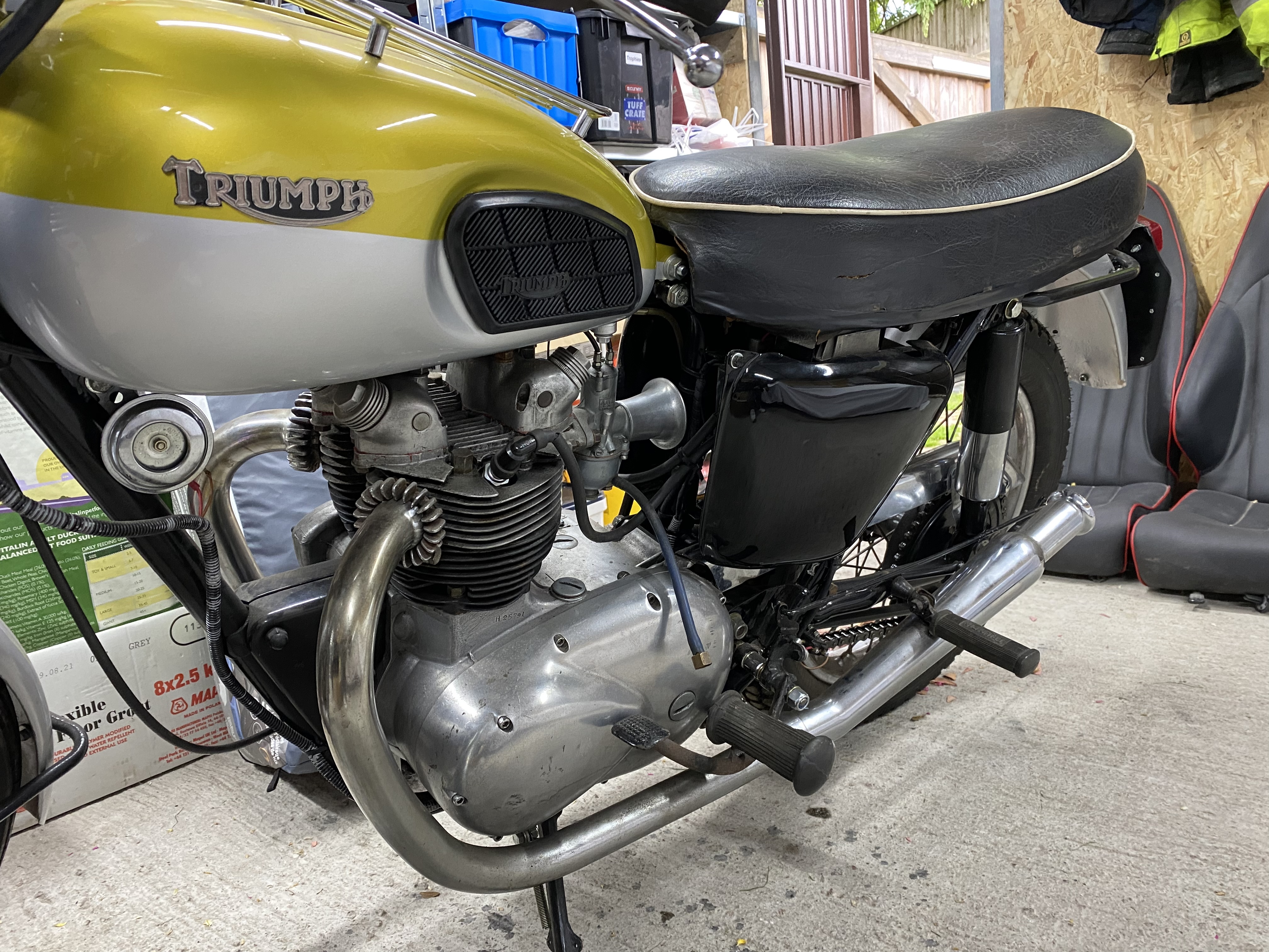

    Here a few pic’s

    Hi and welcome. Bike looks to be in reasonable condition mate. Does it start and run?

    No the bike does not run it leaks a lot of oil. Will require a rebuild.

    Yes, the silencers, carb and rocker box caps immediately jump out. Have you identified where the oil is leaking from?
    One upgrade I would definitely recommend is to fit a TLS front brake. It will fit in the original front wheel and I suspect be a 7 inch not an 8 inch unit.

    Congratulations. Your bike looks better than what many start with. I've spent my share of time comparing the parts books with my machine and understand your frustration. As stated, there's a lot of good help to be found here.

    Hi Steve, congratulations on a very practical project, and you have a great starting point. The bike looks in excellent condition generally. Although the over-generous application of gasket sealer on the rocker box hints that this part of the bike has been dismantled before, and by a hamfisted amateur (like me).
    The engine is a unit construction, so this is not a 1962 Triumph Tiger. All Triumph engines were unit construction from 1963 on. The engine still has the (fairly useless) gear indicator, which was dropped around this time. Maybe another reader can date that more precisely.
    Your first step is to locate the source of the oil leak(s) - there are only a few places where it can leak from: the clutch side of the crankcase, the gearbox oil seal, the oil tank itself, the pipe between the oil tank and the crankcase.
    Depending on where the leaks are, it may not be necessary to rebuild the engine at all!

    I’m a little bit confused when I checked the engine numbers and frame numbers which are matching compared to year of manufacture it was coming up as 1962.
    My engine l numbers are within the 1962 chart. any advice would be much appreciated.

    Looks like you have resolved the date question - although all triumph motorcycle engines were unit construction from 1963 on, it is clear that some of the smaller models went to unit construction as much as 6 years earlier - I did not think of that possibility.
    So your dating of 1962 is accurate.
