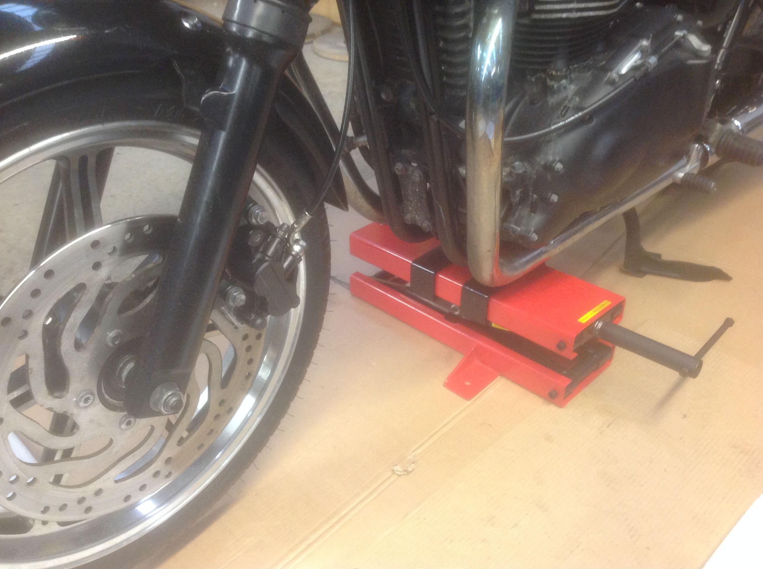

    Get one of these jacks Gary.
    £35 off fleabay
  5. GaryM

    Any particular make Mick?
    That's easier to use than my great big thing.
  6. MickEng
    MickEng Noble Member
    Sep 29, 2016
    1,805
    450
    West Yorkshire
    Hi Gary,
    I believe it was a company called 'go sourcing'
    They are probably all manufactured by the same company but imported by multiple UK distributors who advertise on fleabay.
    Mine is 500kg SWL £35 incl. delivery
    They are brilliant simple devices with nothing much that can go wrong.
    Folds flat for storage and feels really safe in use.

    Hmm missed that reply. Got one now or similar one by Constands. But thank you for the advice.
