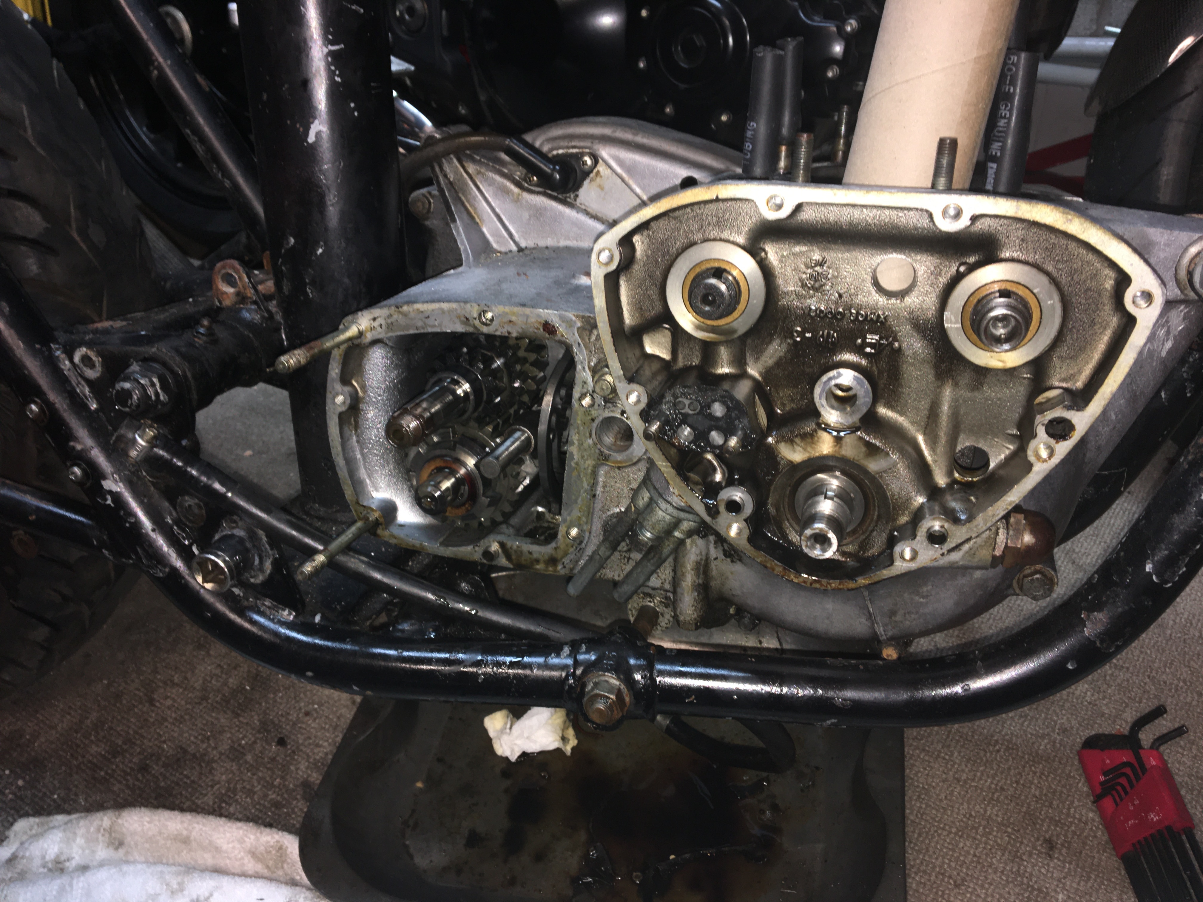

    Bit more done, great fun so far!
  3. Iron
    Iron Guest
    The clutch and basket came off ok then? Sometimes these are a real bugger. Progressing well...

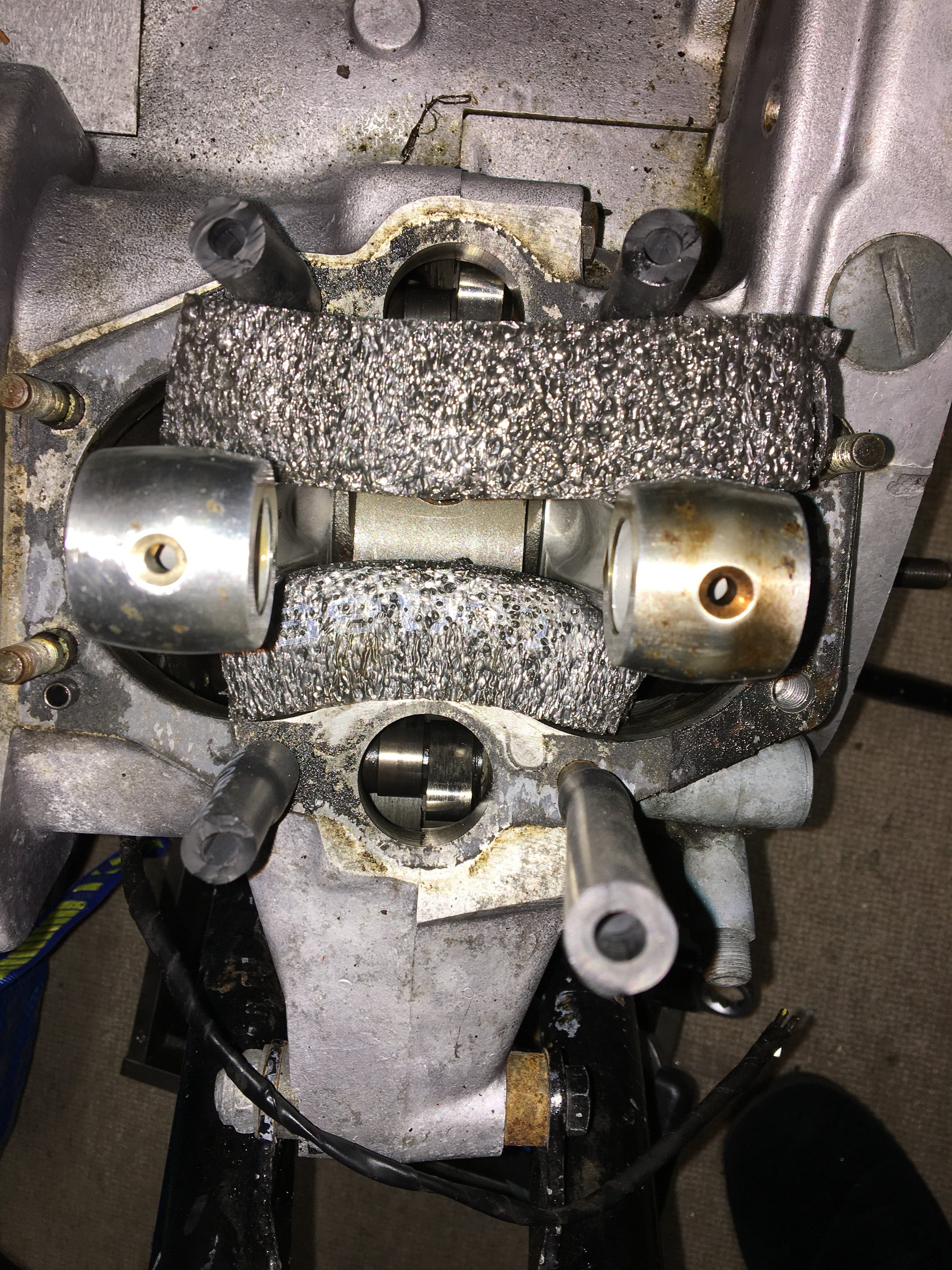

  4. darkman
    7,661
    Great work :) used toilet roll centers make good rod protectors and they squeeze down in the crank webs when splitting cases.

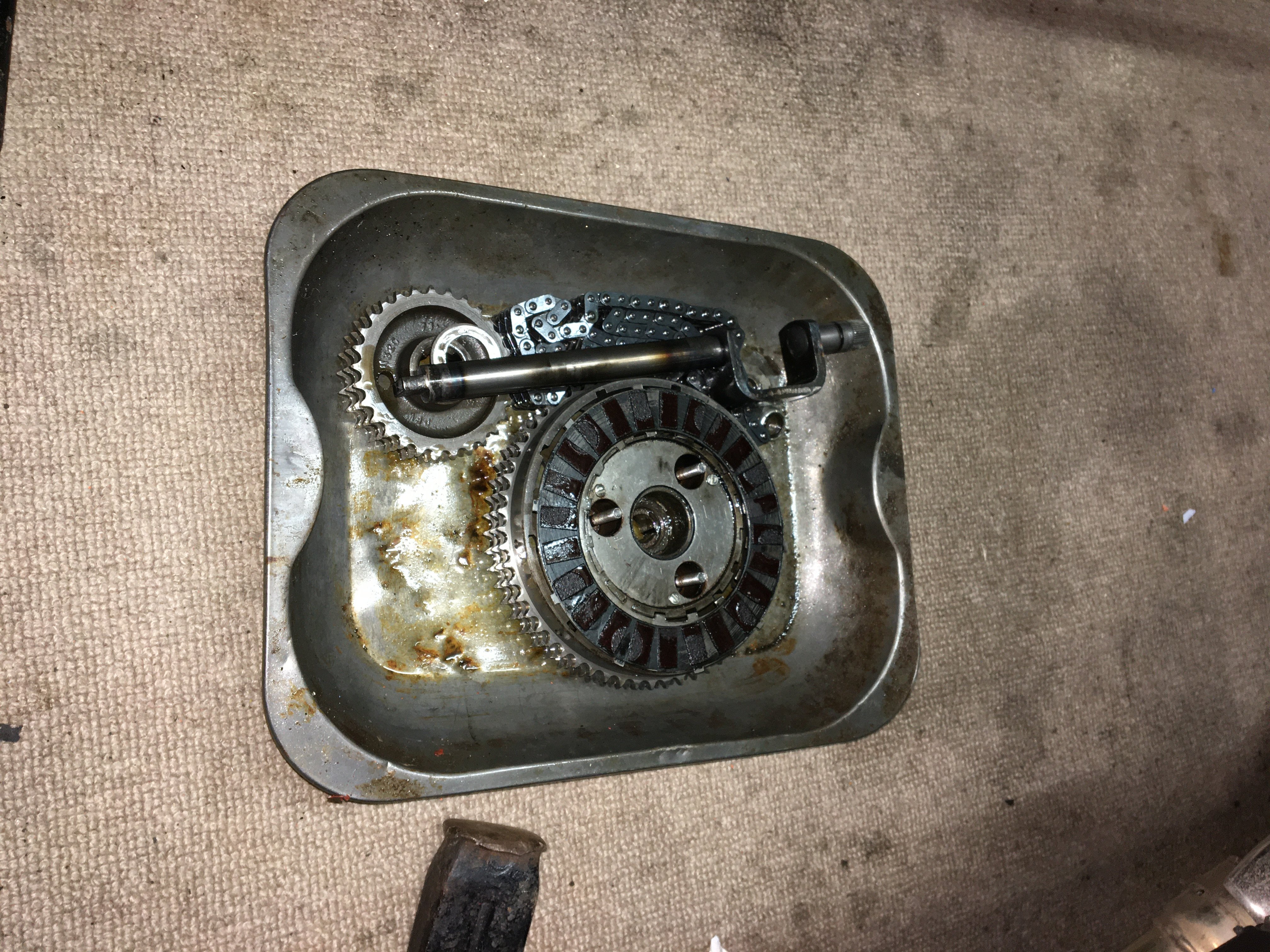

  5. RayV
    RayV Well-Known Member
    Apr 16, 2019
    140
    83
    NW England
    Yes I must have been lucky, I locked up the primary with a bit of wood and the nut came off ok. I used a puller I bought to get the clutch off and it worked a treat, so all good so far, very enjoyable. Probably never run again though!

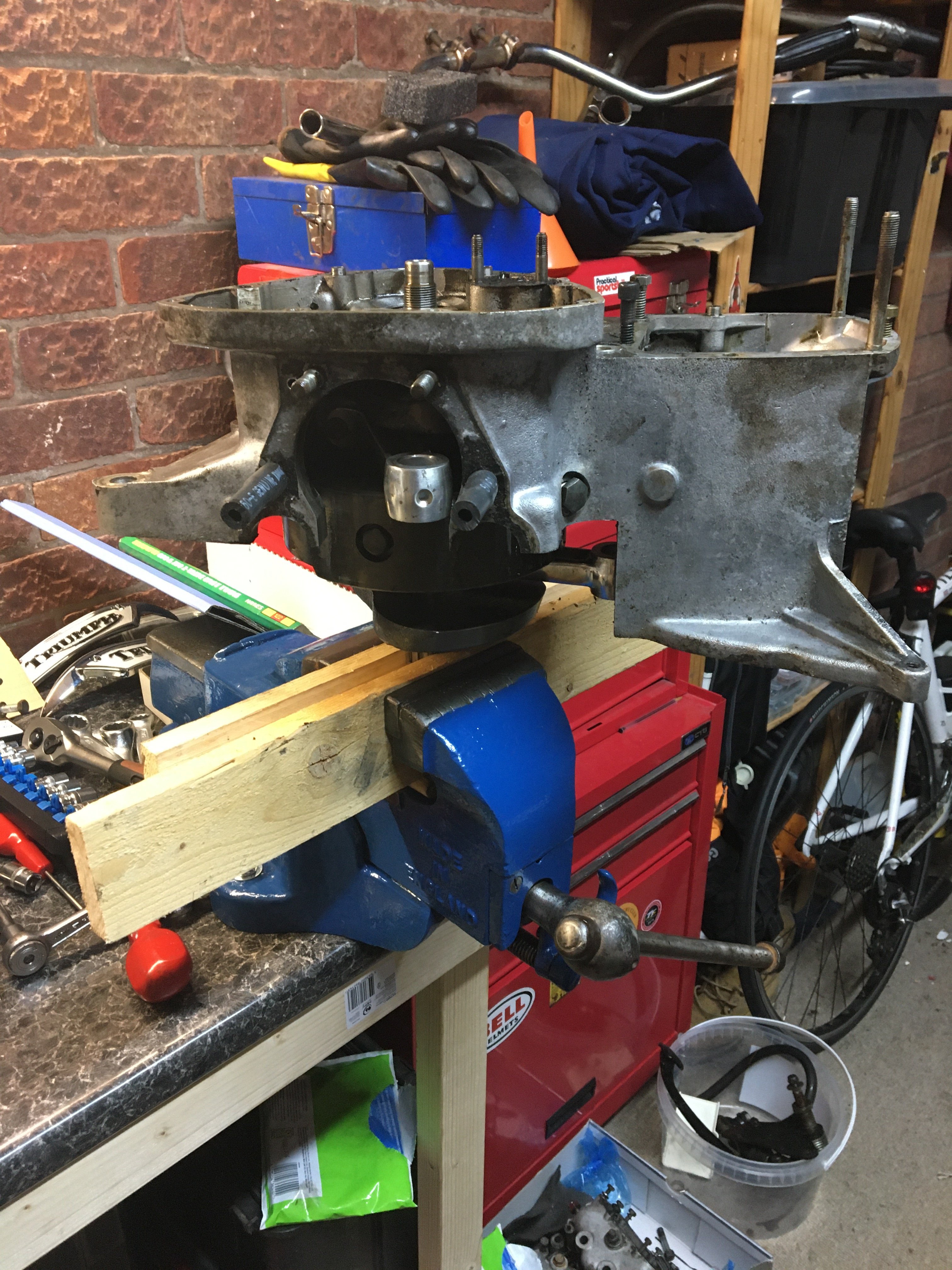

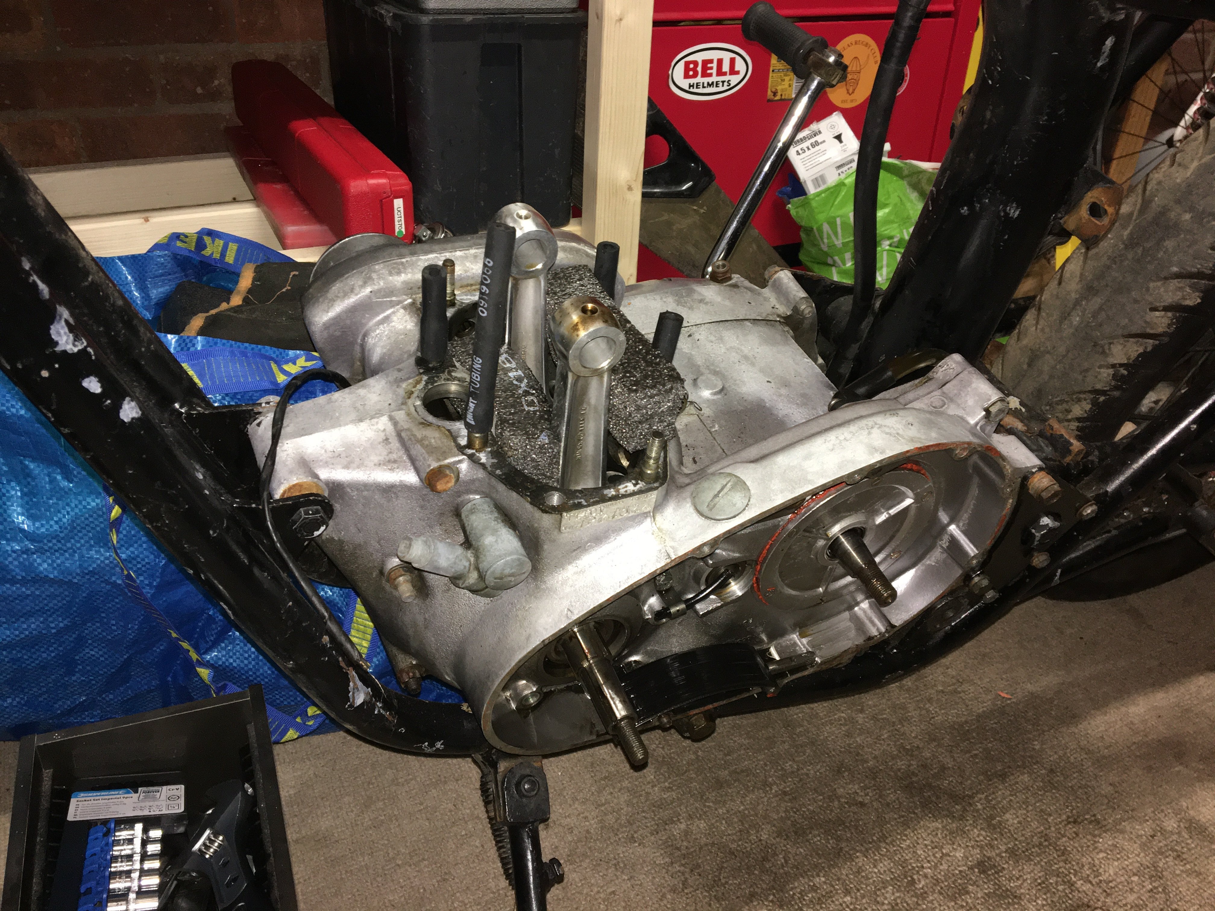

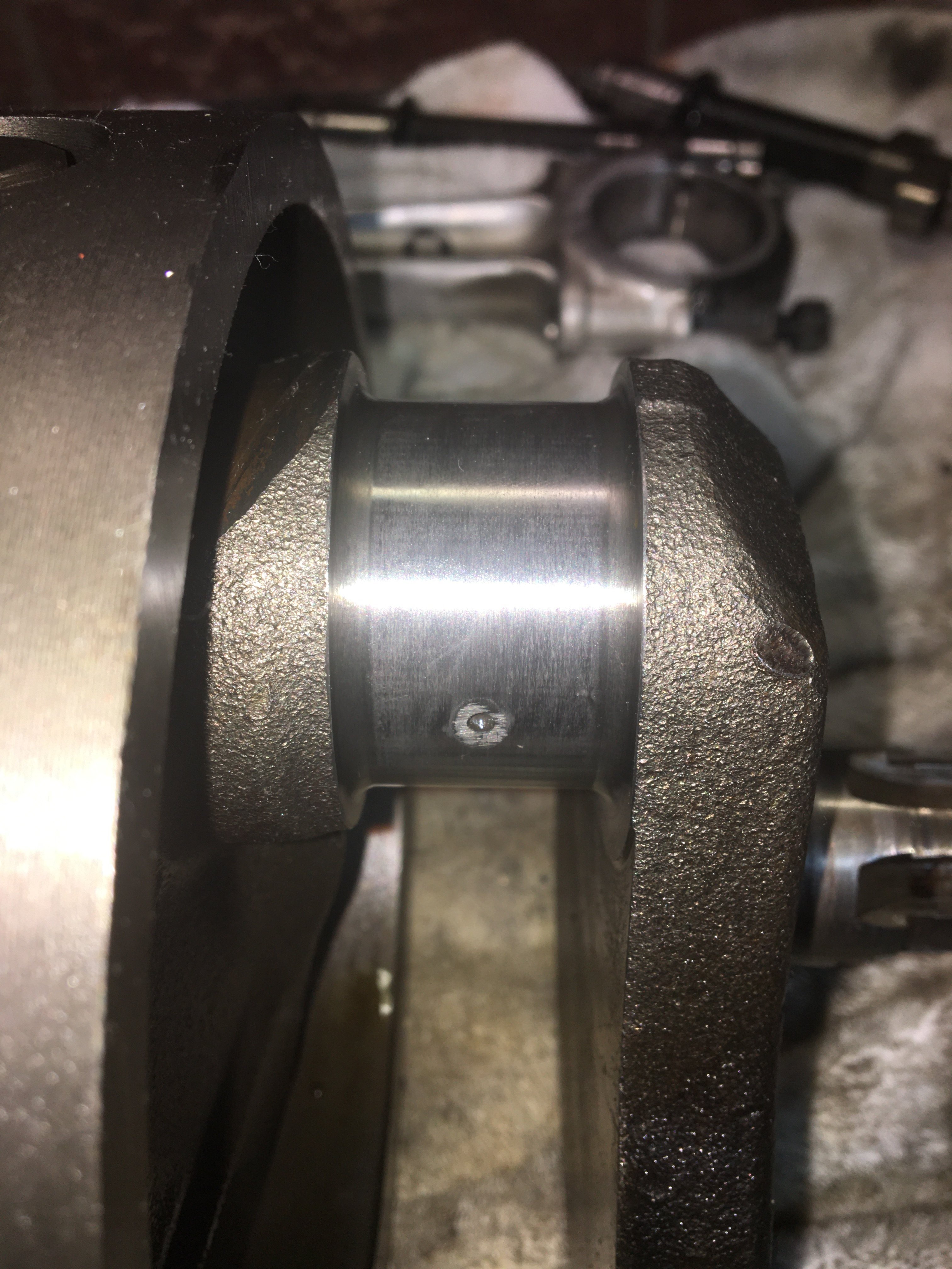

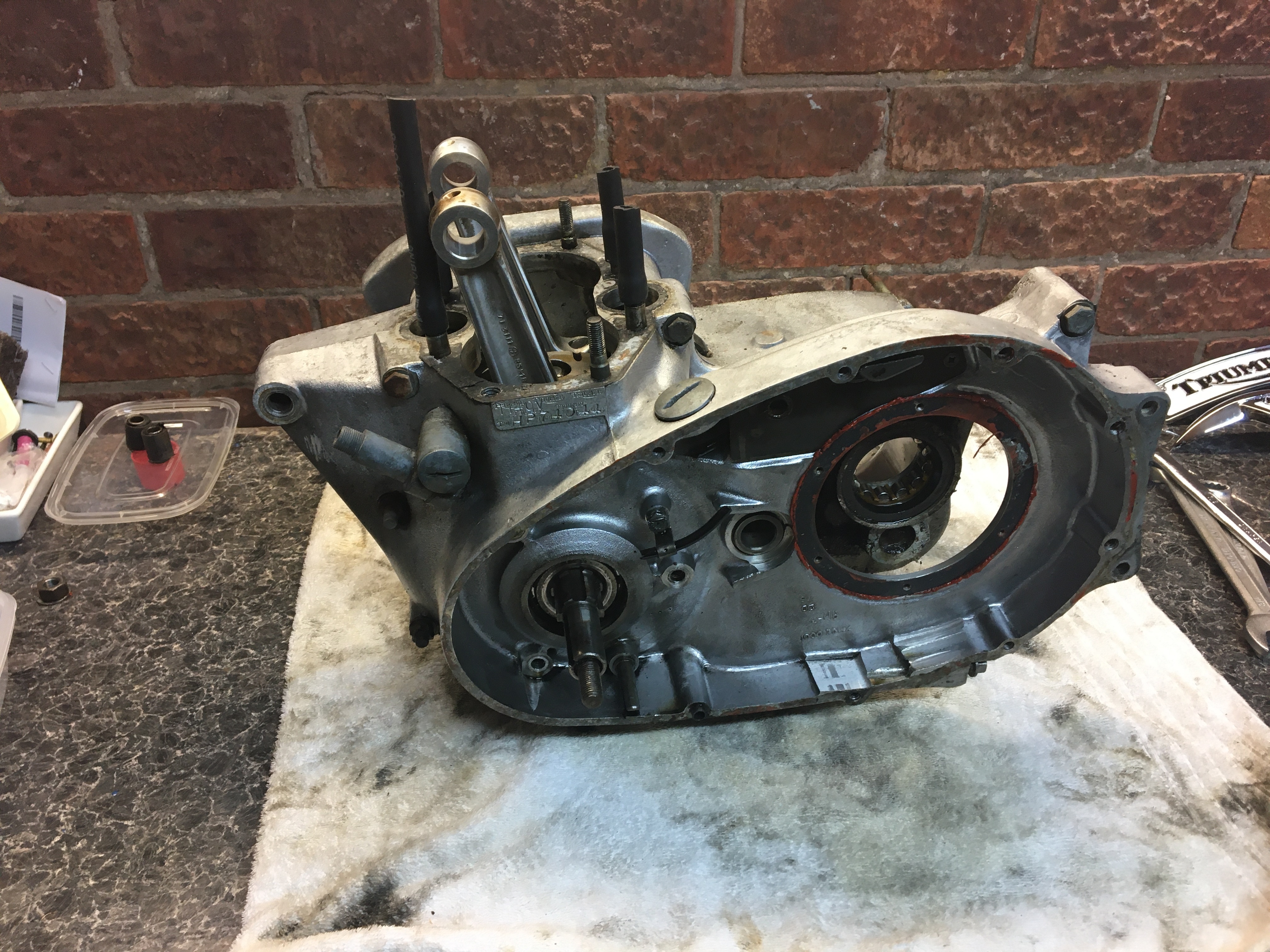

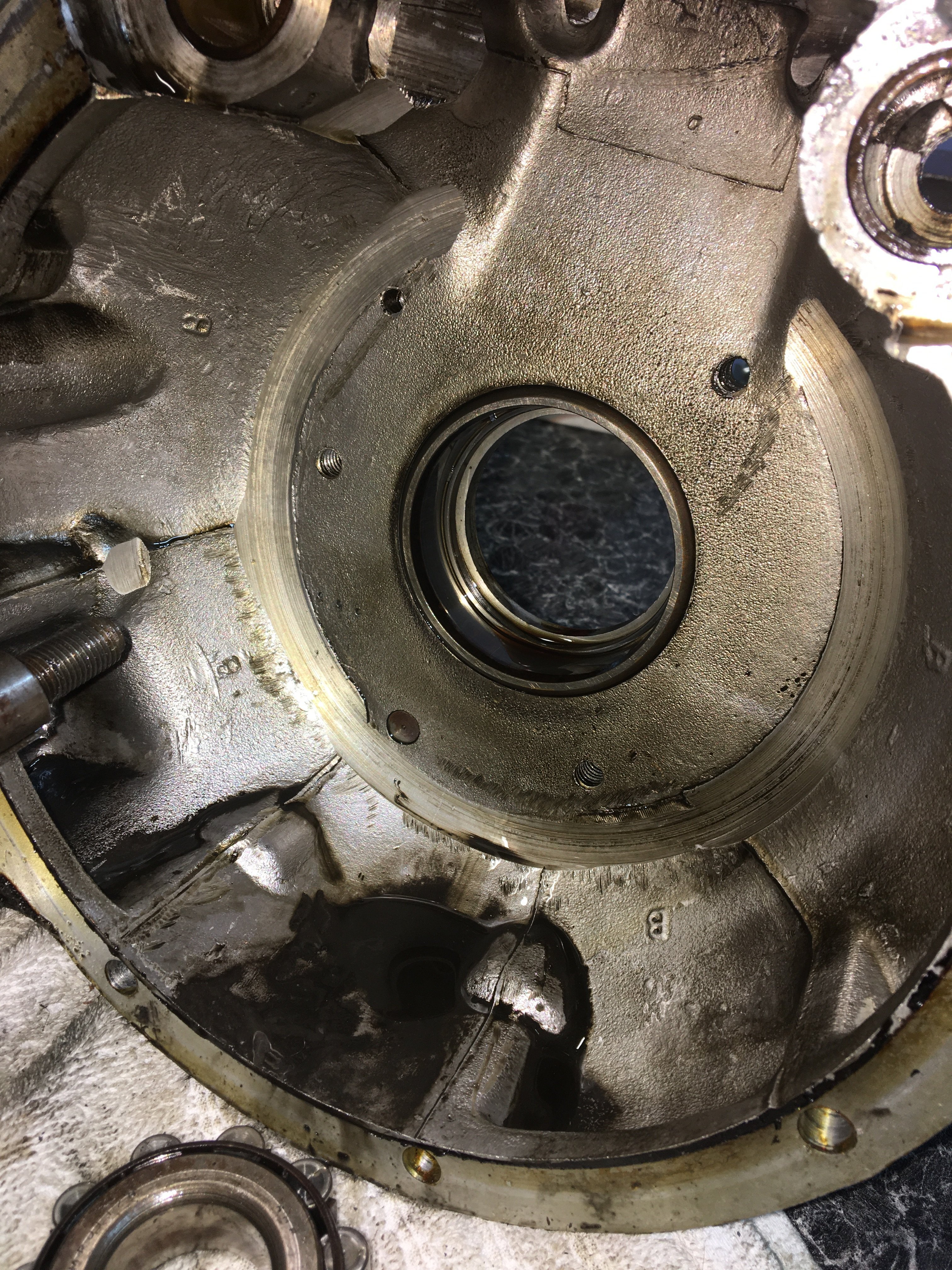

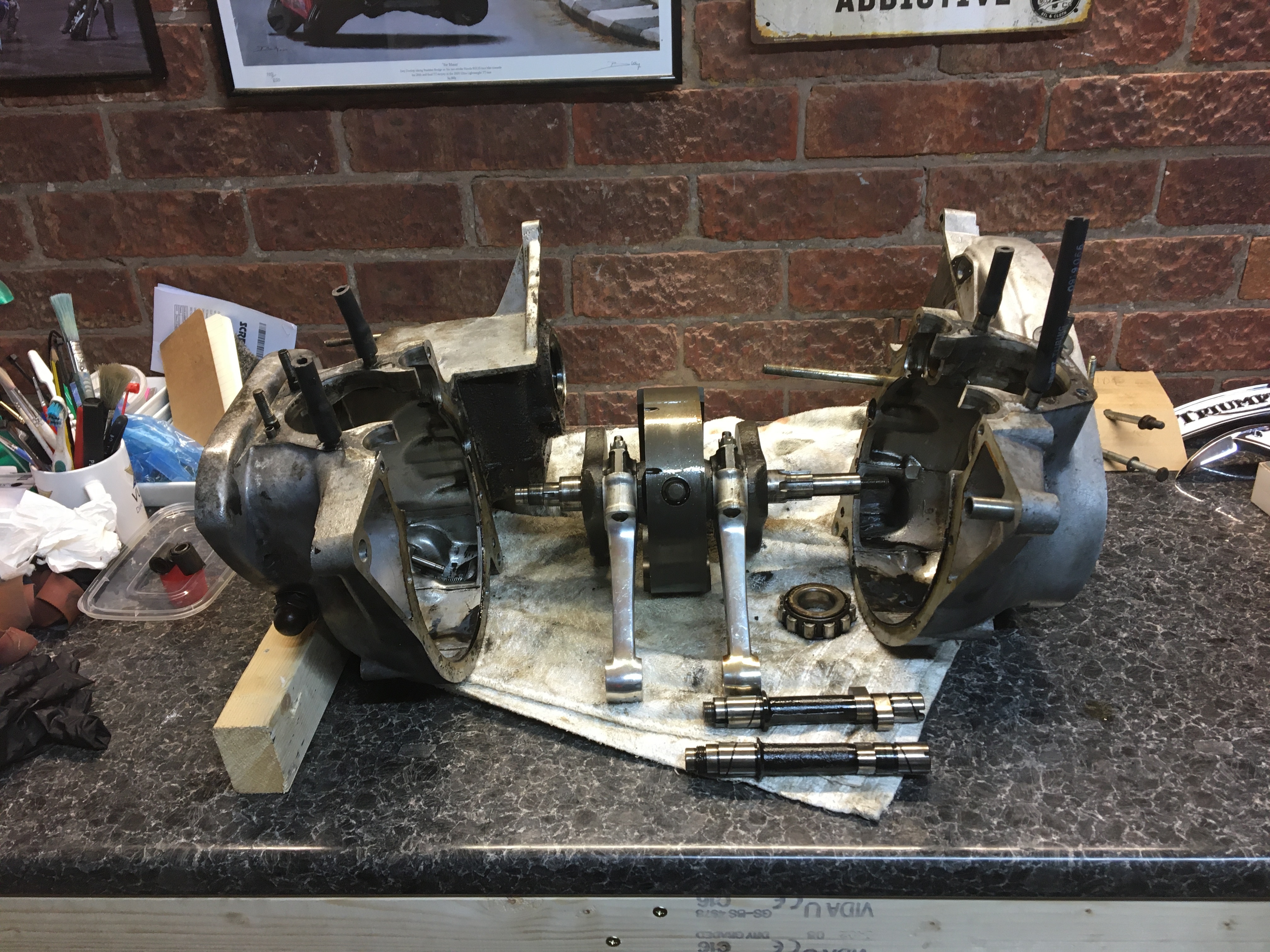

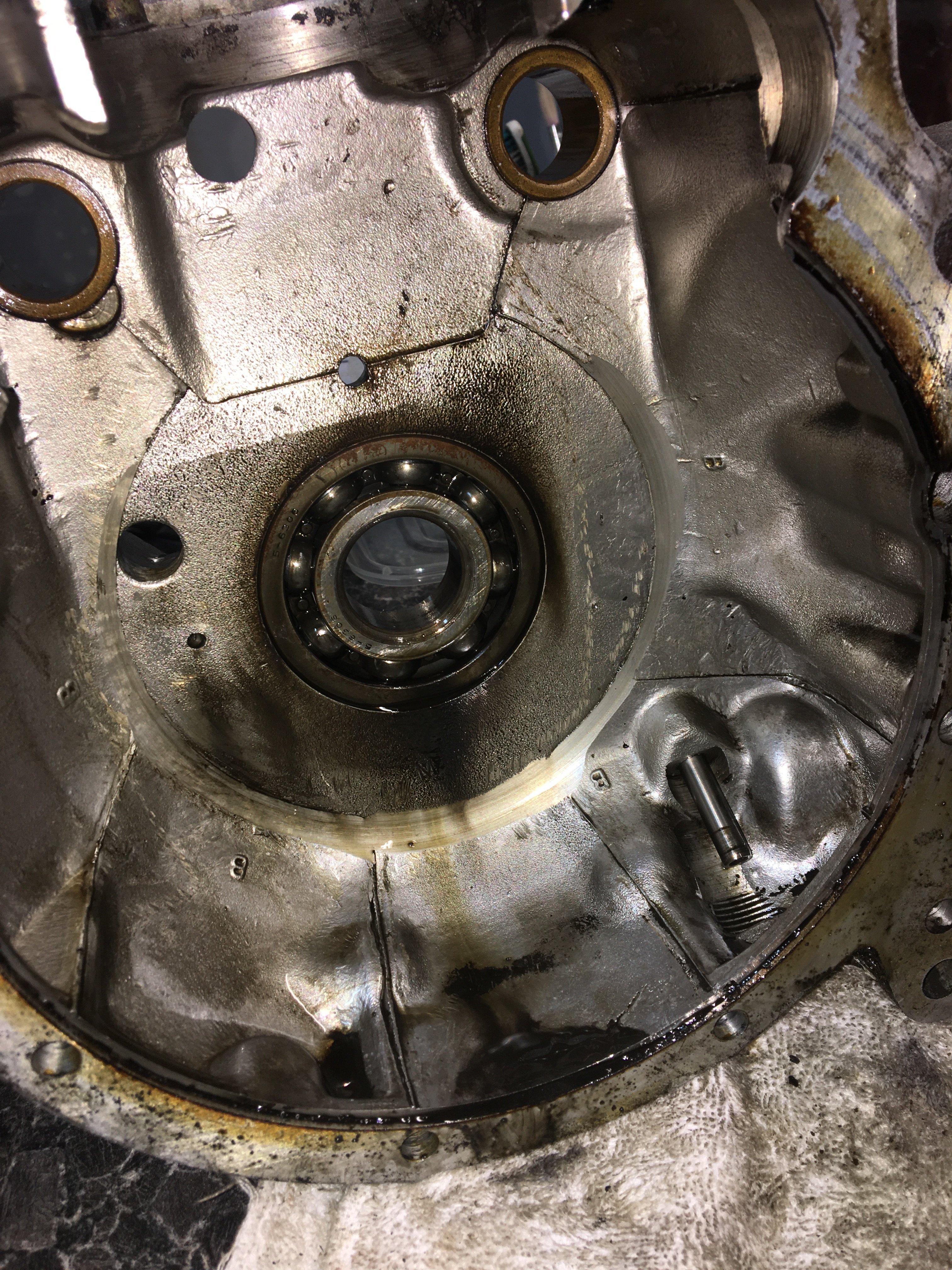

    Ok but of a delay but back to it today and now the cases are split. All good so far, just wondering if the marks around the main bearing positions is machined in the factory or a sign of the crank catching the cases? No sign of anything on the crank itself so any advice gratefully received. Cheers.
  8. darkman
    7,661
    Machine work on the cases is normal :)
  9. RayV
    Apr 16, 2019
    140
    83
    NW England
    Thanks, that’s a relief!

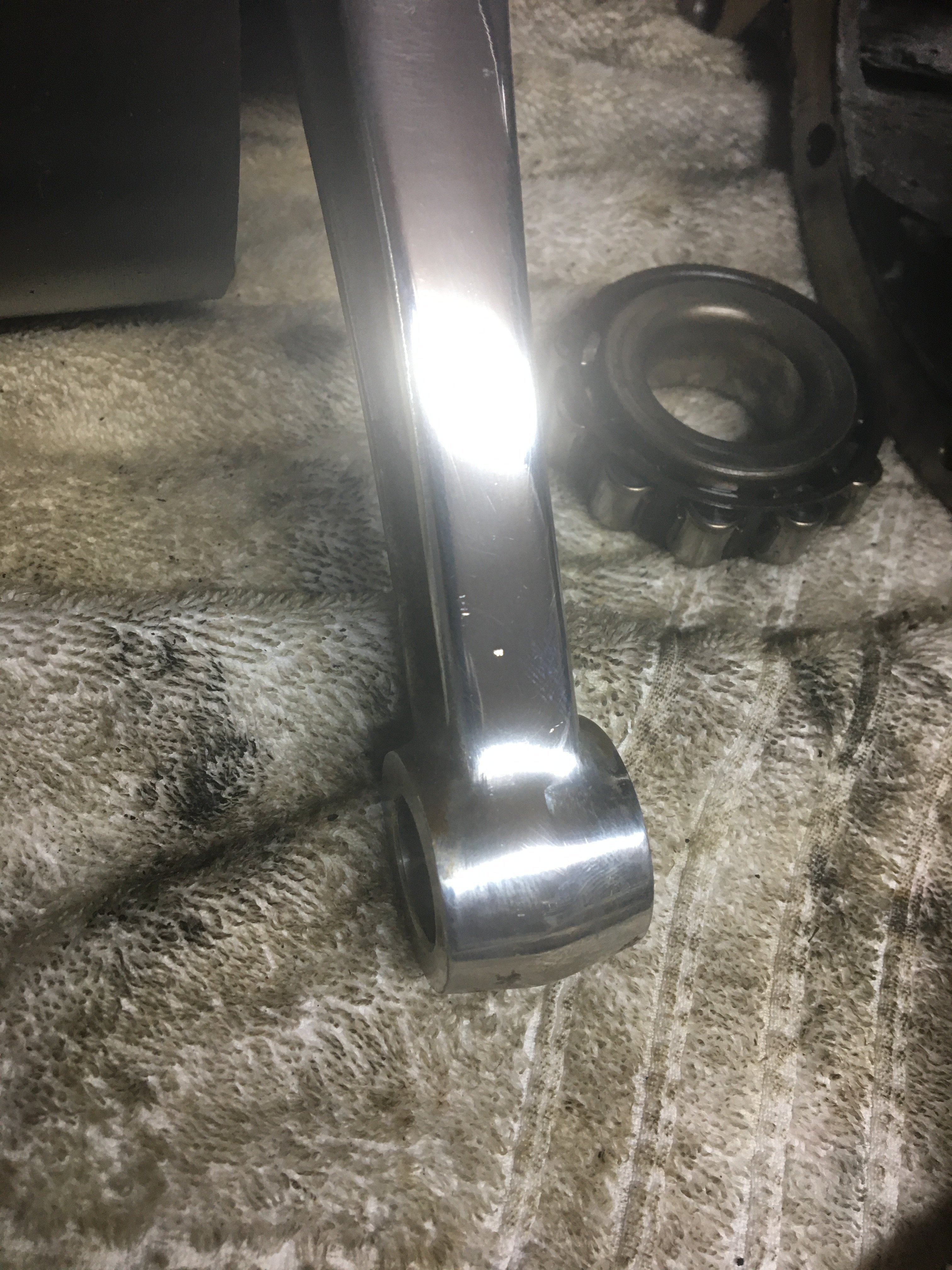

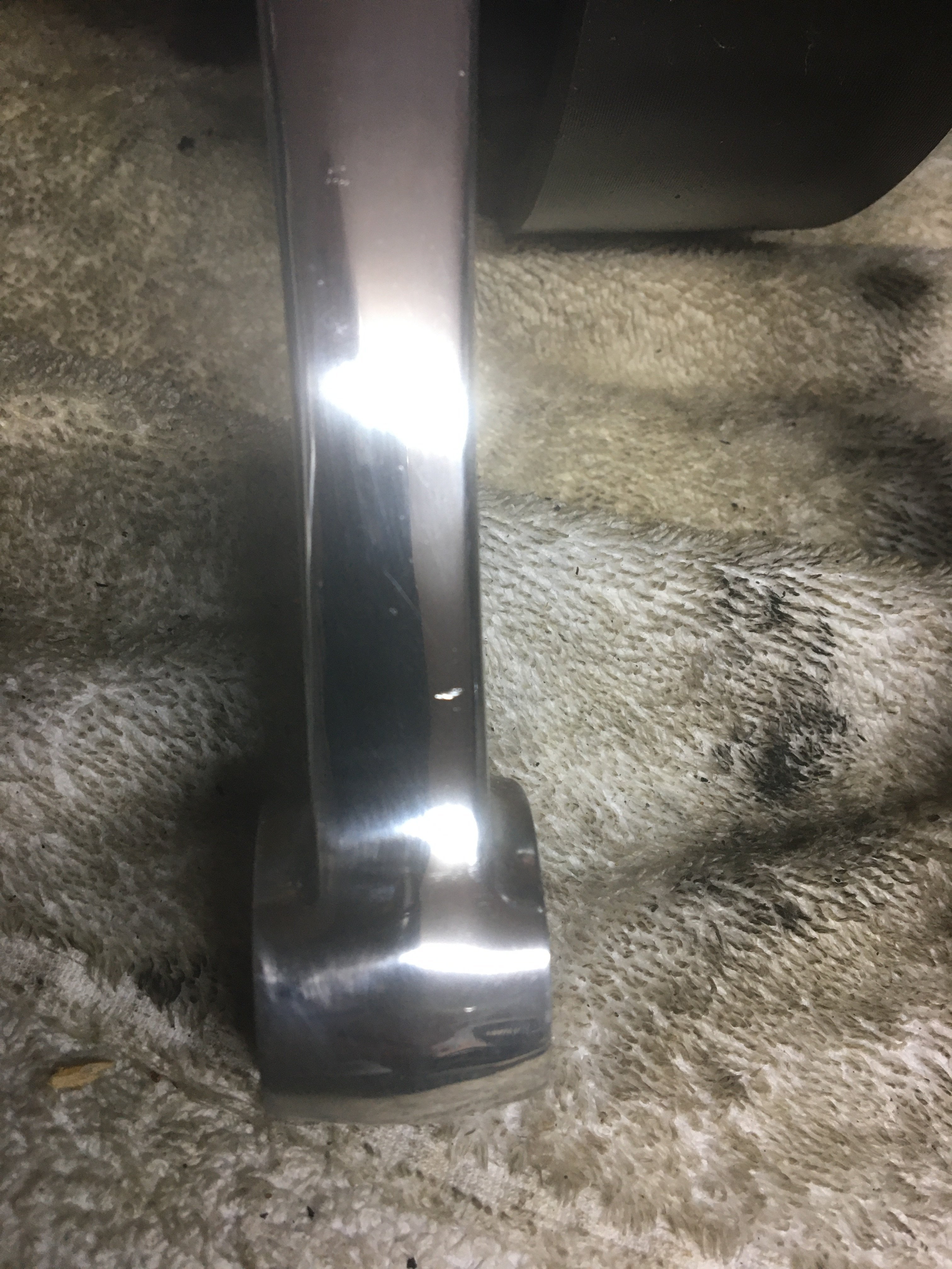

  10. RayV
    Apr 16, 2019
    140
    83
    NW England

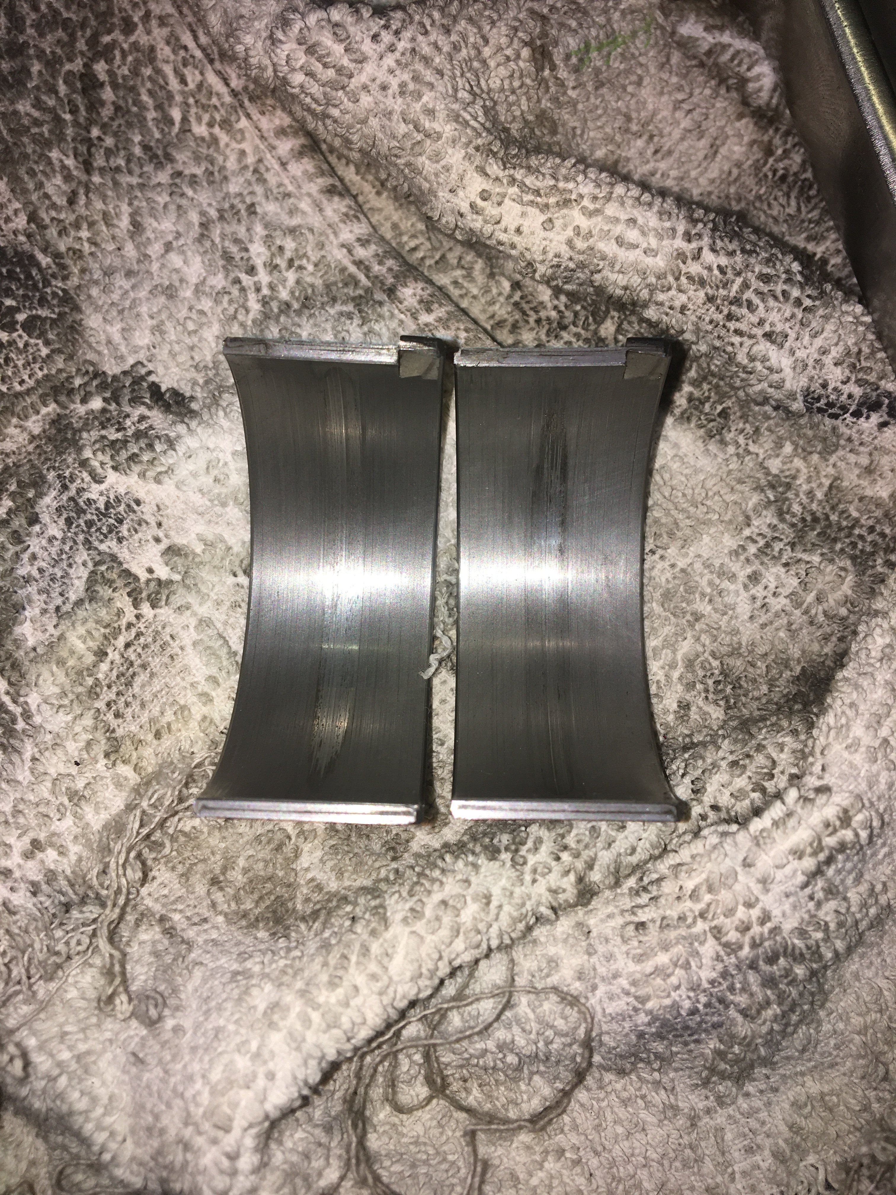

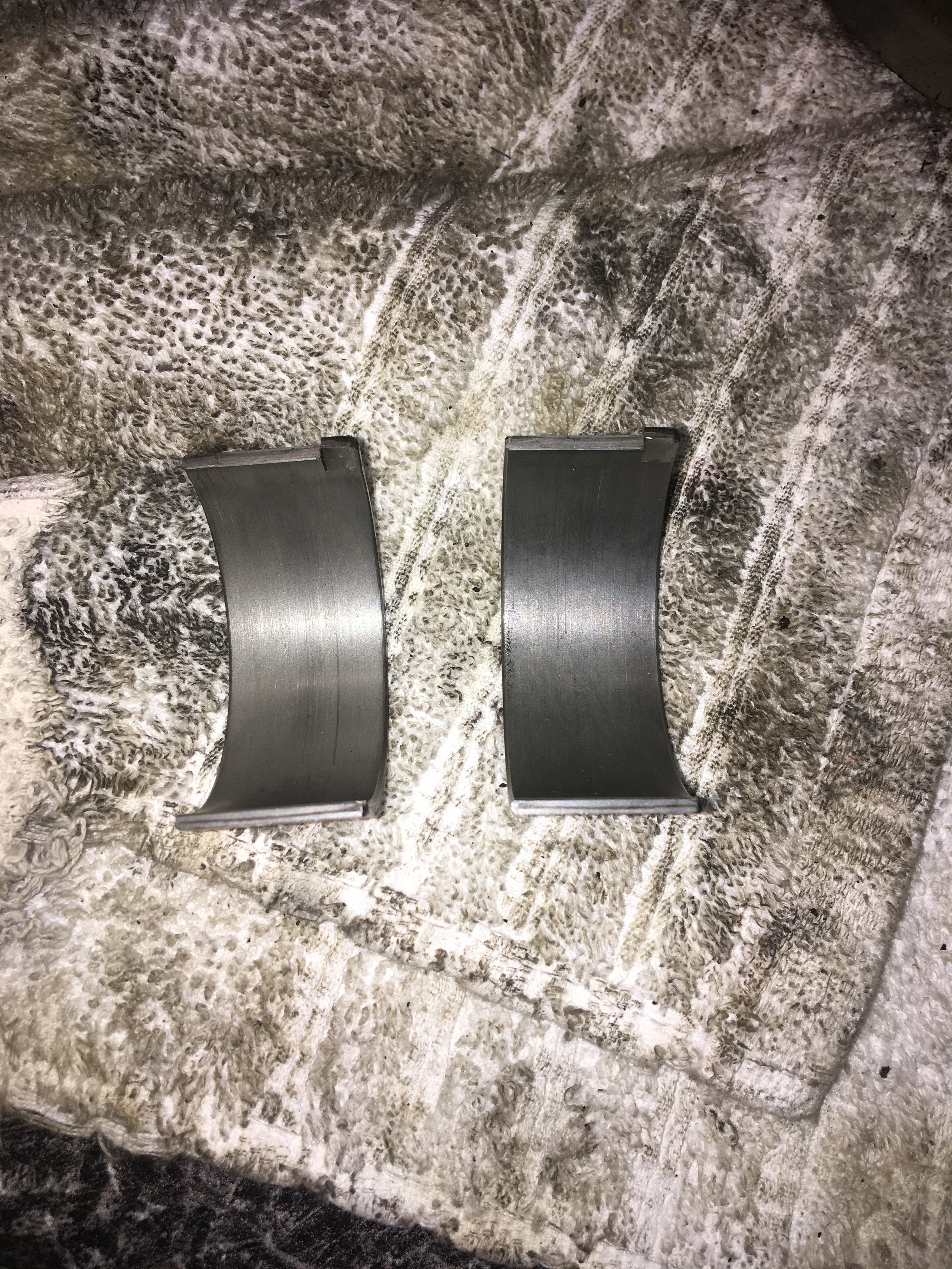

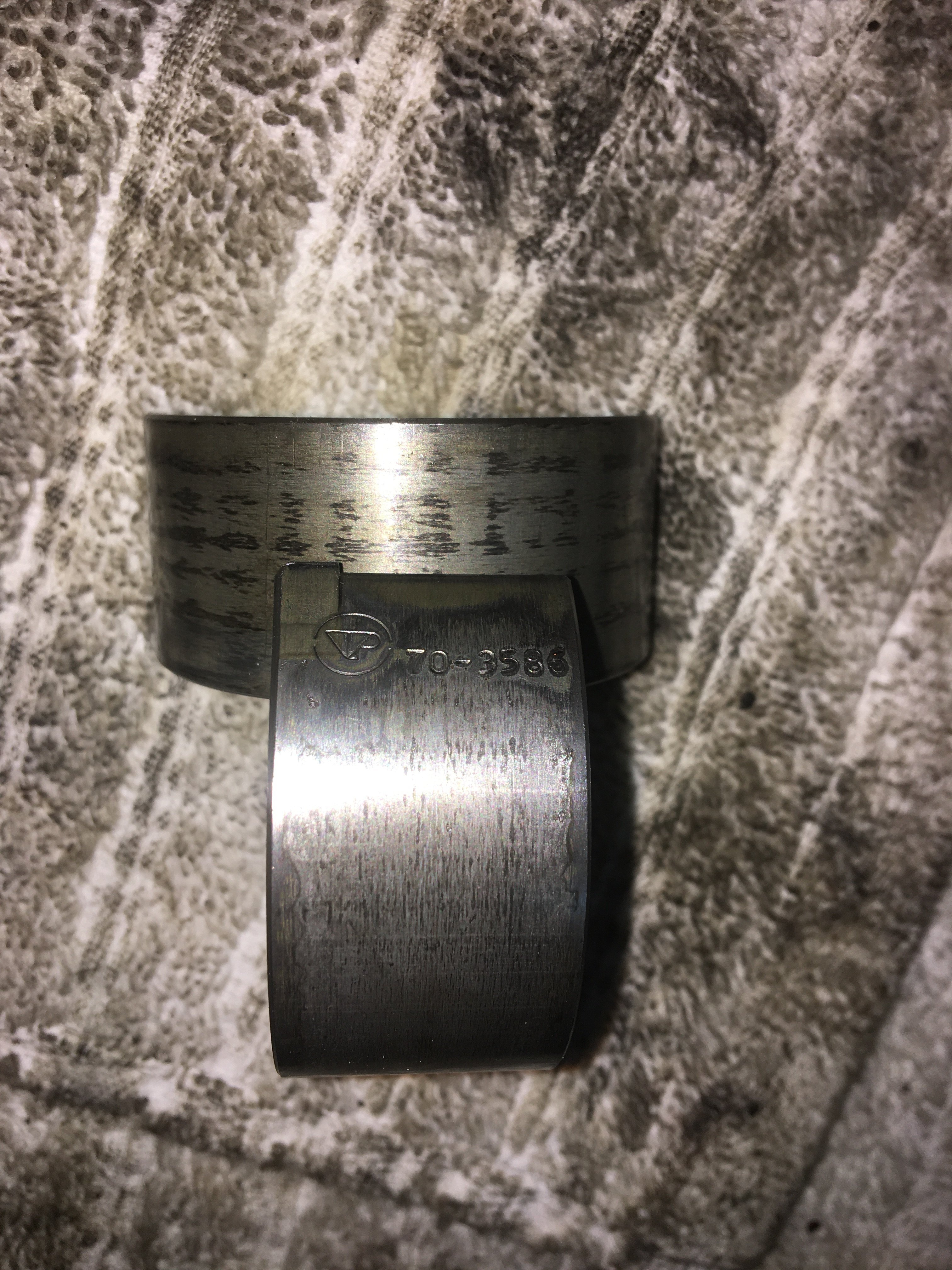

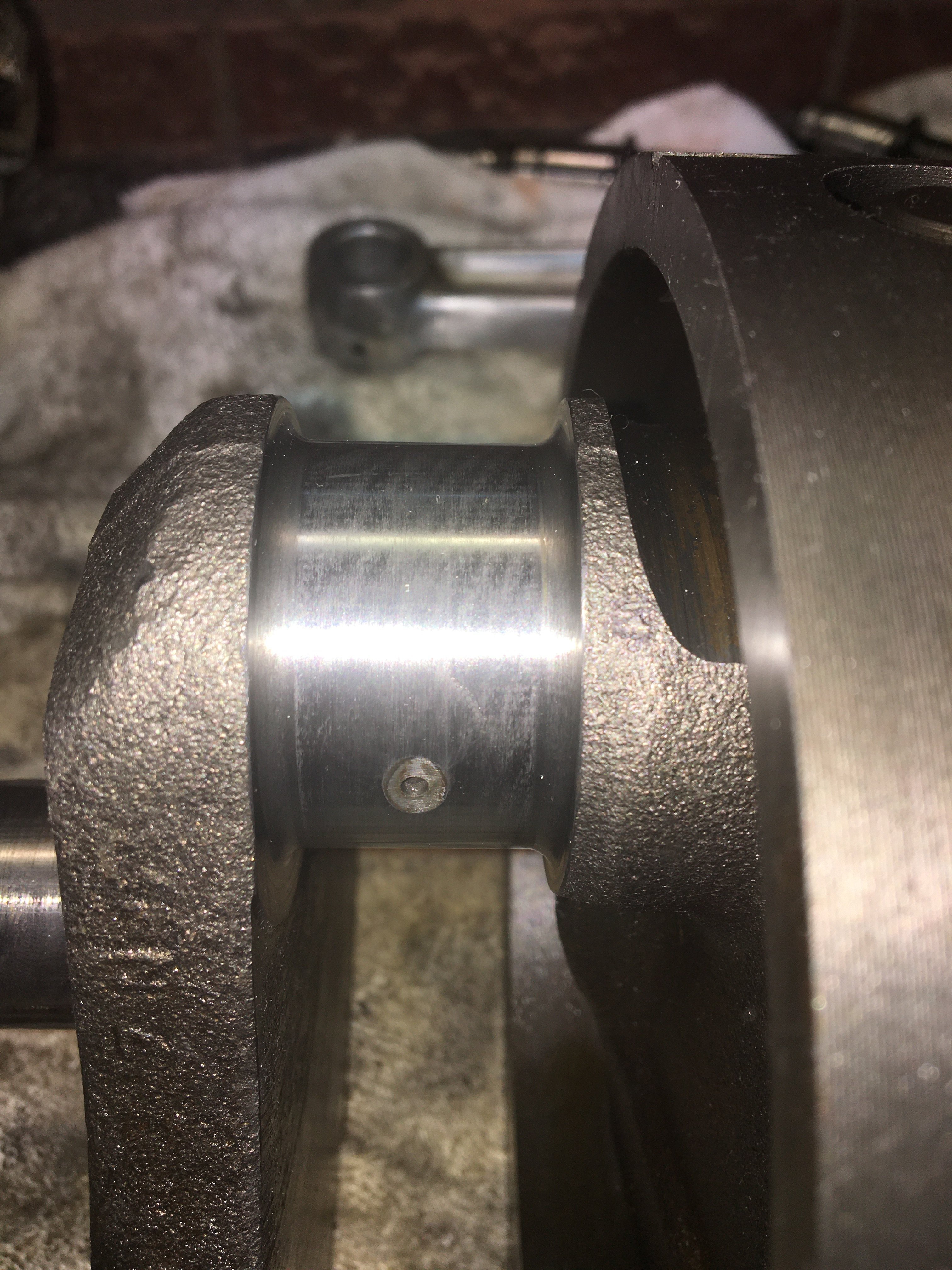

    Despite being what I thought was careful with covering my con rods I have found small marks on them-is this a problem?
  11. darkman
    7,661
    I always remove and small nicks with fine emery and re polish if i have to but i normally like to fit new rods.

  12. RayV
    Apr 16, 2019
    140
    83
    NW England
    As I am extremely tight I will polish it out, as new rods are a bit costly-or is that a false economy? I don’t want to keep going into the bottom end so maybe I should bite the bullet while I am in there? I will only use the bike for general road use so do you think it would be ok?
  13. darkman
    7,661
    I always fit new if building a motor for my self but have used old rods cleaned up and polished when a customer has said that's what they want without any problems, very rare for a rod to let go if its not over revved.

  15. RayV
    Apr 16, 2019
    140
    83
    NW England
    Well I am definitely not planning on going mad on it, so I think I will use these ones once I have them looking nice. The big ends look good and are standard size so that’s good news

  18. Iron
    Iron Guest
    Rods should be fine with a bit of spit and polish. Shells are really cheap though, so get them renewed just as a matter of course.
    You can't stop there, the sludge trap plug really needs to be taken out. Then the sleeve and a clean of all oilways. Assuming sleeve is ok then just a new Allen key plug and centre punched.
