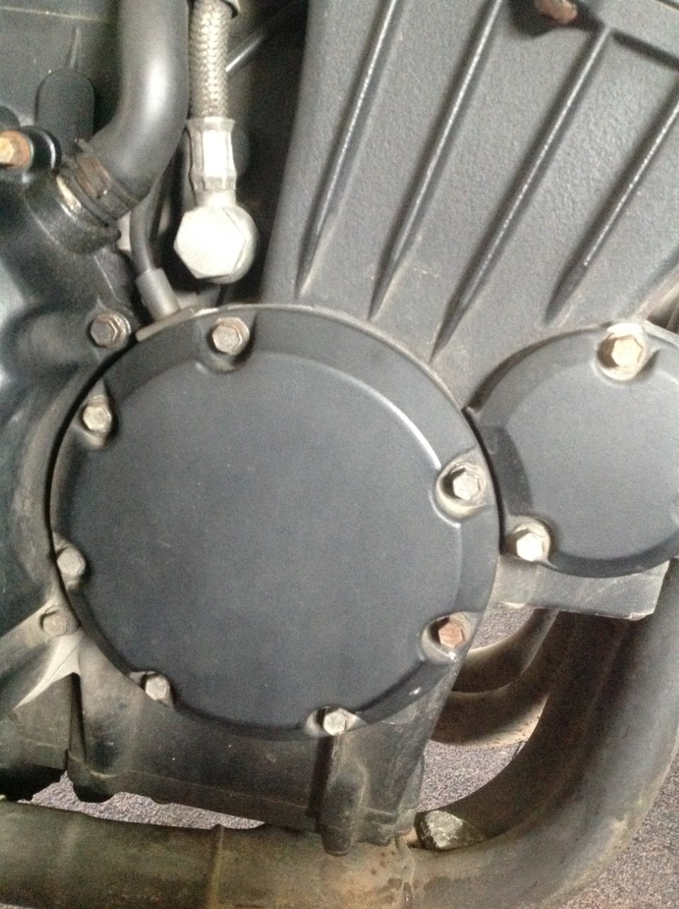

    RHS engine cover near exhaust, will need gap setting between 0.7 & 1mm ( updated figures from triumph was 0.6 - 0.8mm ) from rotor, put a bit of sealer round the grommet when you fit the sensor where it exits the crankcase plug it in refit the cover with new gasket and done

    So I guess this is the cover, and the wire/grommet are for the crank sensor?

  17. Oldyam
    Oldyam Grumpy Old Git
    May 14, 2017
    612
    ireland
    That's the one, bike on sidestand should mean you will only loose a tiny amount of oil.
