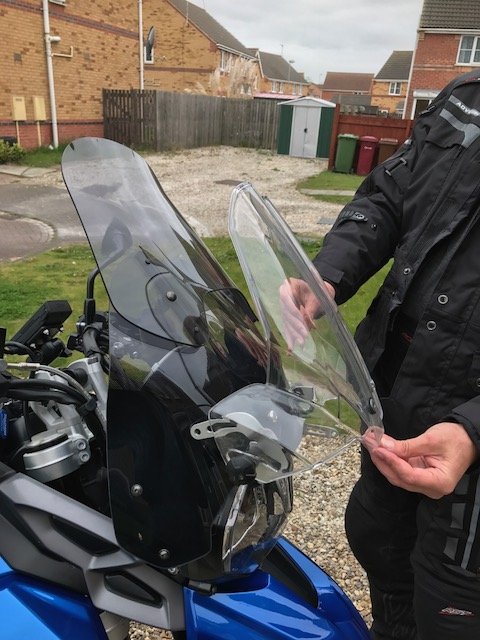

    Well I managed to get out on the bike today with the MRA screen on it and it's been quite a blustery day so I wasn't sure if it would make any difference but it made a huge difference for me. I am 6 ft tall and with the screen set on its highest I am just getting clean air on the top of my helmet where as before it was like somebody drumming on my head so I'm very happy, one of the photos shows the difference in size to the original screen .

    I'm not sure how the bracket fits but there is just about a 2 inch gap between the bump at the top of the clocks and the screen if you get my meaning sorry but the photos don't show it too well IMG_0489.JPG IMG_0488.JPG
