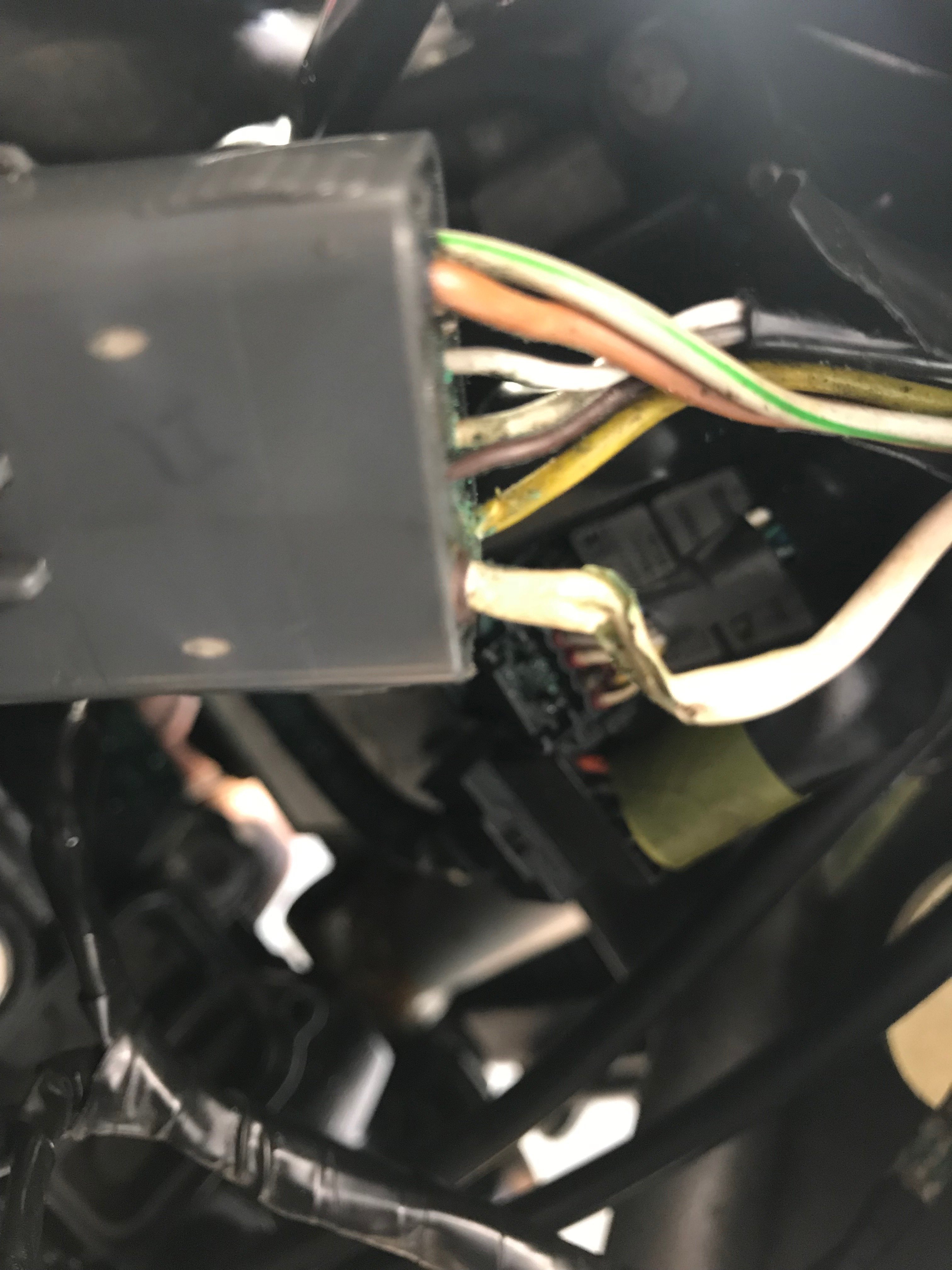

    Well I have finally had a good morning and time to look at bike, me solenoid fitted but still didn't work. Went into switches and followed back looking for breaks, nothing found.
    However ignition block proved to be the issue. The top block from the ignition barrel hidden up in frame must have been collecting water, as one of the cables is so corroded all the copper inside has turned to green powder.
    Would like to think I could get enough cable to repair but looks like it's corroded close to top of the block, looking at the block I don't think I could get the pin out to attach new cable☹️☹️ Think it may end up being new ignition set up

  12. thebiglad
    5,064
    Most of those contacts look pretty green so as well as the repair I would be getting plenty of "Contact spray" on them to clean and protect the contacts.

    I will indeed if I can repair. Was thinking of part ex for new one so repair would be sufficient.
