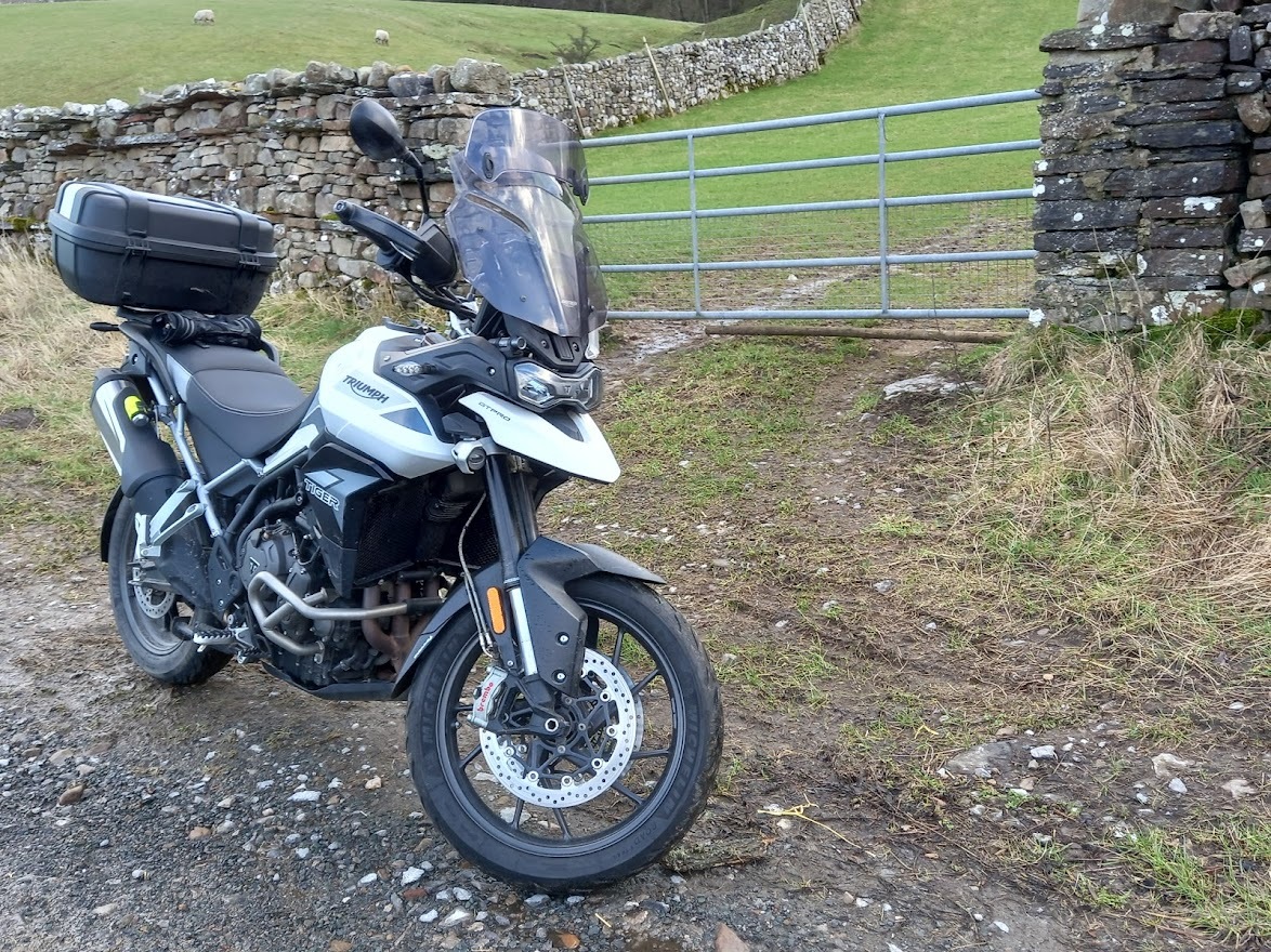

  6. Lyndon
    Lyndon New Member
    May 21, 2022
    9
    Durham, UK
    Thanks for the reply. Is that the Madstad one in the pictures? it looks smart. Does the wind deflector on top of it make much of a difference?

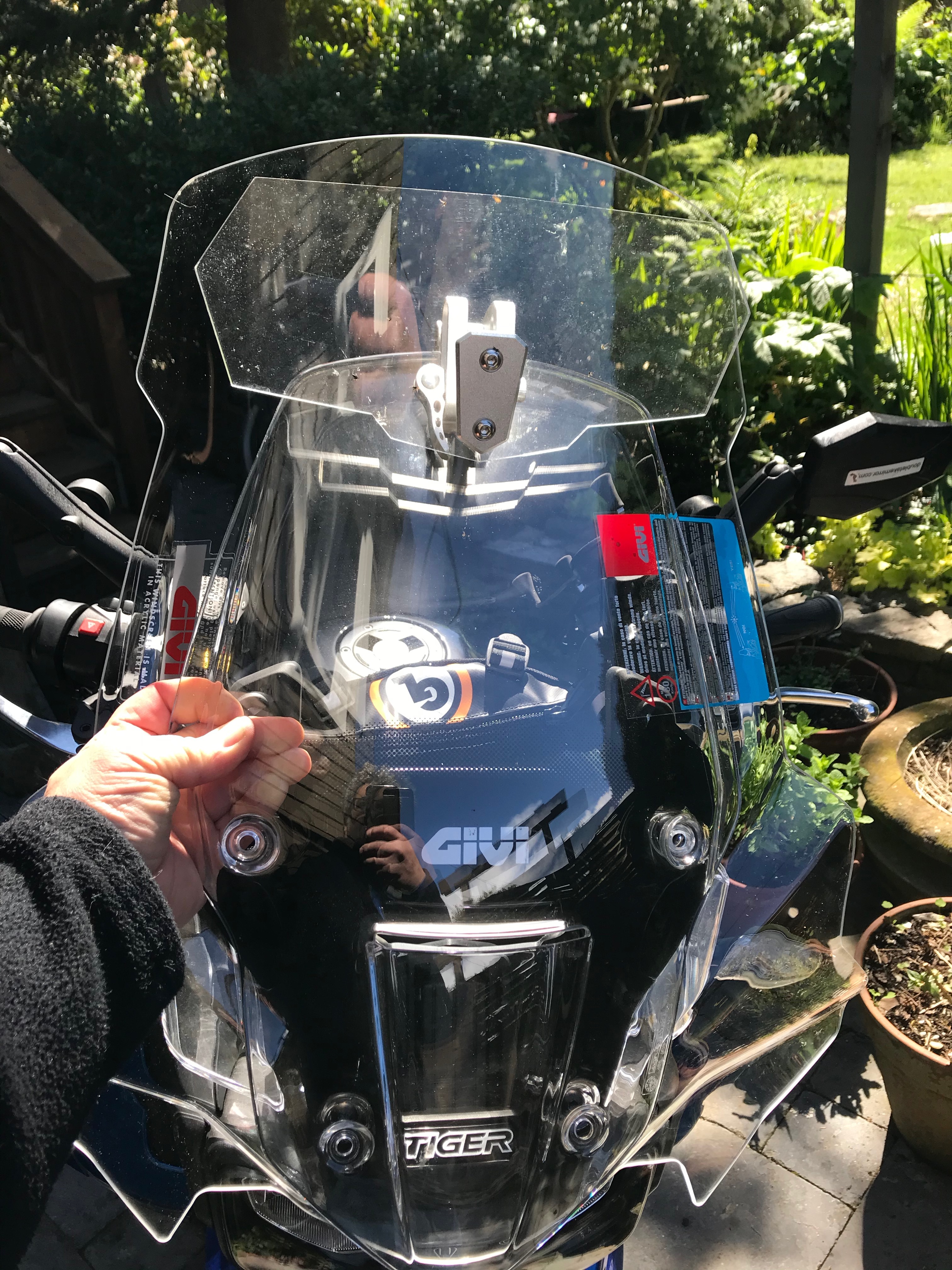

  7. DamonYVR
    DamonYVR Member
    Dec 2, 2021
    41
    56
    Vancouver BC Canada
    Wind noise and buffeting really seems to vary from person to person. I found the stock screen on the 850 & 900 to be OK, but I'm really sensitive to wind noise. The Givi 6415 ST is brilliant, in my opinion. I had two different size Madstad's on my V-Strom 650 and even with the up and down and angle adjustments, it was never as good as the Givi on the new Tiger. So, that would be my advice.
    I'm just under 6'/ 182 cm with a 32" inseam. Shoei Neotec II with ear plugs. I also find that a neck tube, even a light weight one, that can snug up around the bottom of the helmet, can reduce noise inside the helmet.
    One other thing you may notice is that with a bigger screen you get more reflected engine noise; a curious but logical result of a convex reflector in front of you.

  9. DamonYVR
    DamonYVR Member
    Dec 2, 2021
    41
    56
    Vancouver BC Canada
    I guess it is big, but it works. I've spent a pile of money on clear plastic for various motorcycles and scooters, and its depressing. I'm hugely happy with the Givi, though it may not be quite what you're after. BTW, the spoiler on the stock screen in this photo helps some, but still no comparison.
    Everybody's, tolerances are different and fair enough, it has to work for you visually as well as functionally.

  16. steve lovatt
    9,930
    9,232
    Yes, that one is the wider Madstad screen, which is the same height as the original so I added the deflector. This does make a significant difference as I can ride along with the helmet visor open.
