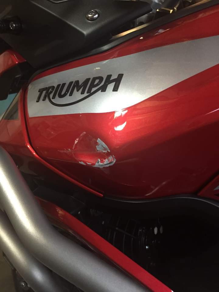

    This was on the Tiger 900 Facebook page last week.
    Apparently the factory upper bars bend into the tank if you drop the bike.

    Wow!! That’s exactly what the bars are supposed to prevent!!! So now what? I’m trying to decide on the best mods for my tiger 900 if I decide I like it enough to buy it some presents and keep it. I guess that’s gonna require some research. The triumph belly pan is obviously not very sturdy either. I just don’t understand why the manufacturers can’t produce as good a product as aftermarket can. I refuse to believe it’s cost. It doesn’t cost much more to manufacture something sturdy as apposed to a nice looking POS.
    Thanks for the info and pic
