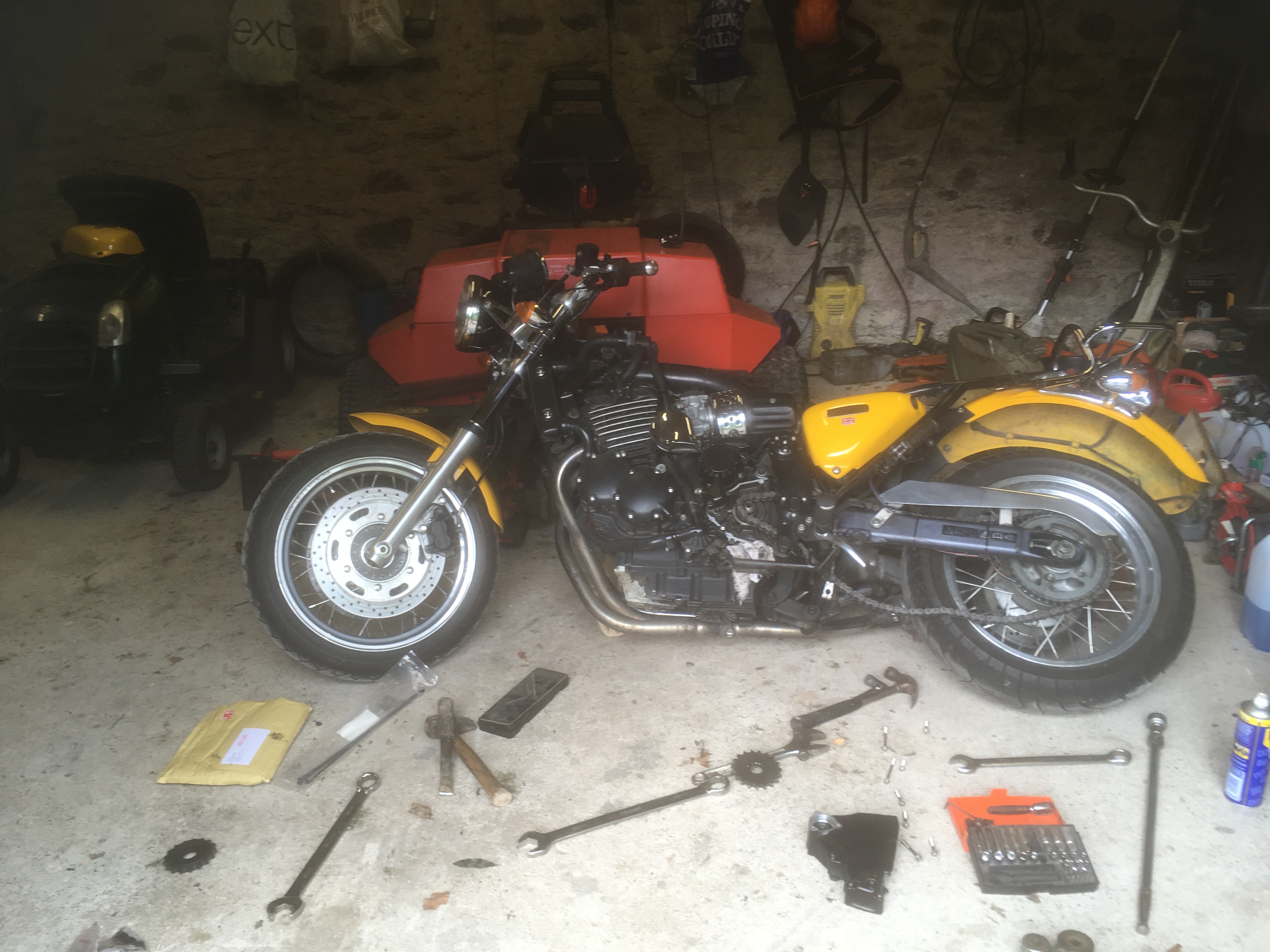

    Well that’s a crap design! After carefully removing the 8 mm headed bolts and gear change, and seeing engine/gear oil leaking out, it obviously involves changing the oil again. Just done that 200 miles ago so won’t be bothering with that for a few thousand miles.
    A bit of a bugger just to confirm how many teeth are on the counter sprocket in order to buy one with a tooth or two extra.

    Well I got sick of the bike buzzing away almost flat out at 100 and at over 4000rpm at 60 mph so I laid the machine over on a post to save my new oil pissing out and changed it.
    It was a 17 toothed counter sprocket and I’ve changed it for a 19 toothed one.
    Haven’t had it out on the road since the change but even going down the driveway it doesn’t need an up change. Perfect!
    I can see why the gear change rod needs the support of a needle roller bearing as it comes from the R/H/S of the bike, but to need to lubricate it with engine oil seems a little excessive, when greasing it occasionally would have been more than adequate
