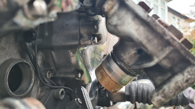

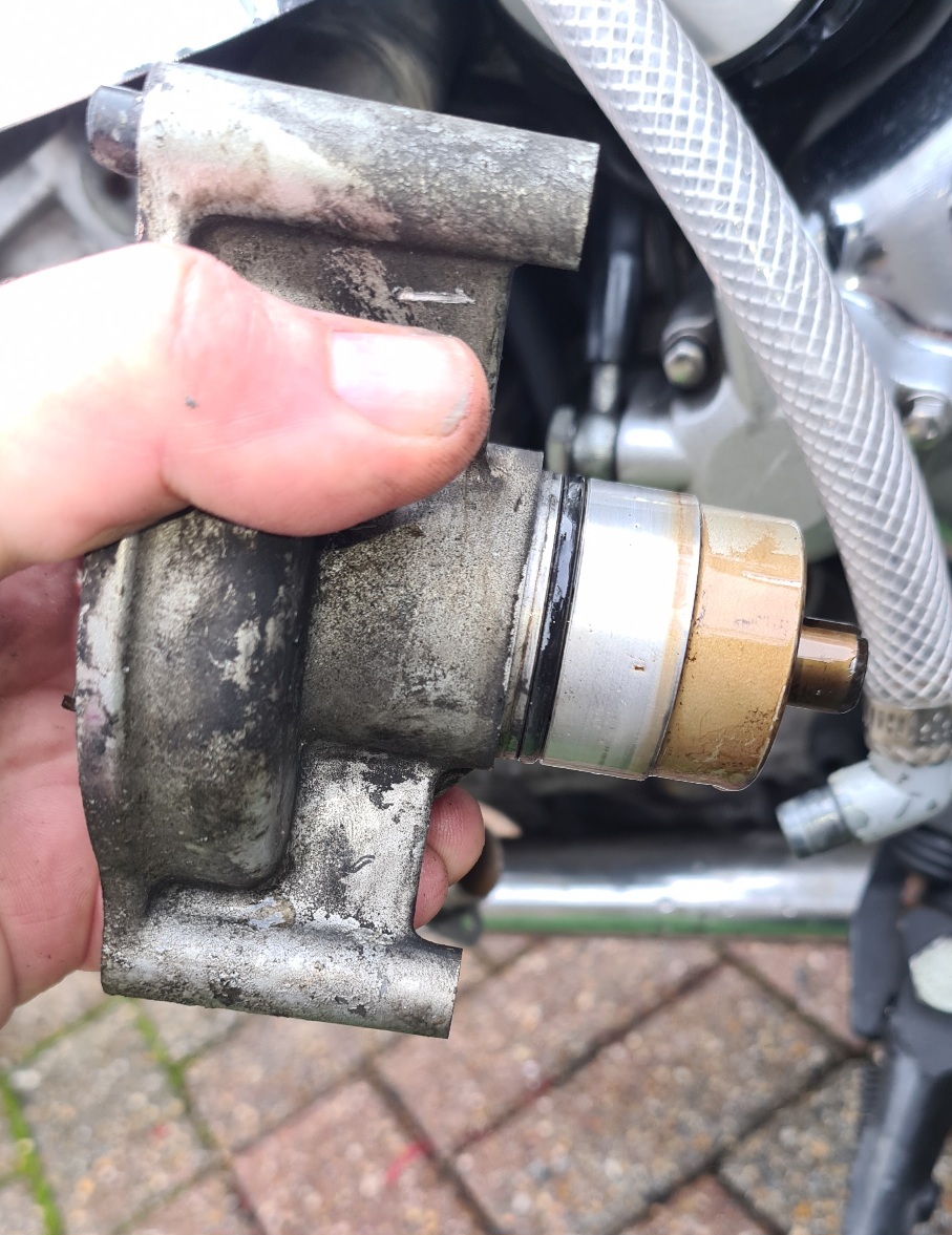

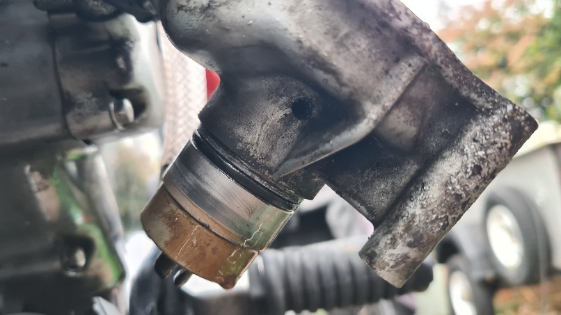

  13. Stu9000
    Stu9000 Well-Known Member
    Nov 4, 2021
    164
    South East.
    I was racking my brain to see how oil could emusify, other than via gasket failure. I did order the co2 gasket tester bubble kit, but it turned out to be a bugus supplier. I've ordered again so maybe that will confirm, or otherwise, a failed gasket.
    I wondered if the water pump might be leaking water to the oil. I removed it today. Looks fine. Rotates as should. Seals look undamaged.
    No obvious sign of leaking from the weep hole.
    Is it possible the seals could be bad, but not visibly knackered?
