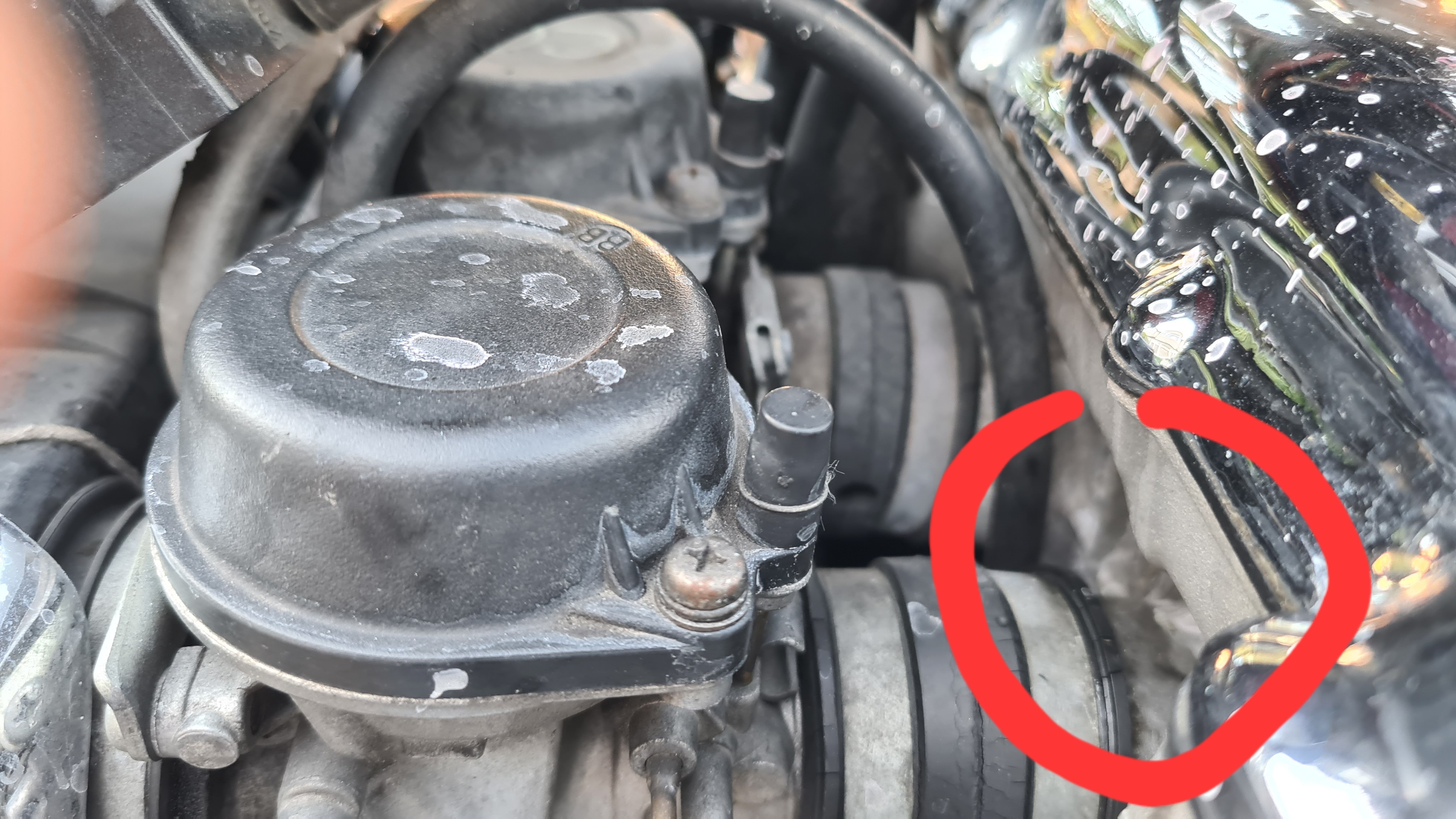

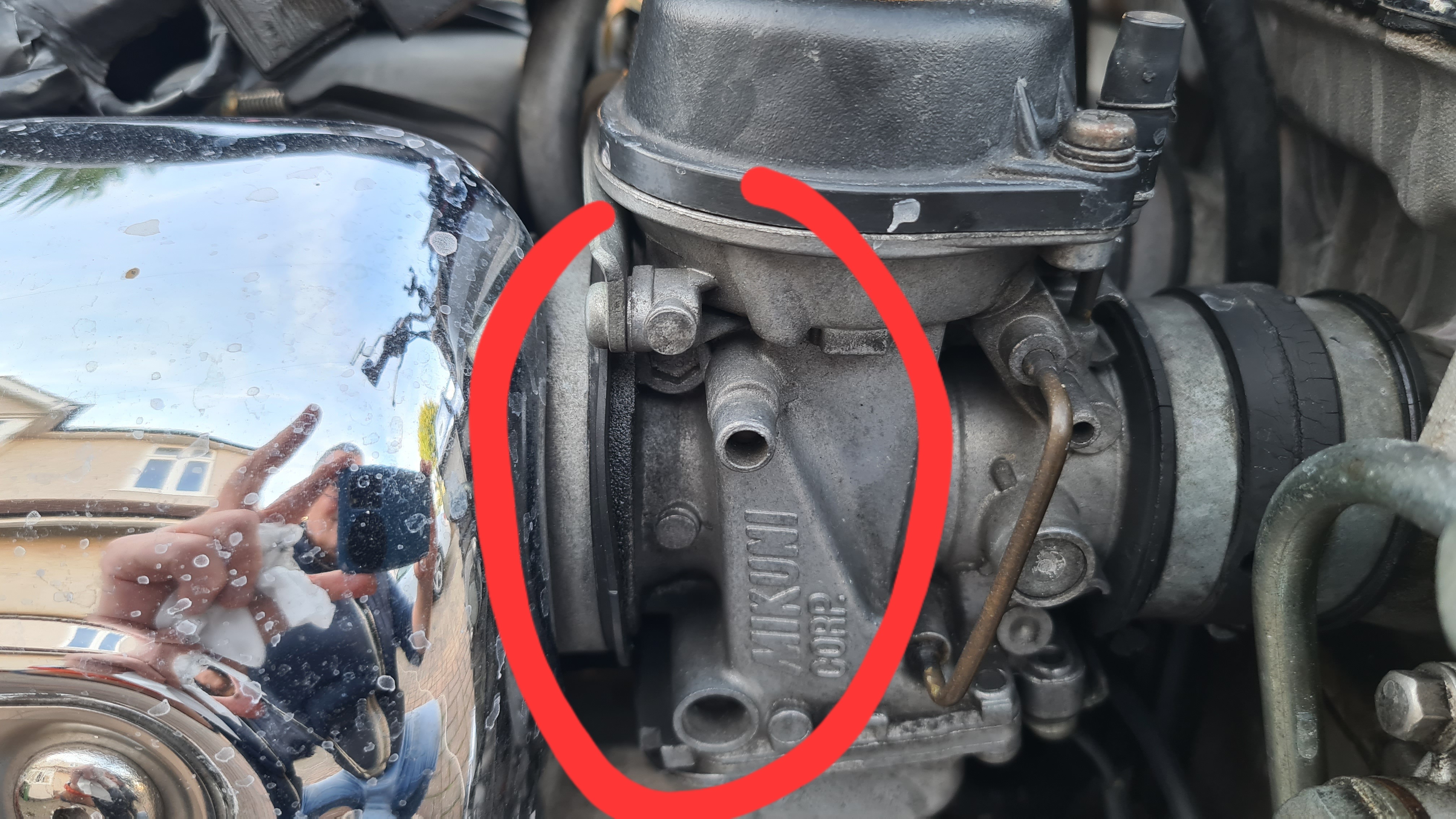

    Ok, the results are in!
    L cylinder 12 bar = 175 psi
    Middle cylinder 12.1 bar = 180 psi
    R cylinder 13 bar = 190 psi
    I do not know what the compression readings should be, but seeing they are fairly even seems positive, does it not?
    I am noticing some black gunk around the air intake of the right cylinder. bike1.jpg bike2.jpg
    I did try to buy a new fan temp switch but the one i ordered did not fit.
    I will look at a new radiator cap, but am sceptical that this is the issue.
    Maybe airbox is gunked up?
    Maybe all that black crap means the carbs are also gunked.
    Had the compression test shown wildly differing results I would have taken her into the garage. However, I am not sure what the next step is. Probably, look at the air filter and box.
    BTW I have no idea what a wet test and a dry test means. Will have to google it.

    Well it appears the rings etc are in good shape. A bit of a difference from cylinder 1 and 3. I would be checking all of the vacuum pipes, carb rubbers etc and make sure they are good and connected correctly.
