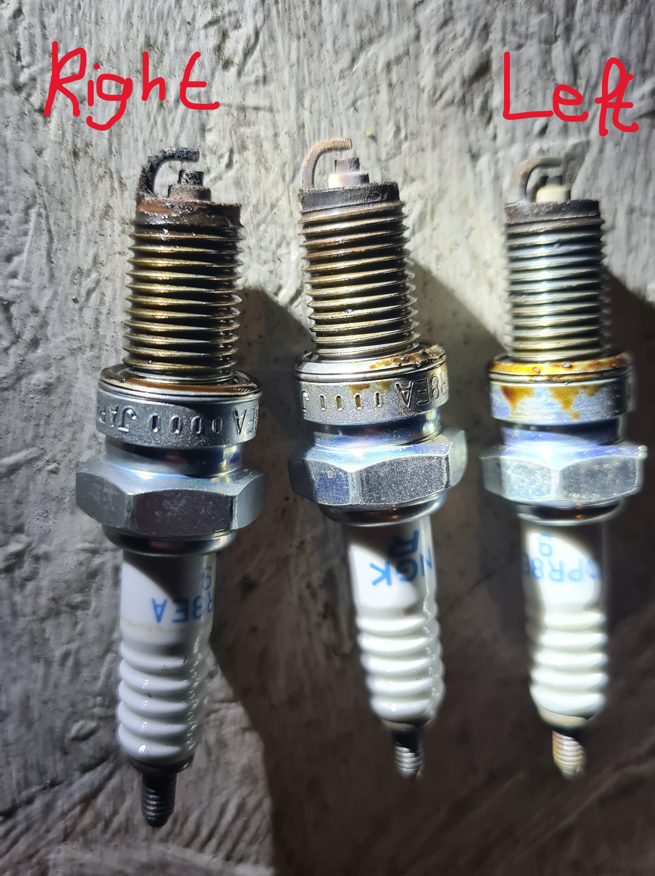

    The bike has been reliable for years but has developed a couple of gremlins.
    The green neutral light is not coming on, but this only happens when the engine is hot. I have read the other posts and will check the wire connector to see if it is corroded.
    The engine was only starting on 2 cylinders. I replaced all 3 plugs a couple of weeks ago which fixed things. The right one was oily.
    New plugs worked wonders but now the problem is back with a vengeance and its only been a couple of weeks.
    What is causing that plug to oil up i wonder?
    I am worried now that that the valves might need work, which I am not confident to do.
    I am going to look at the air box today. I noticed the plastic collars that mount the box to the carbs and the carbs to the engine looked a bit worse for the wear.
    I guess the carbs might have gummed up. I have had that often enough on my 2 stroke outboards. I could probably manage removal and cleaning, but it is not a 5 minute job.
    I cant see a link between the coolant issue and these new symptoms, but I am happy to be educated.
    Bike has done over 30k miles now. Kept under a pram cover thing. Battery new ish and well looked after.
    Right, I am off to take the bike to bits. Sorry about the endless open ended questions.
