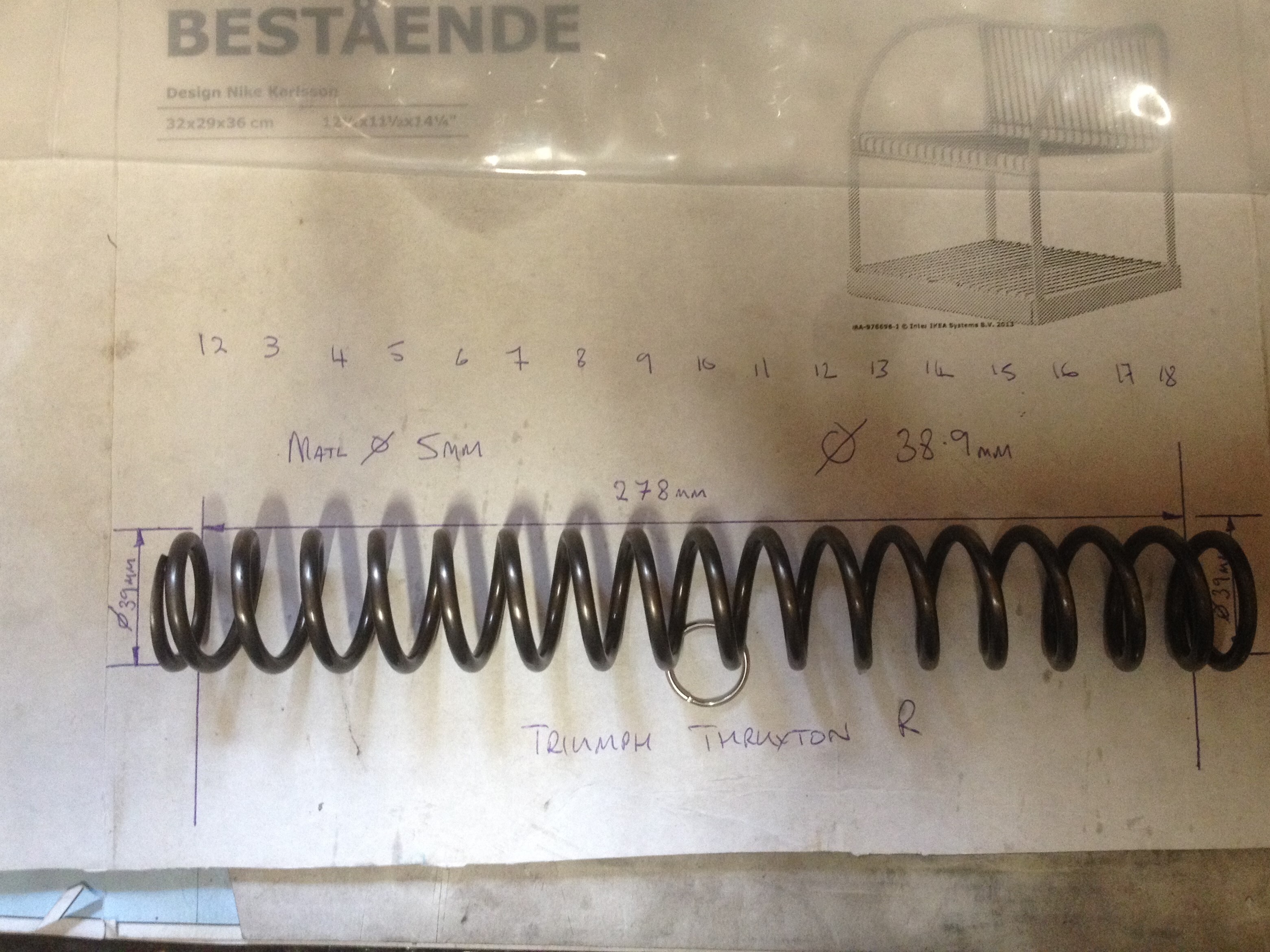

    G’day Julian, I am in the same position as you and am investigating my options. I have contacted a local spring maker for some progressive rate fork springs. Would you happen to have the measurements for the standard fork springs? I need free length, wire diameter, outside diameter and the number of coils. This would save me taking the bike off the road while the new springs are being made.

    Hi Chris. I hope the attached image is clear. So overall length = 278mm; coil outer dia = 39mm; coil material dia = 5mm. I counted 18 coils but not sure of the standard method of counting at the finished ends - again see picture. Let us know how you progress

    Thank you so much Julian, you're a legend! I'll get your data off to Ikon and hopefully will have some flash new springs arriving soon!
