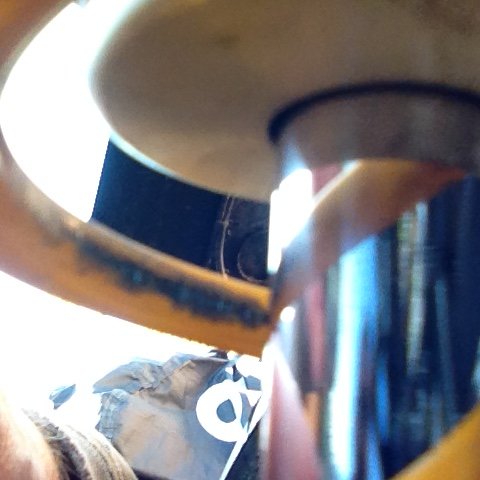

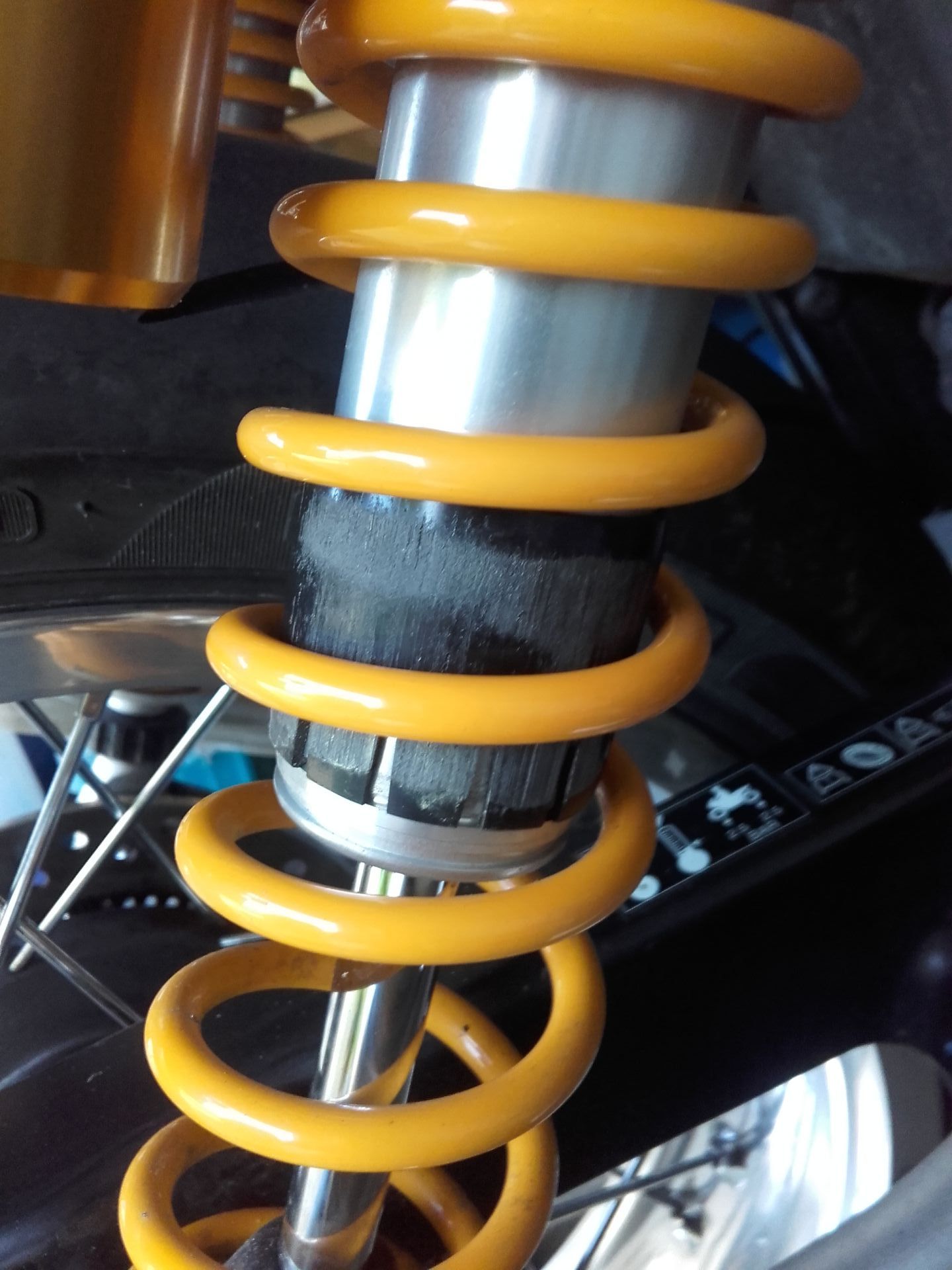

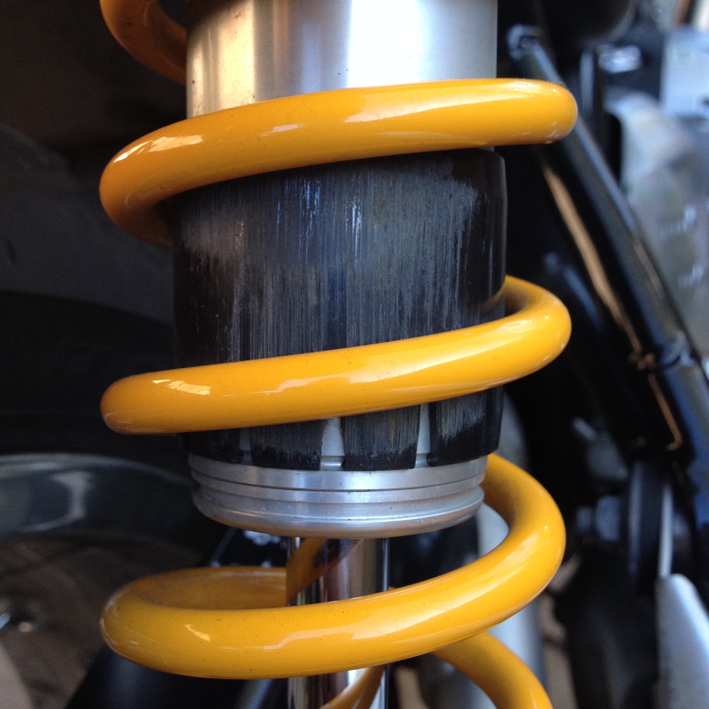

    Here's mine

    Mine have gone as well so I have sent an email to the dealer today. The outside of the black plastic thing doesn't look as bad as Bonzo's but the coating on the spring has worn through which means it will surely rust.

    I wasn't criticising Triumph but I think it is perfectly valid to criticise Ohlins. Look at the clearances between the coil spring and the shock body. Ohlins solution appears to be put a bit of plastic on the body to save the ally tube being marked.
    That's poor design in my book, especially from a "Premium" manufacturer.
