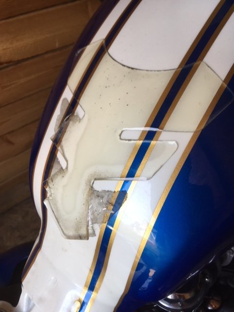

    Reason being? Due to my leather jacket rubbing and leaving a residue that needs tcut to remove it, In the last 3 years I’d bought 4 of these
    And in no time as you can see it turns to shit, so I thought I’d give one a try. It includes pre cut panels to cover most of the tank but I only wanted the bit where my jacket rubbed.

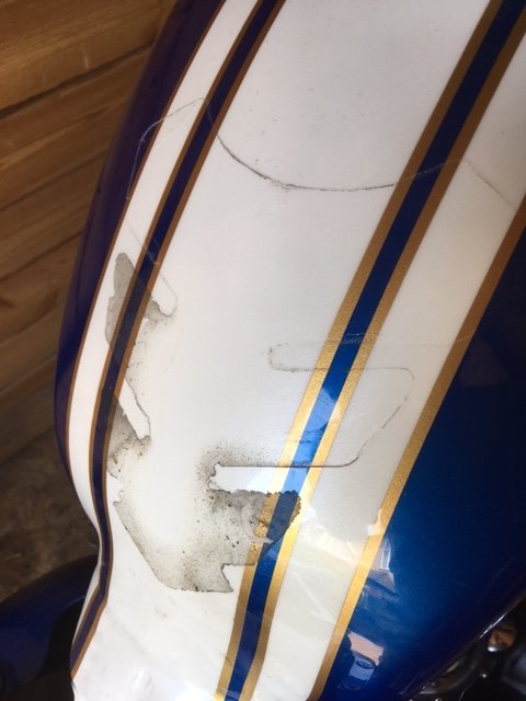

    So first I removed the old protector which left this
    Cleaned it with this

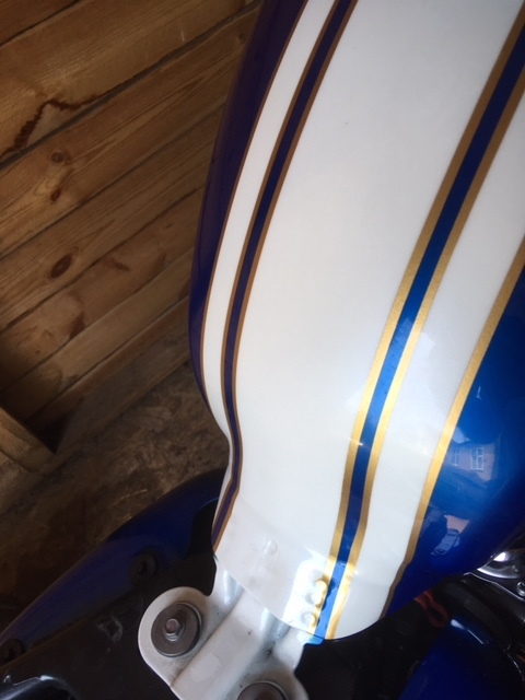

    And after not too long, remembering to get all the residue that’s been spread around I am left with this
    All glue, polish etc removed which is the starting point for applying the protector.

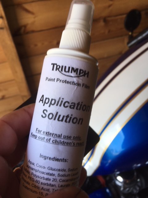

    To start you get a supplies spray bottle which you fill with water and shake vigorously, probably very mild washing up liquid
    You then spray everything that will come in contact with the film, both sides of the film, hands, tank etc.

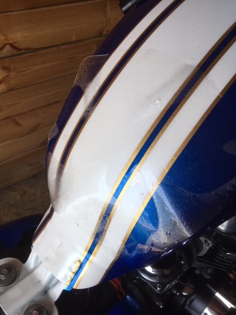

    You then lay the film on the tank,
    now, because it is cut to shape so it fits the contours of the tank, there is no point trying to get it a bit lower as I did and waste 15 mins and a lot of cool because it won’t.

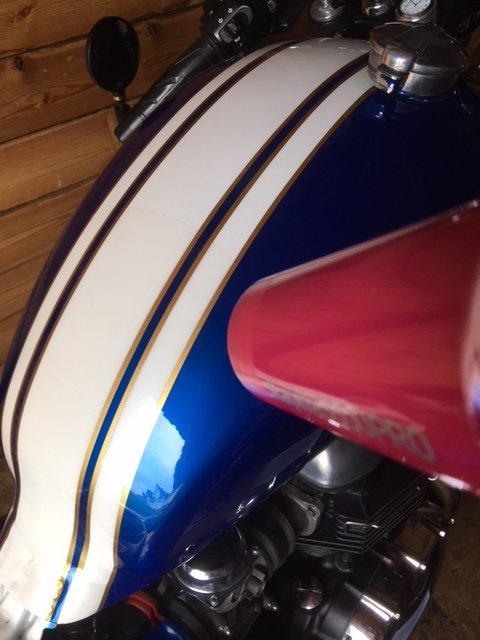

    Keep hands and both sides well sprayed and start pressing it down, they give a kind of rubber squeegee thing to help but I found the majority was easier with hand and fingers. It is a bit fiddly squeezing air bubbles outwards etc but with a bit of stretching, pressing and patience it gets there in the end.
    Once any excess water is wiped away you then heat it with a hot air gun or hot hairdryer
    Mine was a tuono accessory
    This affectively shrinks it and adheres it to the tank, job done you hardly notice it
    It can then be treated as normal and polished etc. I’m impressed with it and it looks worth it if you can get it at the sale price. Time will tell on the finish though
