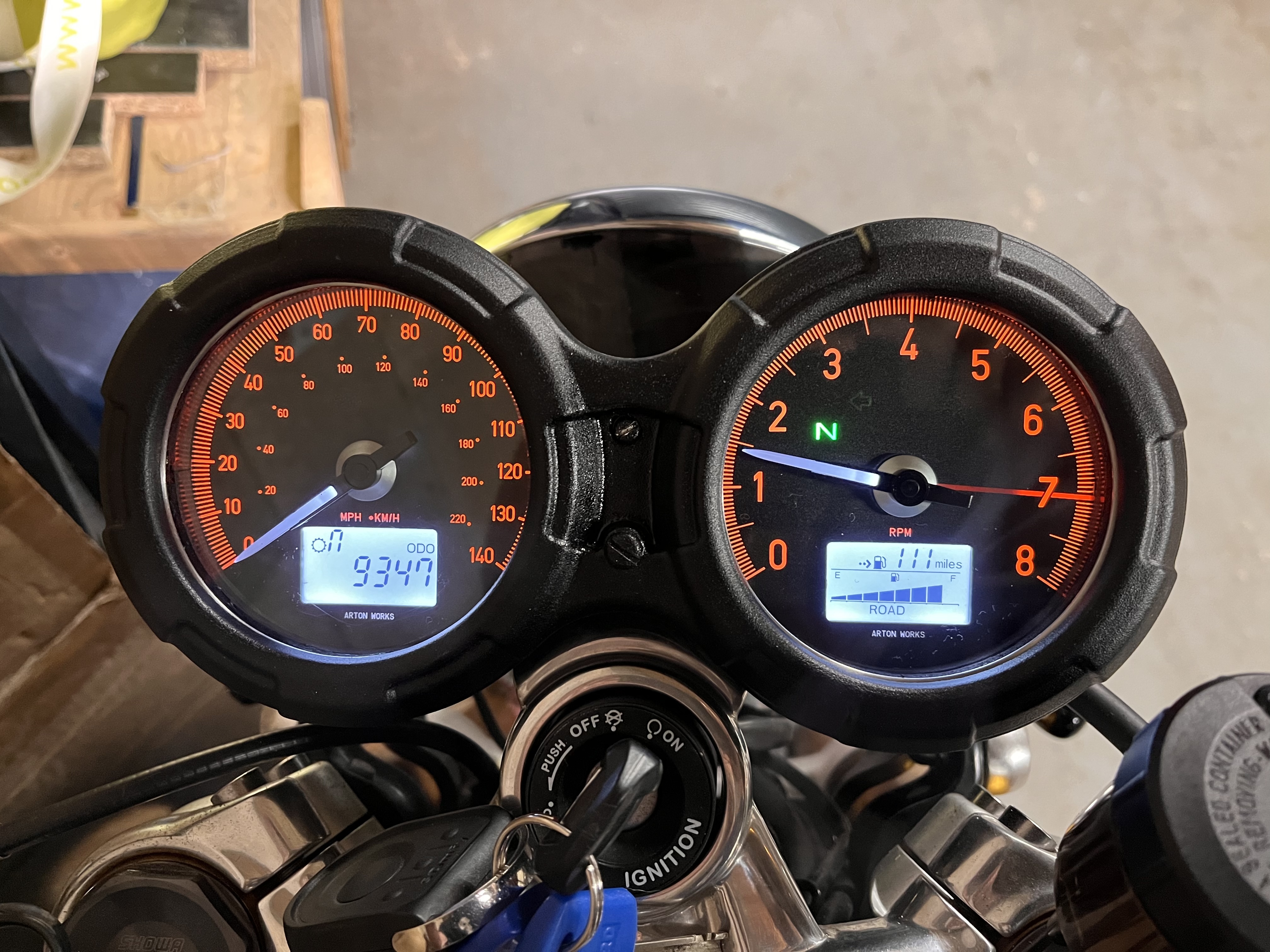

    Just fitted some Arton Works dials and had some new glass fitted.

    Yeah was quite and extensive repair! Cut the old glass out, had some plexi glass discs made (£15) and some alloy spacers laser cut (£8).
