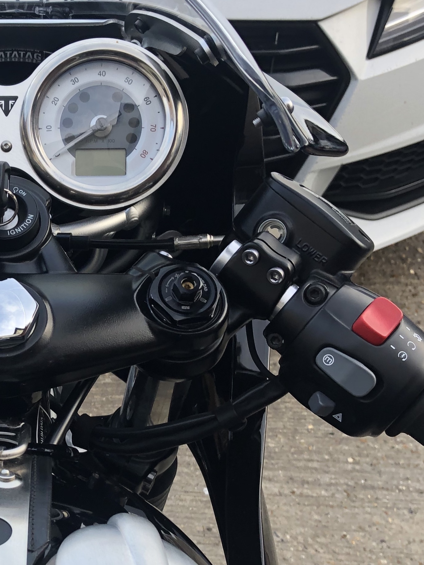

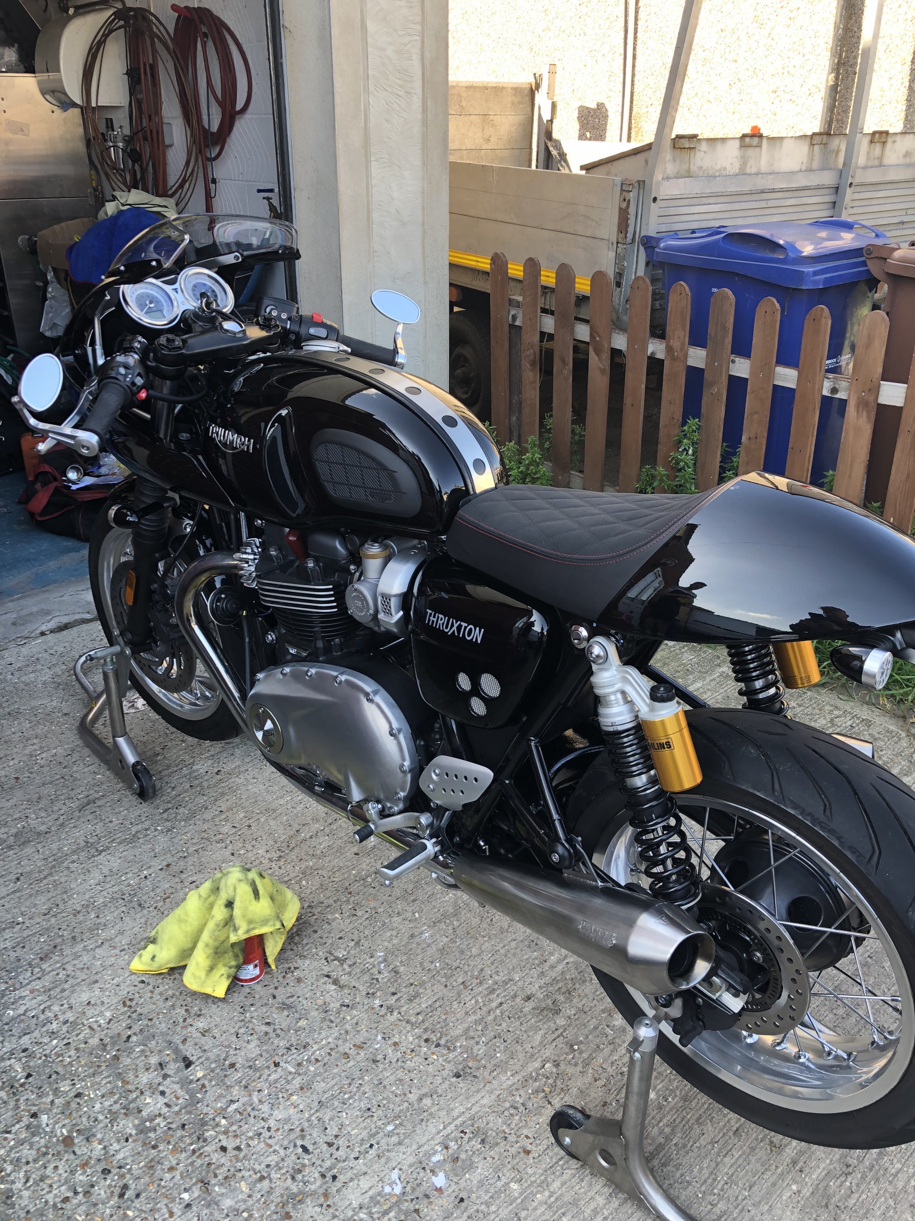

    Hello all,
    I got a pretty good deal on a leftover 2017 Thruxton, and have loved every minute of it. As I get some miles on the bike, I do find myself wanting a little stiffer suspension in the front, and was wondering if anyone had worked on putting some R suspension on their base model bike.
    As far as I can tell, Obviously the rears just bolt on with no modification, but the fronts I'd have to do the fork set, and the triple tree. I don't believe there is any difference from R rims and base rims- correct me if I'm wrong. Brakes would obviously be switched to the Brembo, with the master cylinder as well.
    Realistically I'm into my bike $4k less than a new R would of been, so I have some money to spend on parts. Even if I go OEM on everything, the parts breakdown from triumph is around $3100 for all new parts, including forks, brakes, master, triple trees, and rears.
    Thanks for the help!
    Pic for attention
