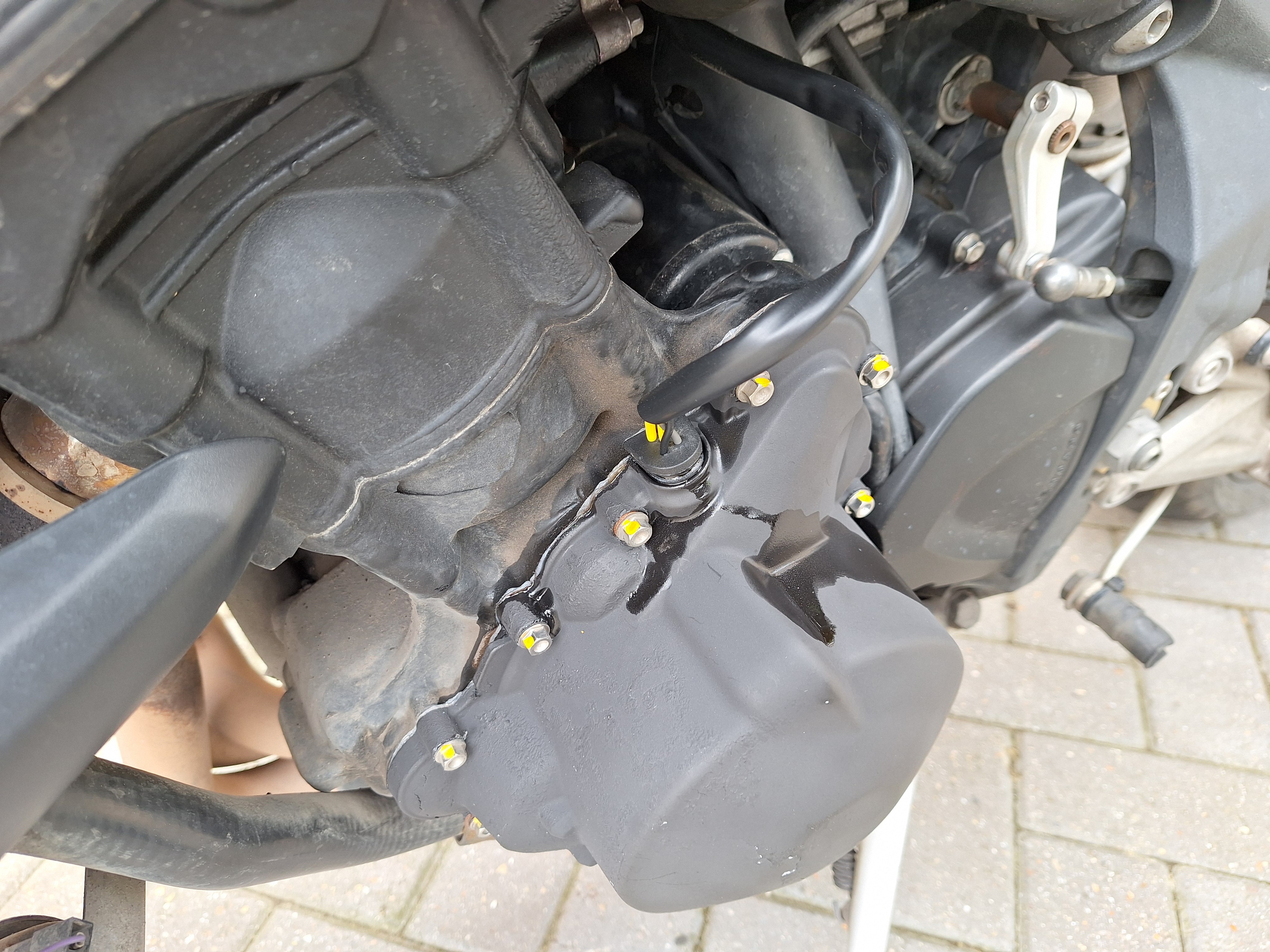

    WTF! Who do I have to blow to catch a break?? Just got home from work and notice this as I'm locking up.

    Did you use any silicone RTV on the cable grommet?

    The annoying thing is, that seemed like the one place it wouldn't get by! No, I didn't ☹

    Its a regular leak point and my 675 has done it previously there.
    Add rtv, silicone etc and lesson learnt ;)

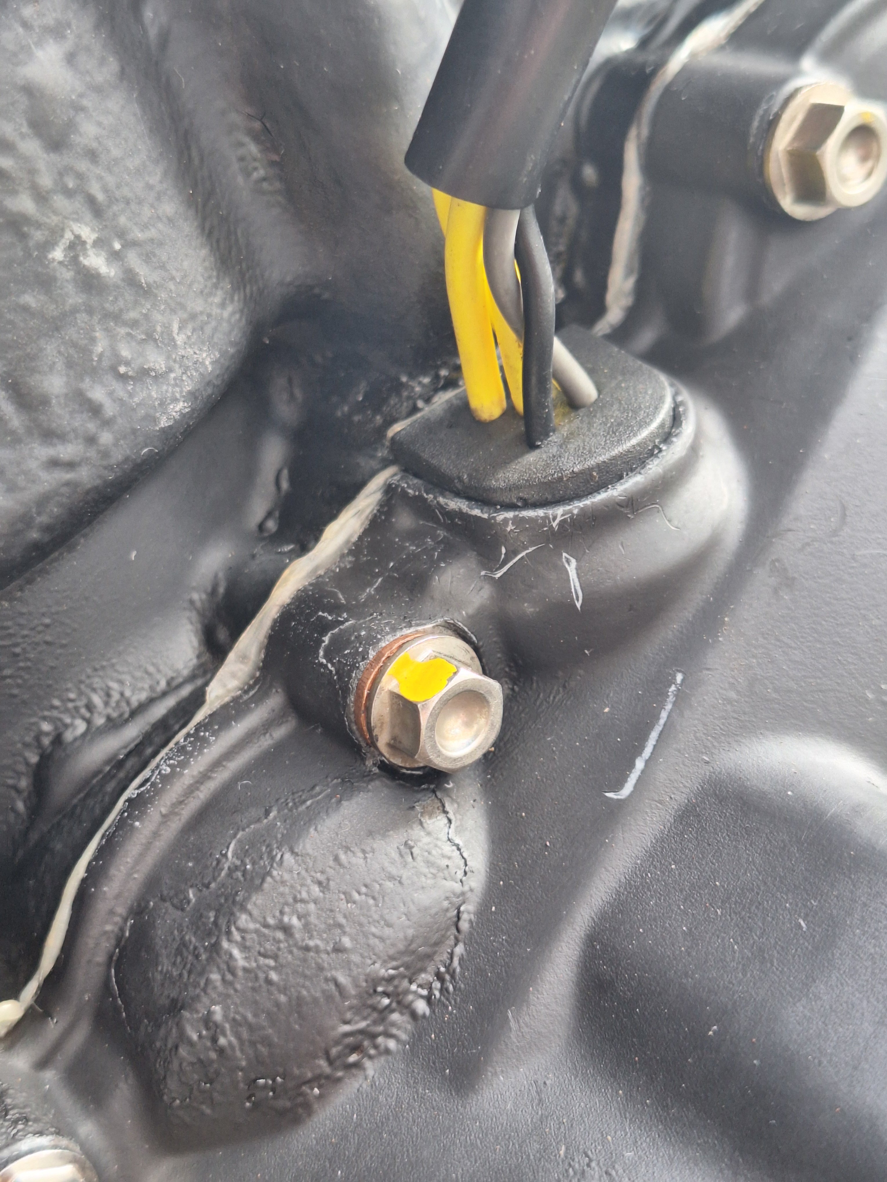

  7. Dave Teece
    Dave Teece Well-Known Member
    Jun 17, 2016
    176
    South Essex
    I had failed to observe that the grommet wasn't seated correctly. This morning I have managed to tease it into the cutout properly Ride out to fill the tank, ready for work next week.
