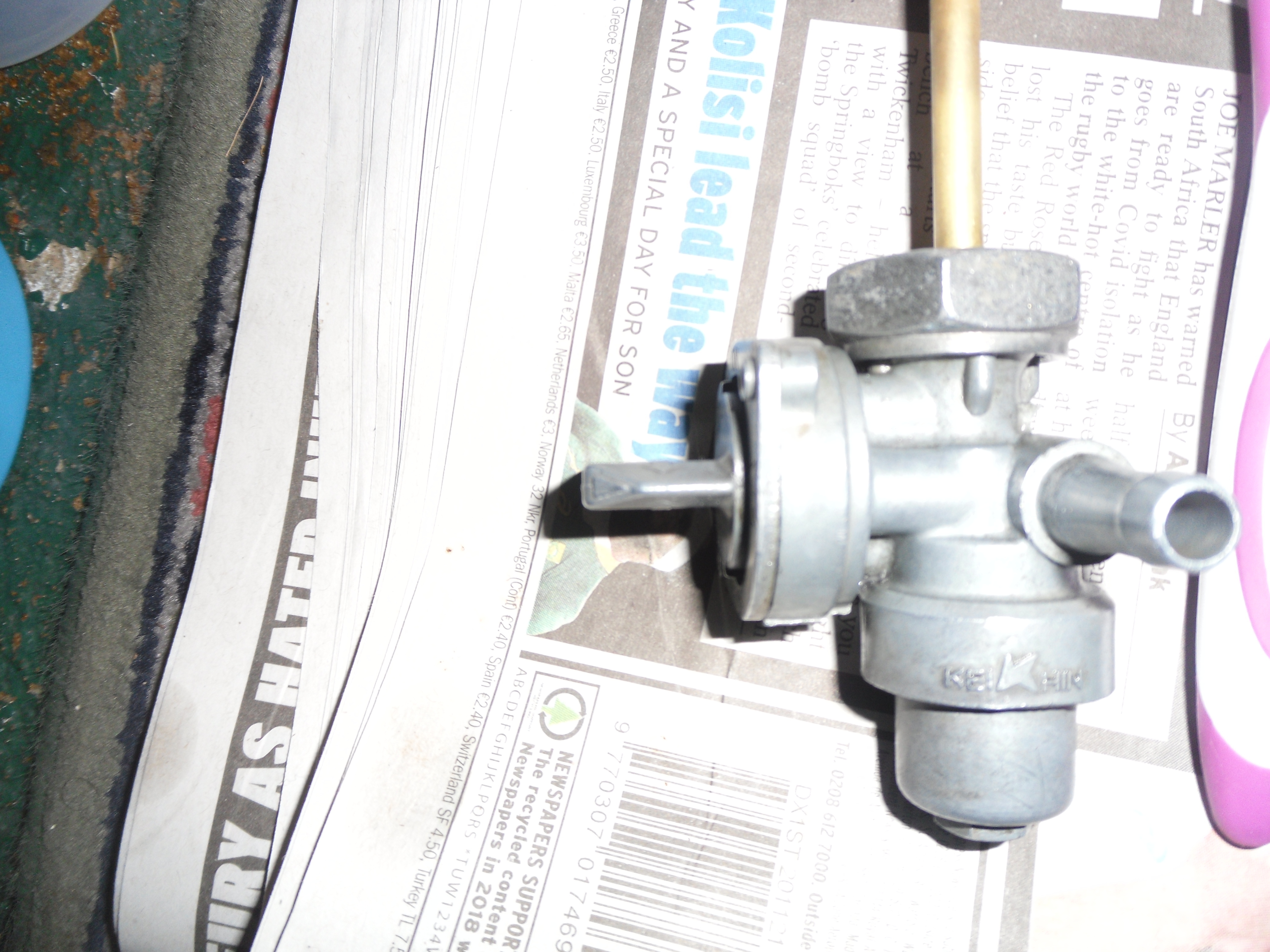

    It's a Honda 1985 GB500tt. The fuel tap is a 20mm thread and an oem part is £130 + vat! If it was any other size, e.g. 18mm then the Honda part is about £30. Repair kit is £20. Apparently a BMW R series tap can fit, seen them new for about £35.
    As you can see the rivets need to be drilled out. I never even thought of stripping the thread when tapping by bottoming out in the hole, but looks like I could drill all the way through. SAM_0131.JPG SAM_0132.JPG InkedSAM_0133_LI.jpg InkedSAM_0133_LI.jpg
  12. Yorkshireman
    3,401
    Looks like you have two options there Tony, drill all the way through and tap a new thread or there looks to room on that shoulder to take a small nut and use a small nut and bolt to hold the front plate on.

    Don't think there is room for a nut unfortunately, but can't see any reason not to drill straight through.
