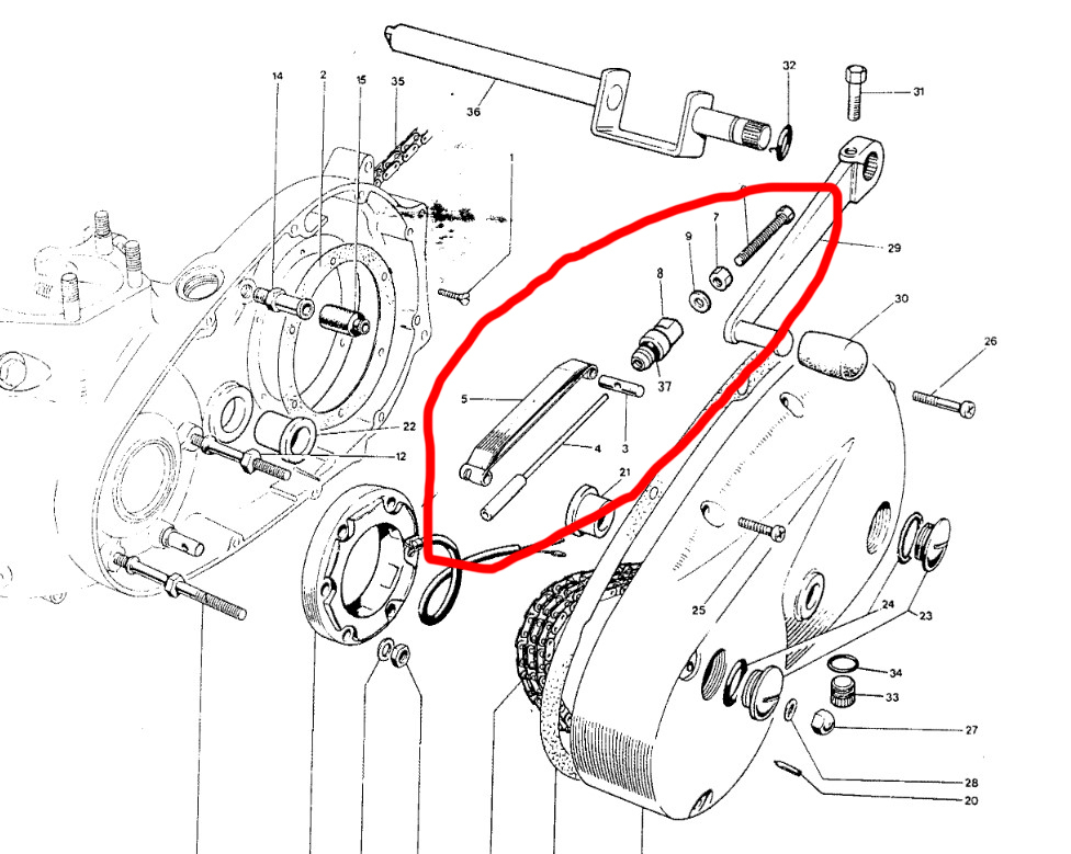

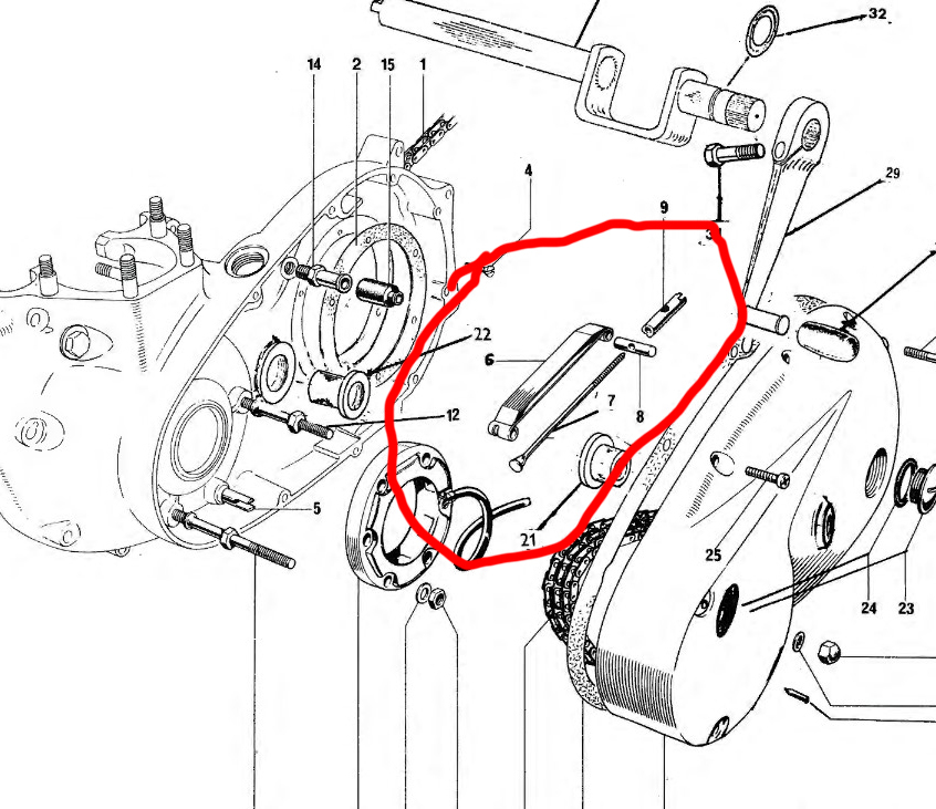

    Yep, just finished doing the primary chain adjuster. The E model (may be on the D as well but haven't had one of those) has a bolt that pushes on the tie rod rather than pulling on it to make it arc up to tighten the primary chain
    Here's the normal earlier up to '77 V tie rod parts catalogue
    And here's the later '80 E tie rod parts
    Note also that the E model tie rod is shown the wrong way round. The thicker section is pushed on by the adjuster bolt.
    It's a proper arse to fit as there's hardly any room to do anything up. I think the later '80s bikes reverted to the older system.
