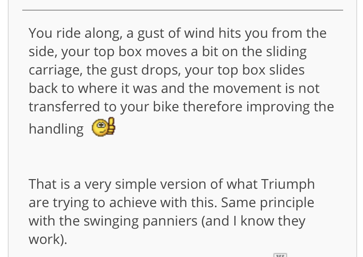

    Rational behind the "sliding" feature is for reducing energy transferred to the rear of the bike during gusty winds with the top box installed

    This is from a trimuph 1200 web sight

    Well call me a cynic but the rider is a darn sight bigger than the top box......fairings also catch lateral wind noticeably when overtaking trucks in wild weather.
    There are various forces at work but for loose box contents Google ‘free surface moment’. It capsizes ships and particularly ro-ro ferries because they lack compartmentalisation on the main deck once water gets in. The phrase ‘loose cannon’ derives from the same problem of a couple of tons of cast iron punching holes in the side!
    I return to the marketing idea that perception trumps reality and thereby justifies the price. But maybe it works!

    Interesting comments folks thanks. I should think there is a side to side force on box and contents when negotiating the twisties. Presumably this sideways momentum comes to an abrupt halt when weaving the other way. I understand that the mass of the driver is far larger but not interested in that - just the science behind how a sliding carriage makes a bike more stable. Imagine this scenario: a 40 knot gust of wind hits you sideways on. The top box and contents tries to accelerate to the same speed and then rams against the stops. So you have an accelerated mass at a given speed trying to topple the bike over sideways at a point displaced from the fore/aft centre line of the bike. Perhaps this changed, effective lever angle reduces the turning moment (or whatever it is called)? I don't know.

    Think of it as a shock absorber. Your steering inputs and unconscious body shifts have far greater impact on your direction of travel. If you really think about it ‘stability’ comes from balance rather than ‘stabilisers’ - even when you were three!
