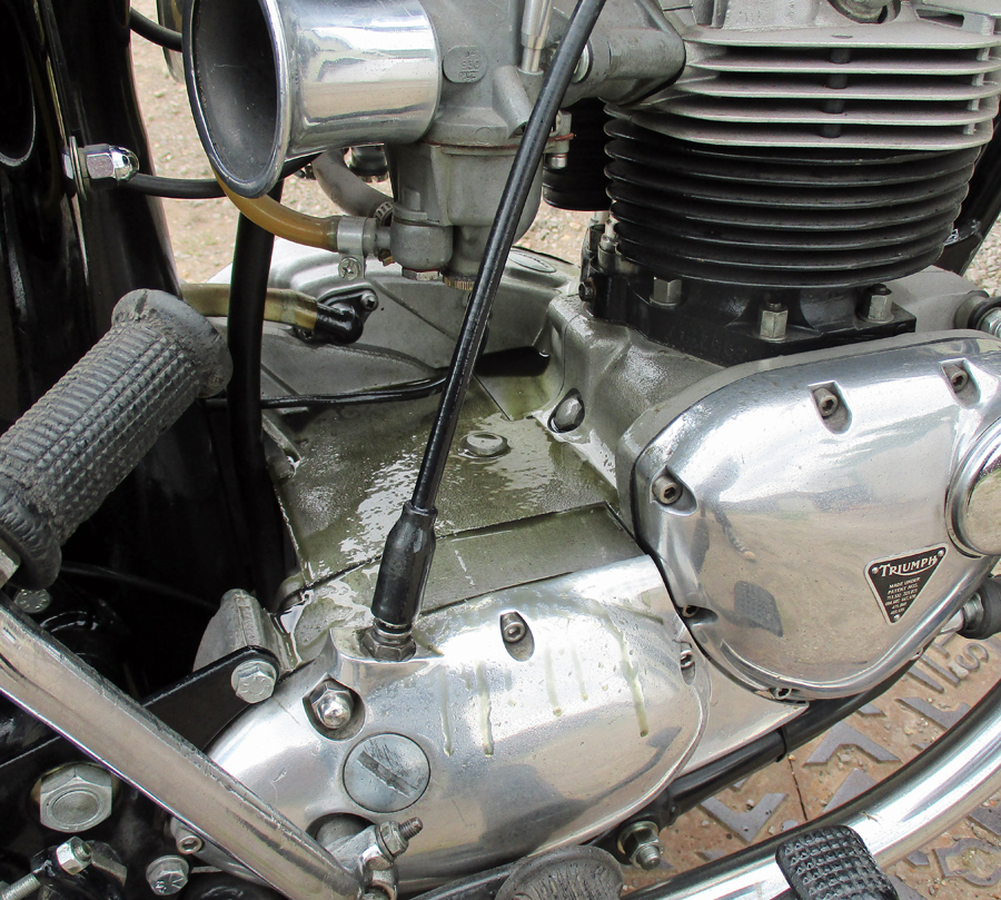

    Had to use the heat gun to get the tappets covers, rocker boxes etc off as there's a good coat of wellseal on all the gaskets. If you use wellseal just be aware that it not only sticks the gasket in place, it also sticks everything together forever. So heat is required when removing, it then sticks to everything while its bloody hot!
    Ow, you bastard, try not to rub off or it'll take the skin with it. So, the inside of the engine is luvly, everything is new, spotless and looks to be a proper job, phew. We'll leave that be then.

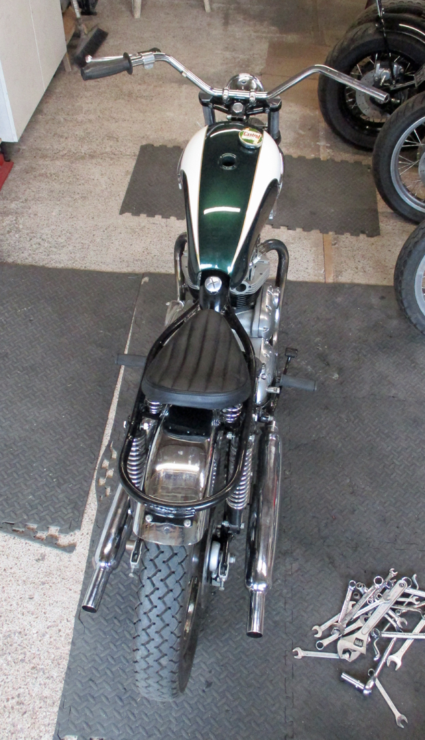

    I've always quite liked the flat tracker look and I think I'm gonna stick with the bates seat and maybe add a pillion pad if I can find a small one. I like how the seat springs compliment the rear shock springs. I'm going to keep all the original hinges etc on the frame just in case a reversion is required because it is in really quite good condition. The silencers will need to be angled up a bit more. :)....over...

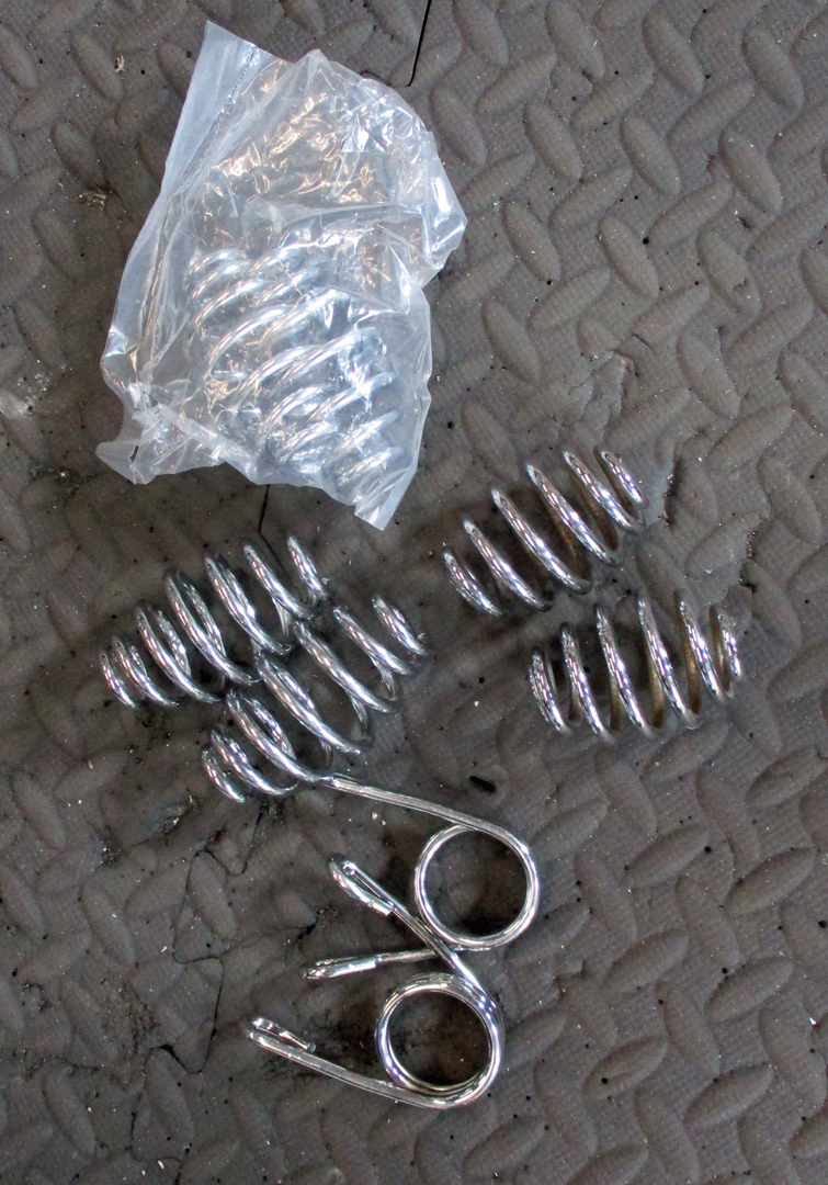

    Then I farted around trying to figure out how to fix the seat. Again, got a bit fixated going for springs on the bates seat. I have a few hanging around and tried them all doing little sketches etc. I eventually asked the cat - he had just about the same amount of ideas I was having....:neutral:
    So went in and ate some crisps, a couple of fried egg sandwiches and a large Yorkshire tea. Sorted. Bend and paint a bracket and bolt it on you tit, easy :)

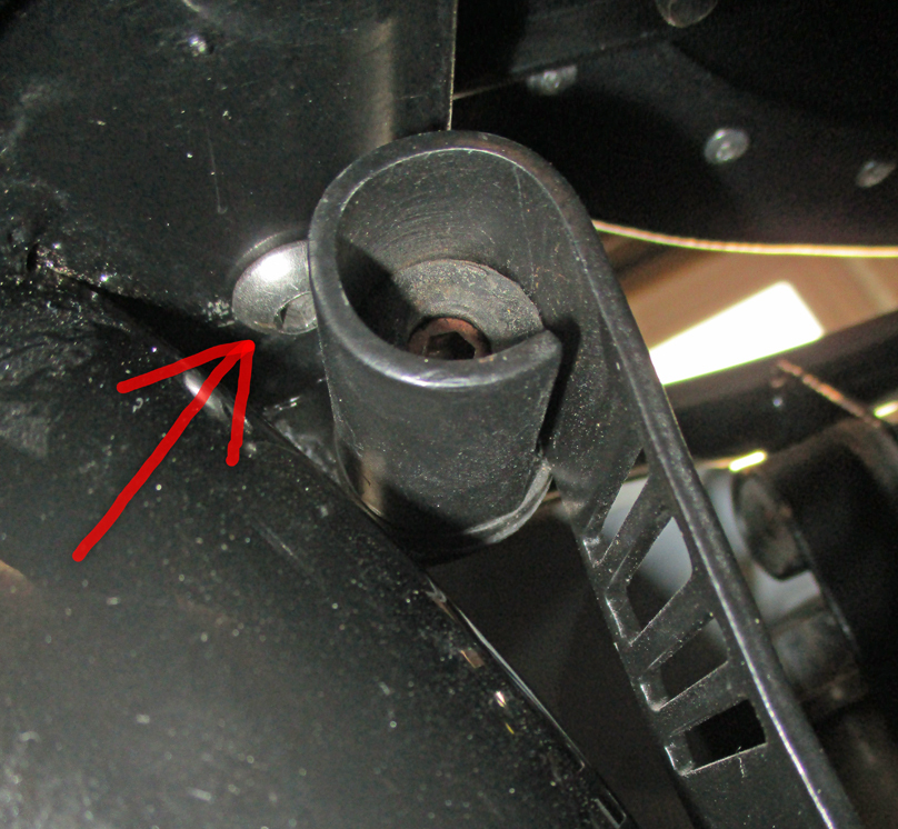

    I'm in! Sorted. I have had to put a dome nut (well a dome bolt, hopefully that still counts) onto the front of the seat hinge as there wasn't enough room for a normal one above the battery box rubber mount. Luckily I already had the special tool required to insert it. Here it is for those of you who don't know what's normally under the seat on a Bonny. It's the other end for the tools.
    Just been down the garage to get the photographic reaperconclussion evidence. Do I get a badge or something to show that I'm a member?

    And, that's about it. Number plate and bracket done, back light on, carbs and throttle (one of the slides was stuck with a varnish of dried petrol, just shows ya) clutch rod hardened with fire and clutch cable all on. A wee laddie could easily pull it now, clutch frees up on first kick.
    Awaiting Z1 brake master cylinder, hydraulic lines, speedo and sender and a pillion pad (jury is out over the seating arrangements)
    I've badly drawn a pad in on this one :rolleyes:
