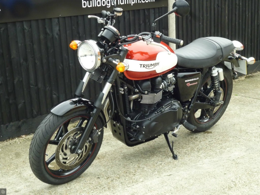

    So, the bike arrived yesterday and was wheeled straight in the garage.
    I've been out tonight to check it over and see what's what and also what's in the two boxes that came with it....

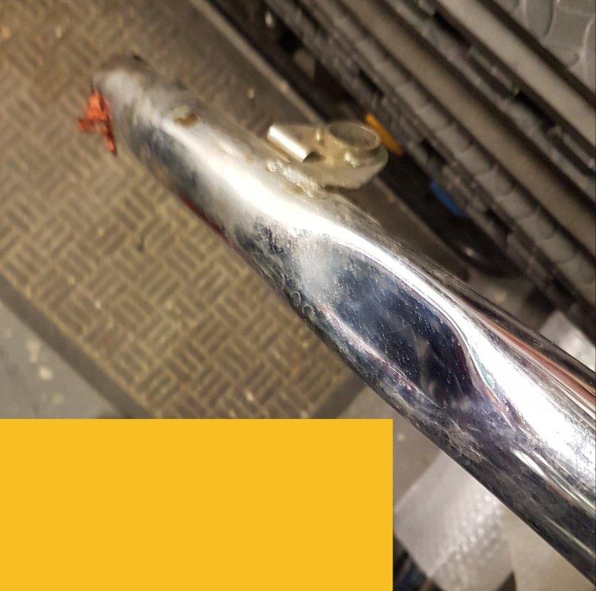

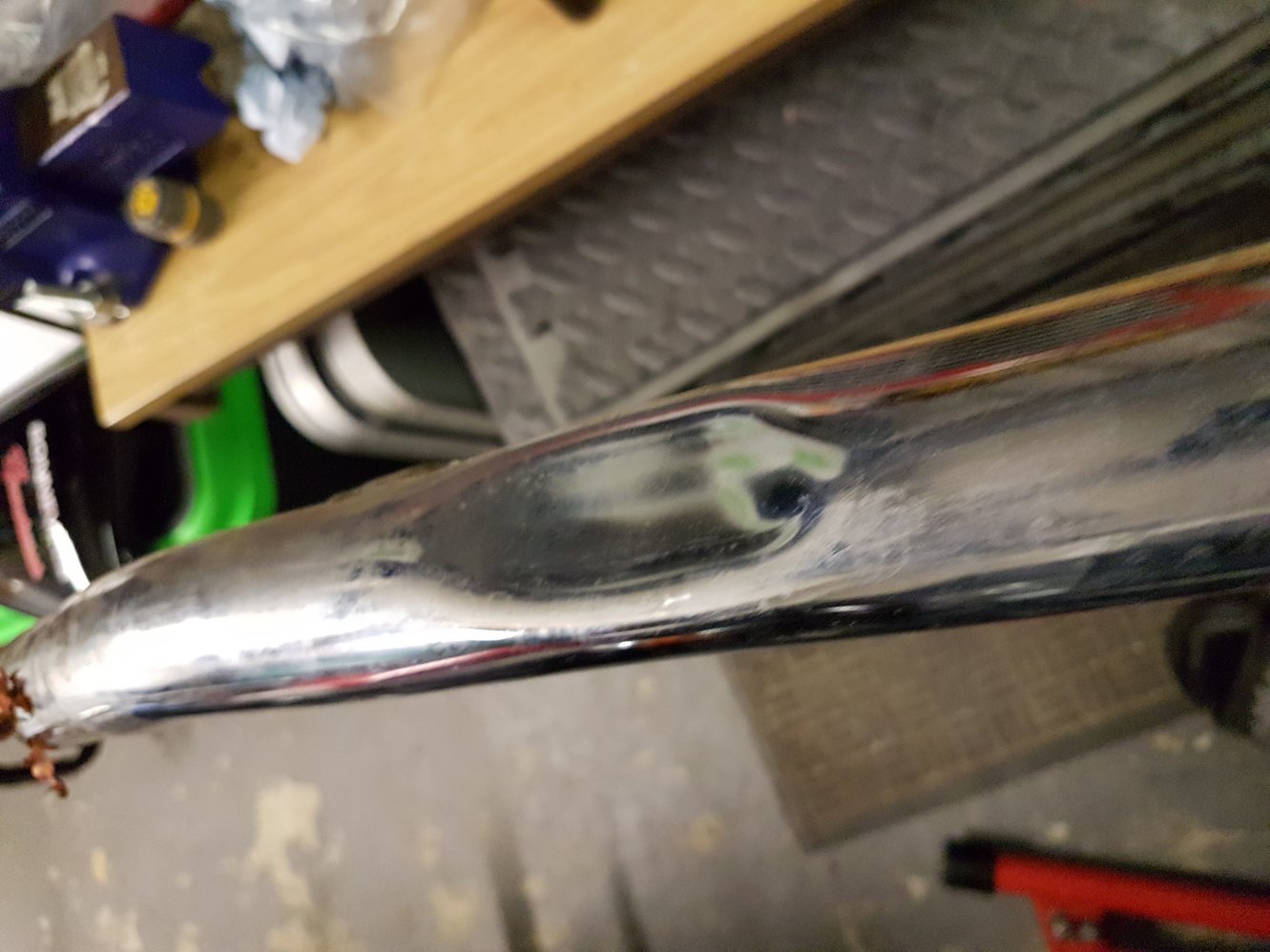

    So an easy question first.
    Should the left hand down pipe have a dent in it as per the pics ?

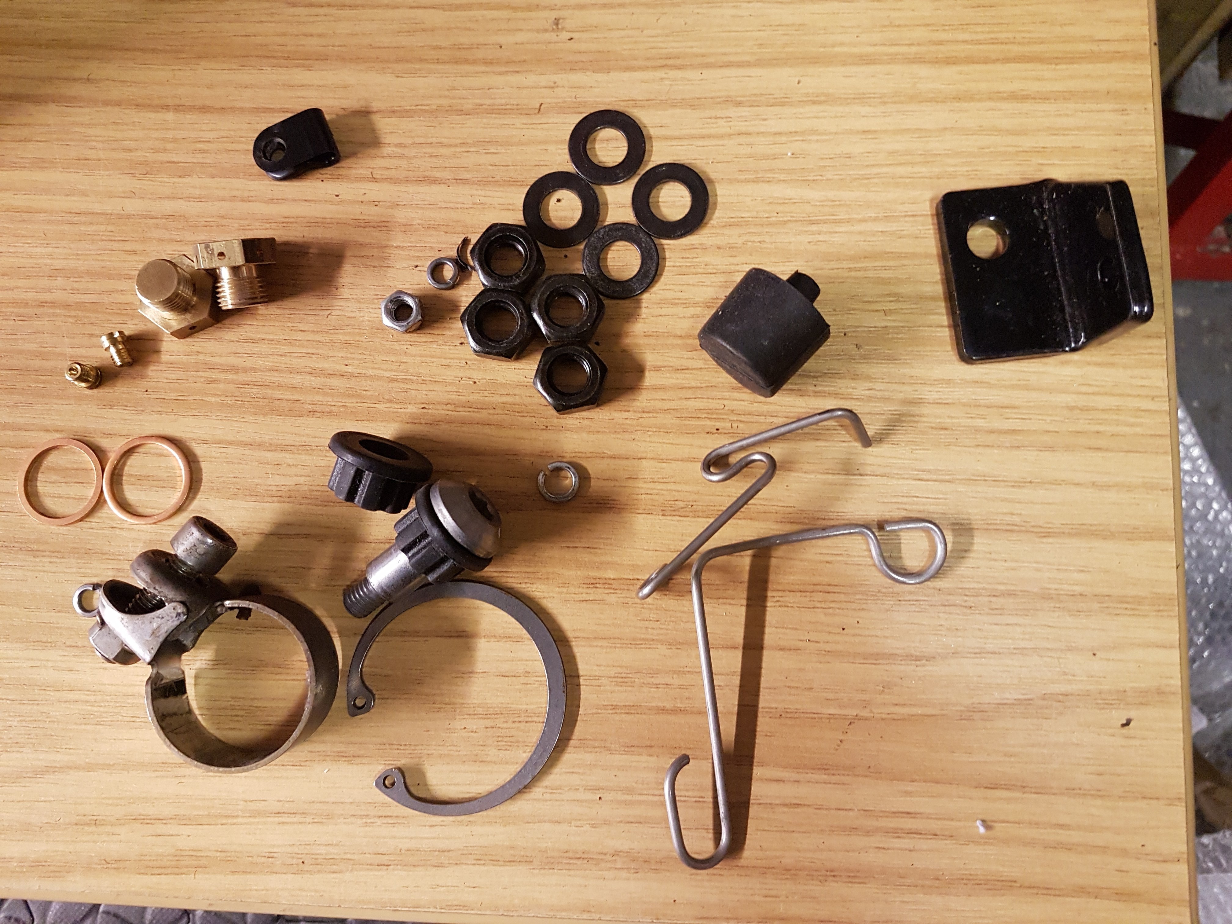

    Next question, a bit trickier I suspect...
    This is what came in the bag of bits.
    Some are obviously from the std system fittings (the bike came with an Arrow 2-1 fitted) but others I don't have a clue.
    i.e. what's the two, what look like carburettor, jets for ?

    Carb jets ??

    Nice bike Enjoy, I cant help with the bits,although I suspect the dent in the exhaust is intentional

    That's what they look like.

    I think so as well but wasn't sure.

    The large headed bolt with the larger rubber bush is for fitting the LHS std. end can. The TEC exhaust will almost certainly be using one on the RHS.
    The thick rubber bush with the 'tit' on the end is a bump stop the the side stand. The black support plate is to mount the bump stop.
    The round spring clip is to hold the baffle in the end can of the TEC system.

    I agree with biglad, most of the bits are related to the silencer which has been removed.
    The brass items must be carb related.
    'Dented' exhaust is clearance for the stand.

    Thanks for clearing up the downpipe dent question and what the ciclips for :)
    I have the baffle for the Arrow system but couldn't work out how it was kept in, any previous cans I had always used a bolt of some sort, so that's something learnt today.
    I suspected the unknown bits may be from something else altogether.
    As there's two of each of the brass bits, maybe the previous owner had a carb'd Bonnie before this one ?

    The larger than stock main jets were shipped with the Triumph off road silencers which were needed when fitted to carb bikes.
    The EFIs simply got a new tune.

    I did wonder if the previous owner might have had an carb'd Bonnie before, that would explain the jets then.

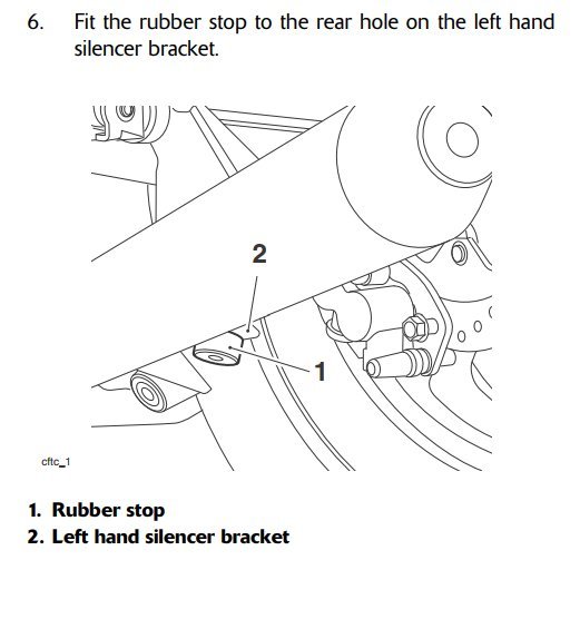

    Don't forget that you may have to fabricate a centre stand stop as they use the LH exhaust to mount the rubber bung (with a "tit" on it).

    The centre stand stop bracket is on the silencer, so I should be ok.
