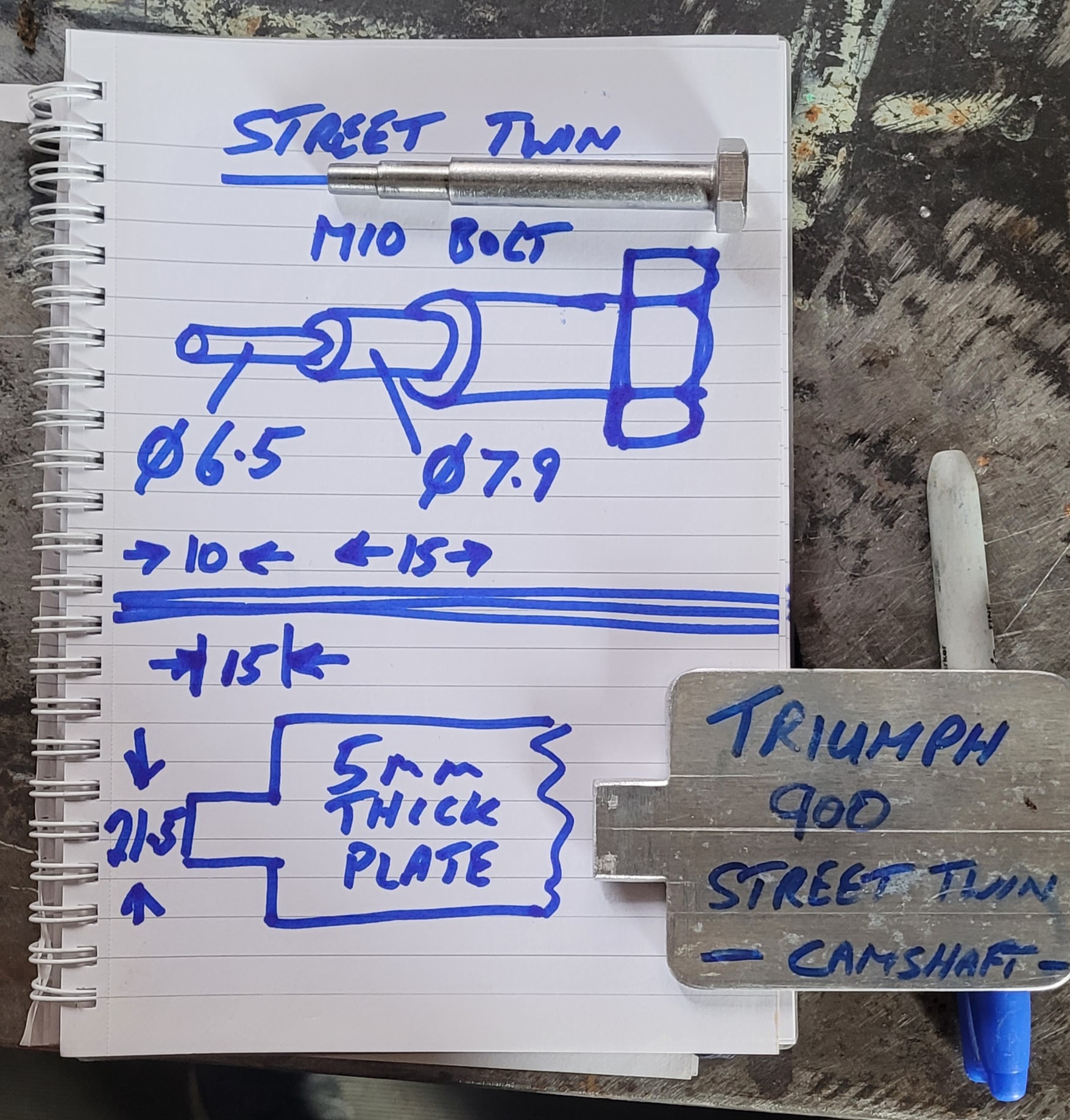

    Great that you made your own special tools and saved a fortune. The camshaft timing plate alone is a frightening £138 (World of Triumph).

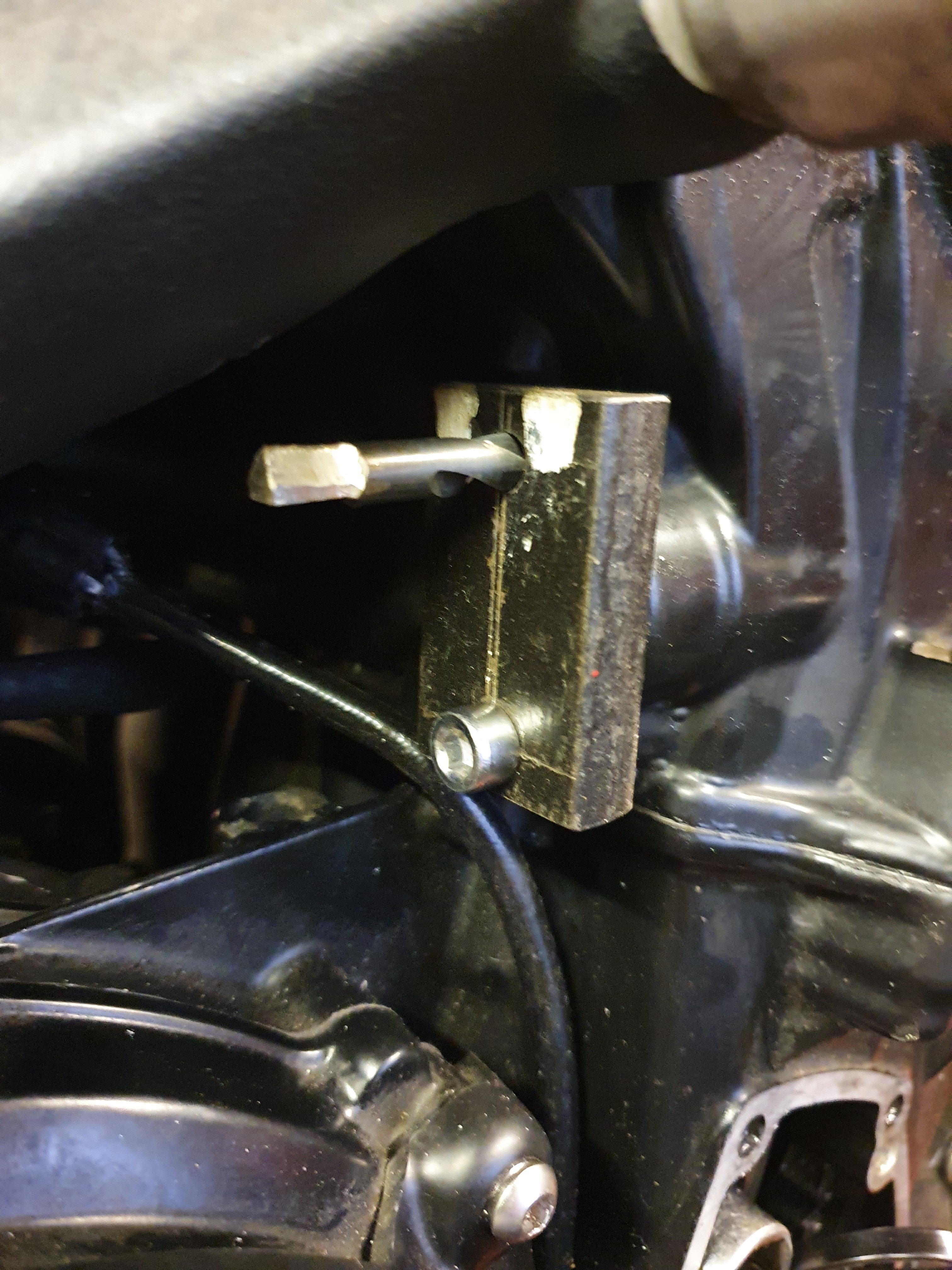

    The space, access etc. are to be admired. Take for example Triumphs own triples, access is tight in places ( see pic below). I needed to helicoil a street triple 675 head for the cam chain tensioner - Engine out would have been the dealer answer no doubt, or head off, with significant costs, yet with a few self created special tools, then it can be done in a couple of hours.
    Street twin tips.
    Use special pliers to remove petrol quick disconnect when removing the tank...... don't ask, easily cocked up and Triumph want £77 for the fuel pipe, no separate clips :joy:
    Easily sorted for £4 if you know where to look.
    Take your time and be careful with the injector plug disconnection, this is small, fiddly and awkward.
    Watch any chain tensioner reset clips intently.
    Use the two specialist tools and camchain timing is easy.

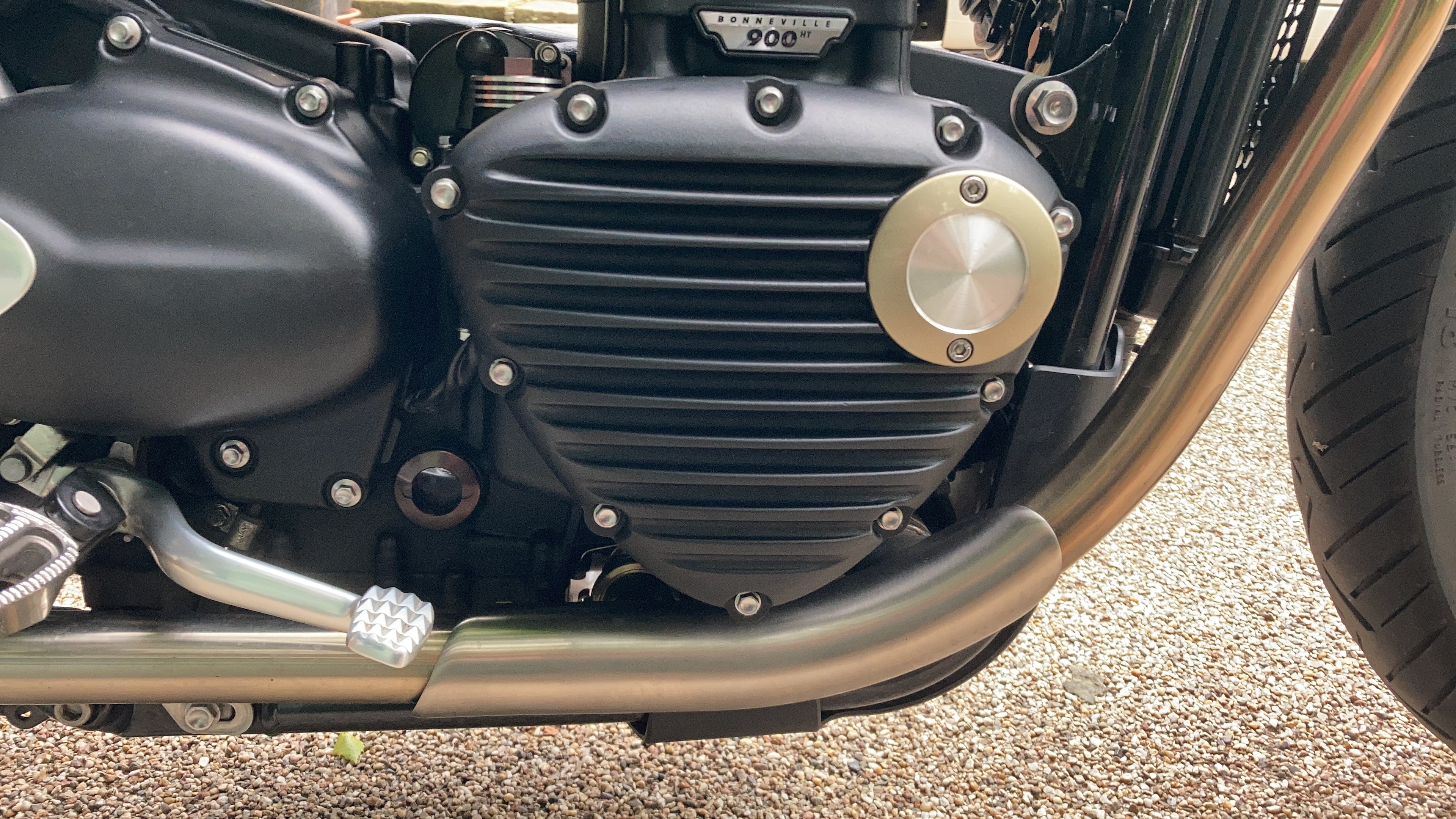

    Thought I'd show the Motone ribbed engine cover now fitted and you can just see the Motone footpeg which replaced the TEC pegs.

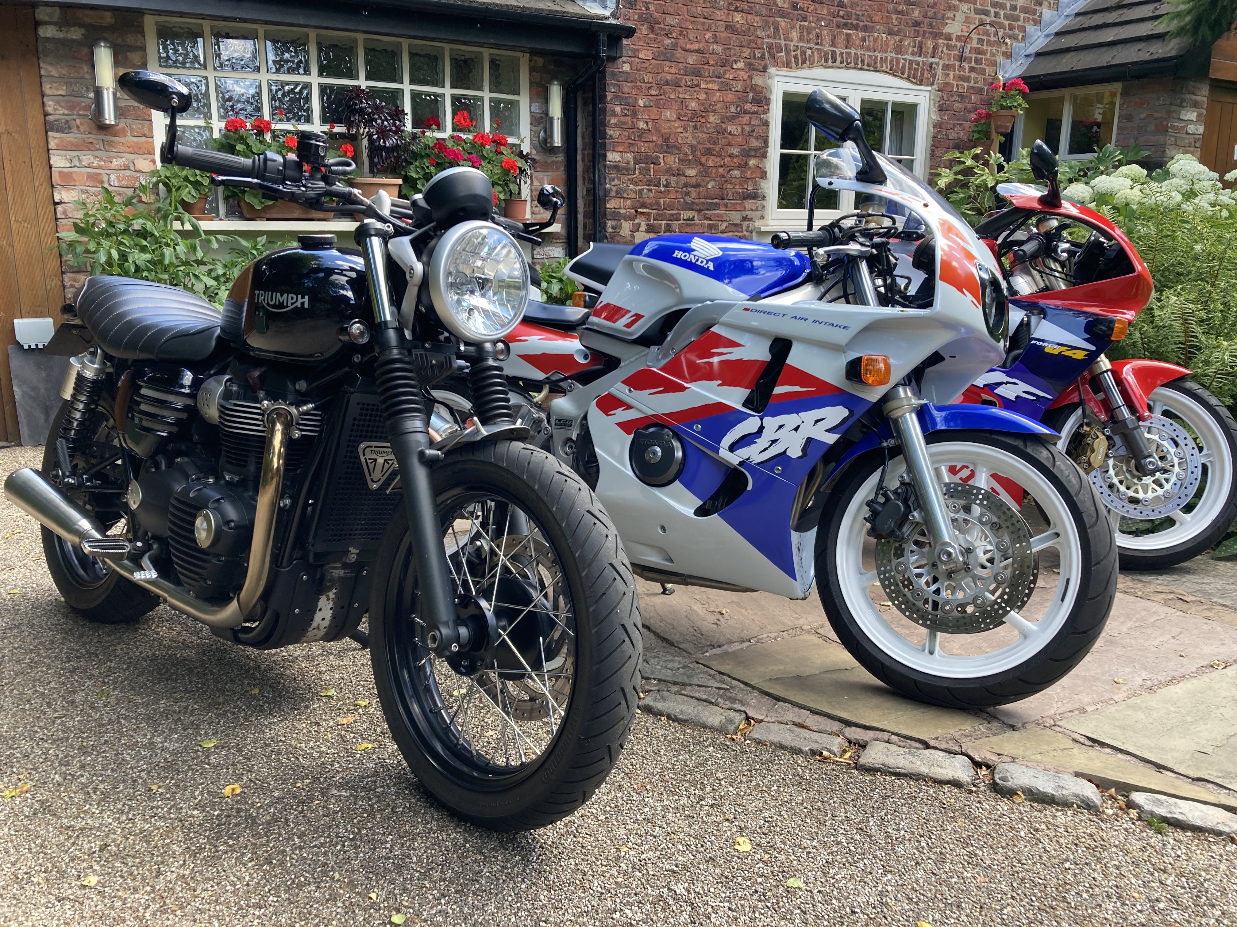

    This is how the ST looks today (headlight bezel soon to be changed). Note the battered bash plate. There are two of the 3 Hondas it shares the garage with.
