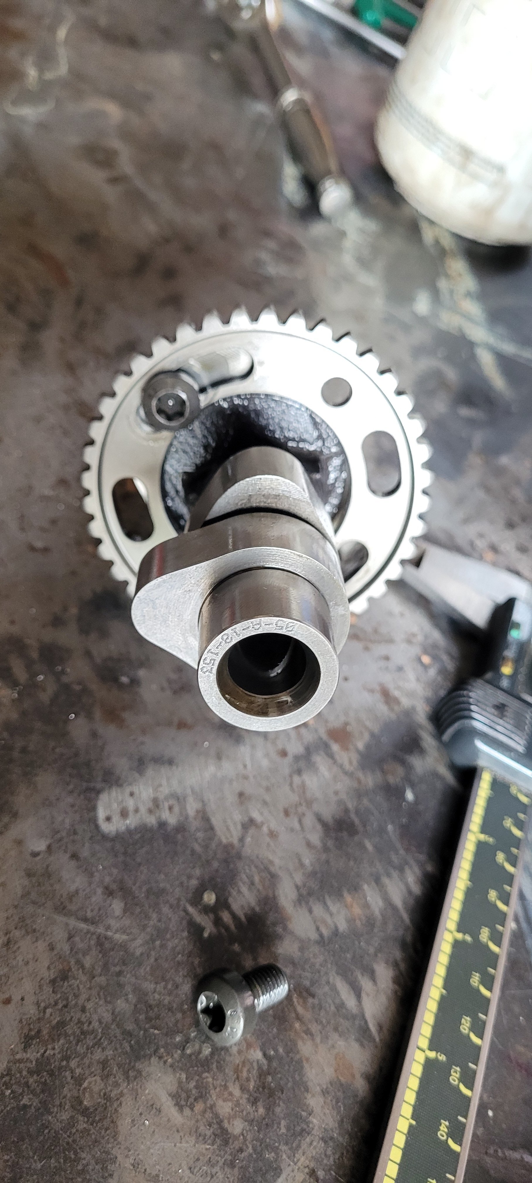

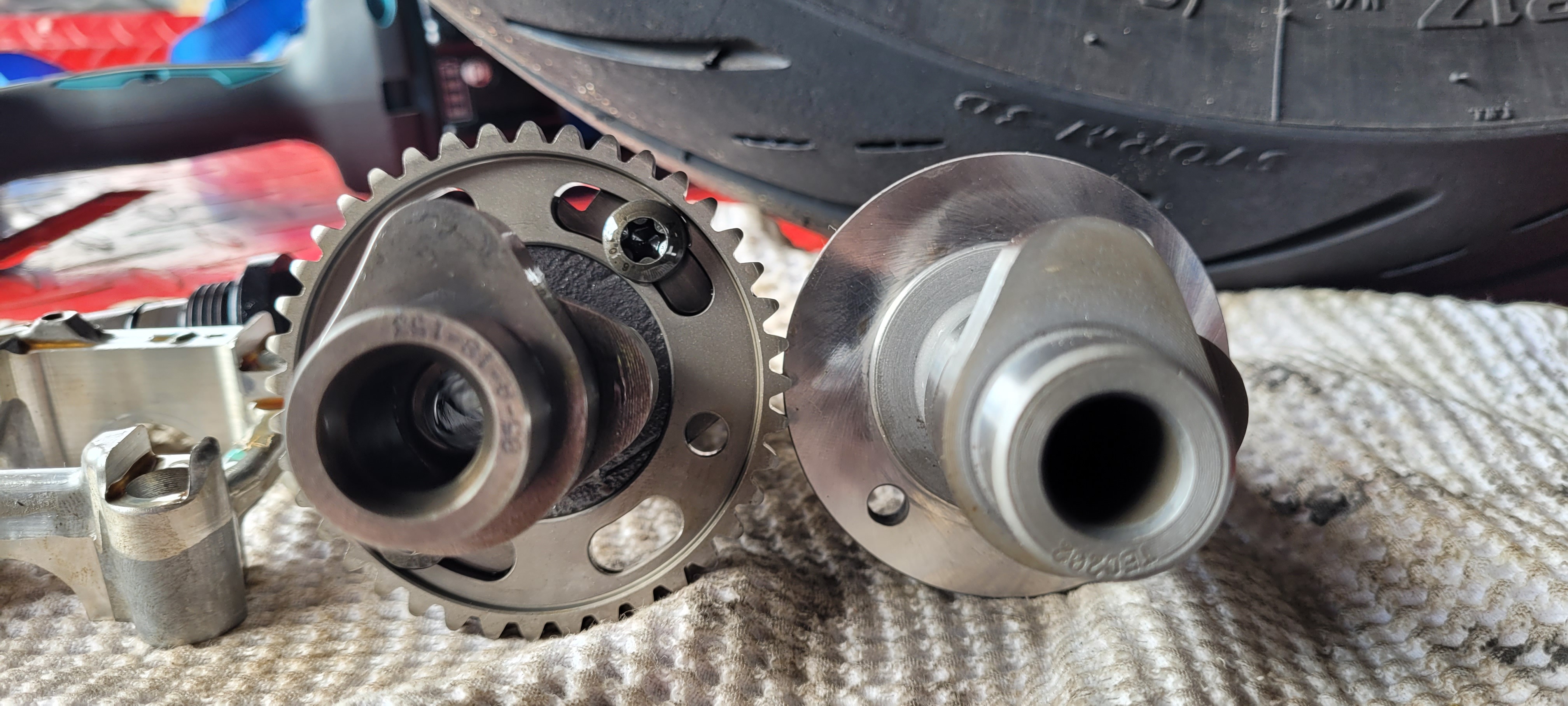

    The lobes were far fatter even just to the naked eye and, despite reading to the contrary online, lift was slightly increased +1.6 mm inlet and +0.7mm exhaust.
    The torx bolt (x2) as seen on the table (original cam shown), are supposed to be replaced so I duly purchased new ones for the minimal cost, although I don't see why, if adequately cleaned with cleaner and new threadlock applied, the old ones couldn't be reused especially as they are only torqued to 22 nm so hardly stretching them.
    TEC have a very good Youtube video which is an ideal reference resource, including torque settings, even if you have no other access to any information.

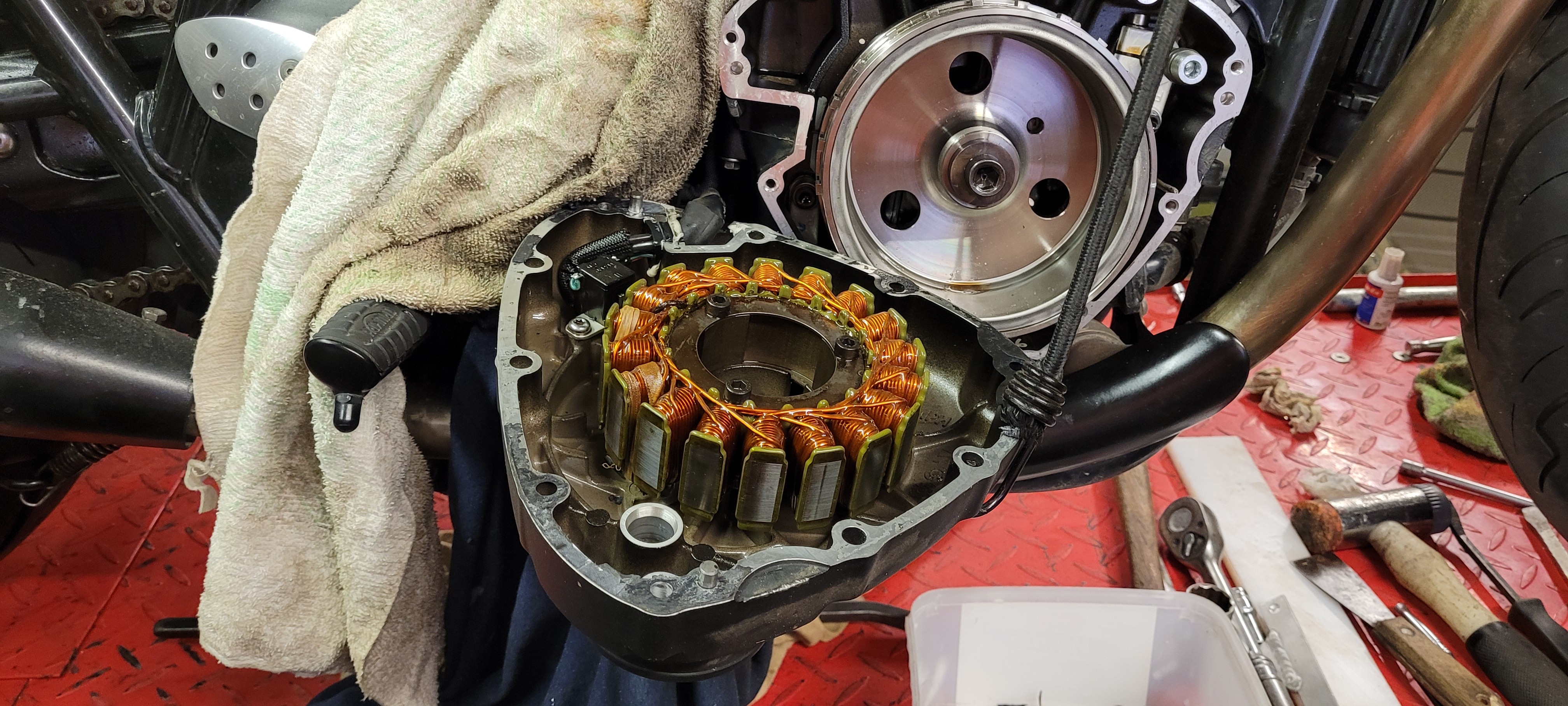

    The engine had done 7800 miles or so before the cam change and x2 inlet valve clearances, although in spec, were a little near the tight end.
    New shims and alternator cover gasket acquired and valve clearances now all brought nicely into the top third of the specification clearances.
    That cover was very hard to remove and the gasket was sticking to the casings like the proverbial to a blanket. Once ready to rebuild then patience and care was required to slowly but surely get the gasket off both faces. Sorted.

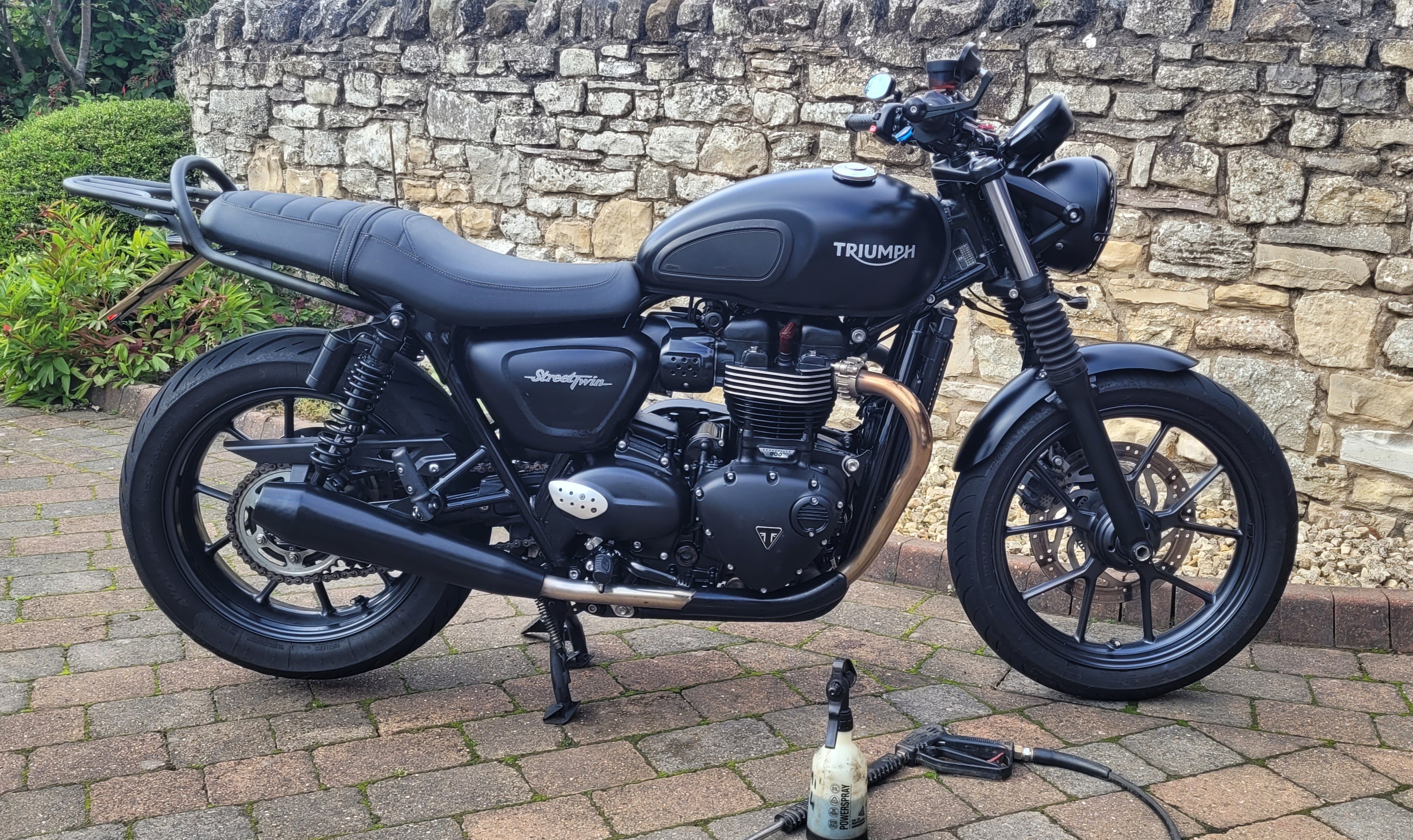

    So, was it worth it, and what does it do?
    I'll do it bullet point style for easier reading;
    The starting and tickover has not changed. No excessive cranking or any magic tricks required.
    Pulling power, torque, from a standing start feels little different and two's up with a little clutch, will pull out of rolling Give Way's in 2nd.
    Acceleration- now this is where things change. The gears have more length/time in them before it feels natural to change up. Previously, bearing in mind there's no rev counter, the natural gearchange points were about 30, 50, 70 mph respectively. Obviously, the engine revved above these self imposed artificial thresholds but it seemed pointless as it turned into a gutless wonder: asthmatic. Overtaking was, at times, awkward as the motor soon run out of puff despite a promising start; do you pull out and change soon after or do you change up and slug it?
    Is it now a rocket ship or does it now have a two stroke style power band ?
    No. But it is a nicer ride.
    Fuel economy previously was running about 55 mpg. Our day out today, two's up, returned a dash figure of 59 mpg despite using more revs than previously.
    In conclusion I would summarise by saying, each gear has another 20 mph of usable productive revs without hitting the rev limiter if you so wanted it. It no longer has that noise where its trying to consume (suck in) its own airbox for very little progress. Generally, it just makes the bike a nicer, more rewarding ride.
    Would I recommend it?
    Yes!
    Total cost?
    Around £390 self fitted.
    Any thoughts or questions?
    Does it look any different, no, but it sure is now a better ride.

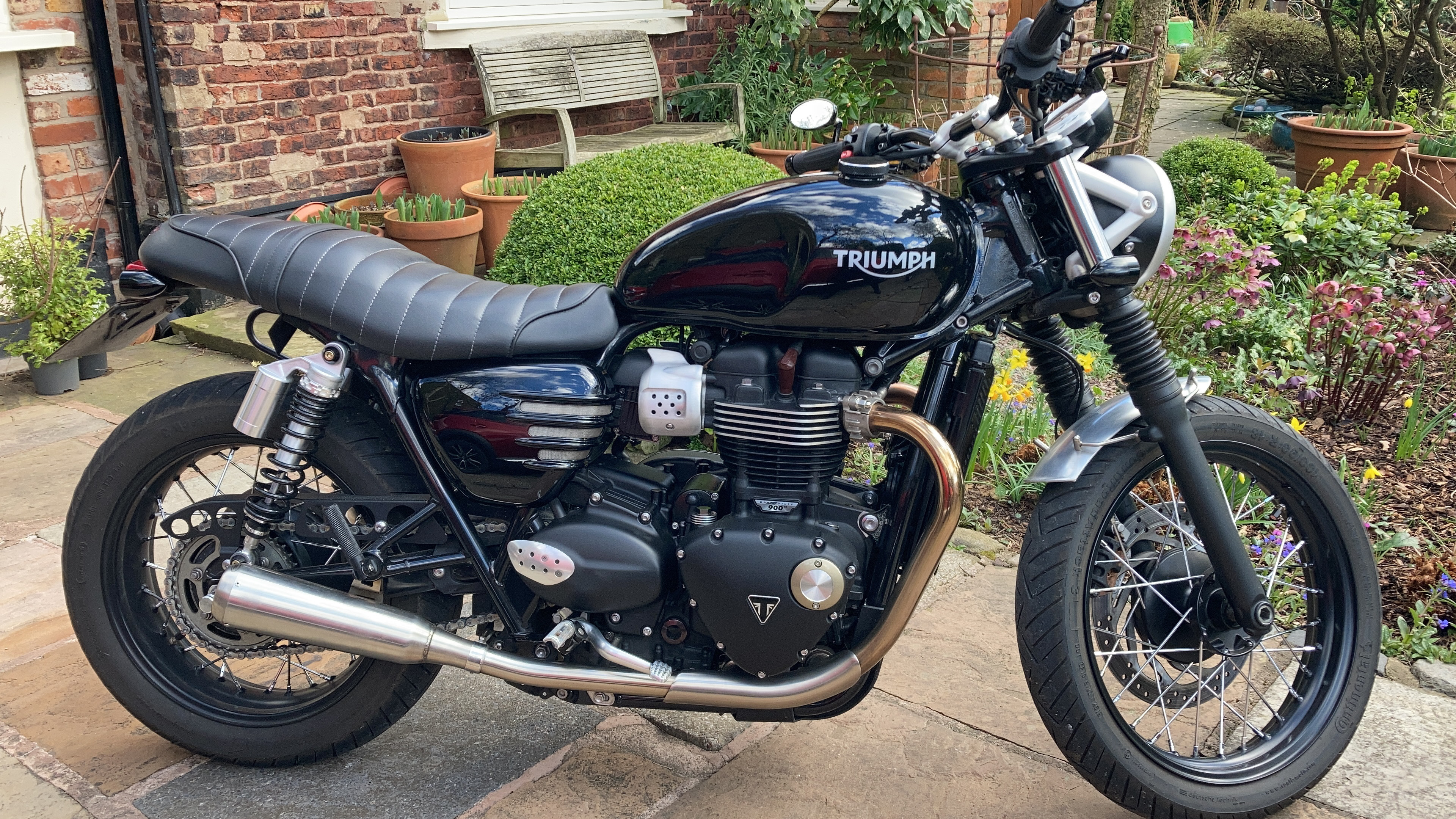

    I posted somewhere on this forum about the TEC camshaft fitted to my Street Twin a couple of years ago (or maybe 3 or more..time flies and all that). No doubt if you do the Search Forum thing it'll pop up.
    Mine is a 2017 ST, bought new. I liked the bike but it had 3 or 4 weak points, all of which have been well documented on here, appalling tyres (bordering on dangerous), under-damped rear shocks (which affected handling), only adequate braking (two front disks or upgraded calliper are needed to safely stop a 220kg bike from 90+mph) and the engine ran out of steam too early.
    I sorted the first two problems within the first month and I guess I just got used to the iffy brakes. As we know Triumph have since addressed the brake issue.
    Engine performance has also been discussed on here. Basically, the original ST engine was deliberately under-developed by Triumph and held back at around 54-55bhp, so as not to deter sales from the T120 and it's 70-ish horses. Again, Triumph have rectified this issue. But as I have the pre-Triumph-doing-what-they-should've-done bike, I went for the TEC cam.
    The bike had done somewhere between 1000-1500 mile (I think) when Youles in Manchester fitted it. Mine was their 3rd TEC camshaft upgrade.
    I won't repeat all the details I wrote last time but I noticed the difference as soon as I rode out of Youles carpark. The engine felt more willing and the revs picked up more quickly, acceleration was more brisk. And as Eldon has pointed out, overtakes are easier, the power doesn't tail off as quickly as it did before. My brother owns a T120 and although my ST still can't quite match his on motorways, when it comes to the twisty stuff I'm always ahead. With the suspension upgrade the ST is a better handling bike than the T120 anyway, but the additional power makes it, for me, a superior bike (if you're 6'5" and weigh 18 stone it probably won't be).
    My bike also has a Motone X-pipe and TEC end cans. According to George Milburn at TEC, my bike should have around 65-68bhp, but I've never had it dynoed and I don't care anyway. It's a better bike all round than the one I purchased back in 2017. It's taken me all over, including 2021 miles doing the Malle Rally (google it).
    Of all the mods I've made to this bike the TEC cam is easily the best and at 7500 miles there have been no problems.

    #11 beerkat, Aug 7, 2023
    Since that pic was taken it now has a Motone ribbed engine case (right side only atm) and the Triumph black'n'ally headlight bezel. Oh, and the neat and discrete Motone grab rail.
    Also the TEC footpegs in that pic have now been swopped for the much nicer Motone pegs. Yes, I'm a Motone fan!
