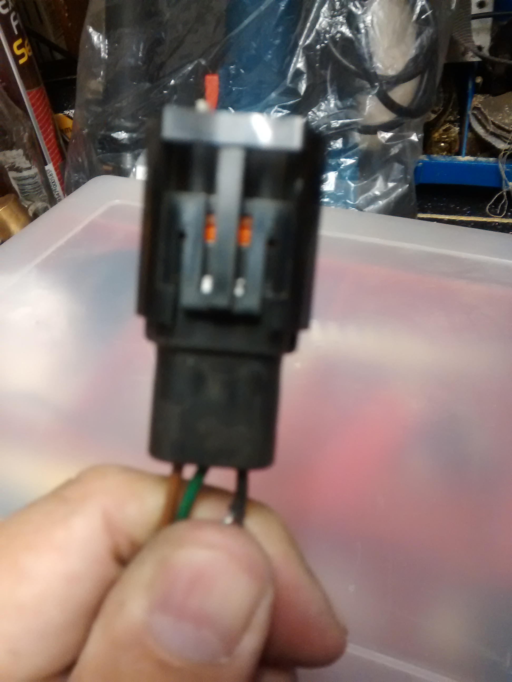

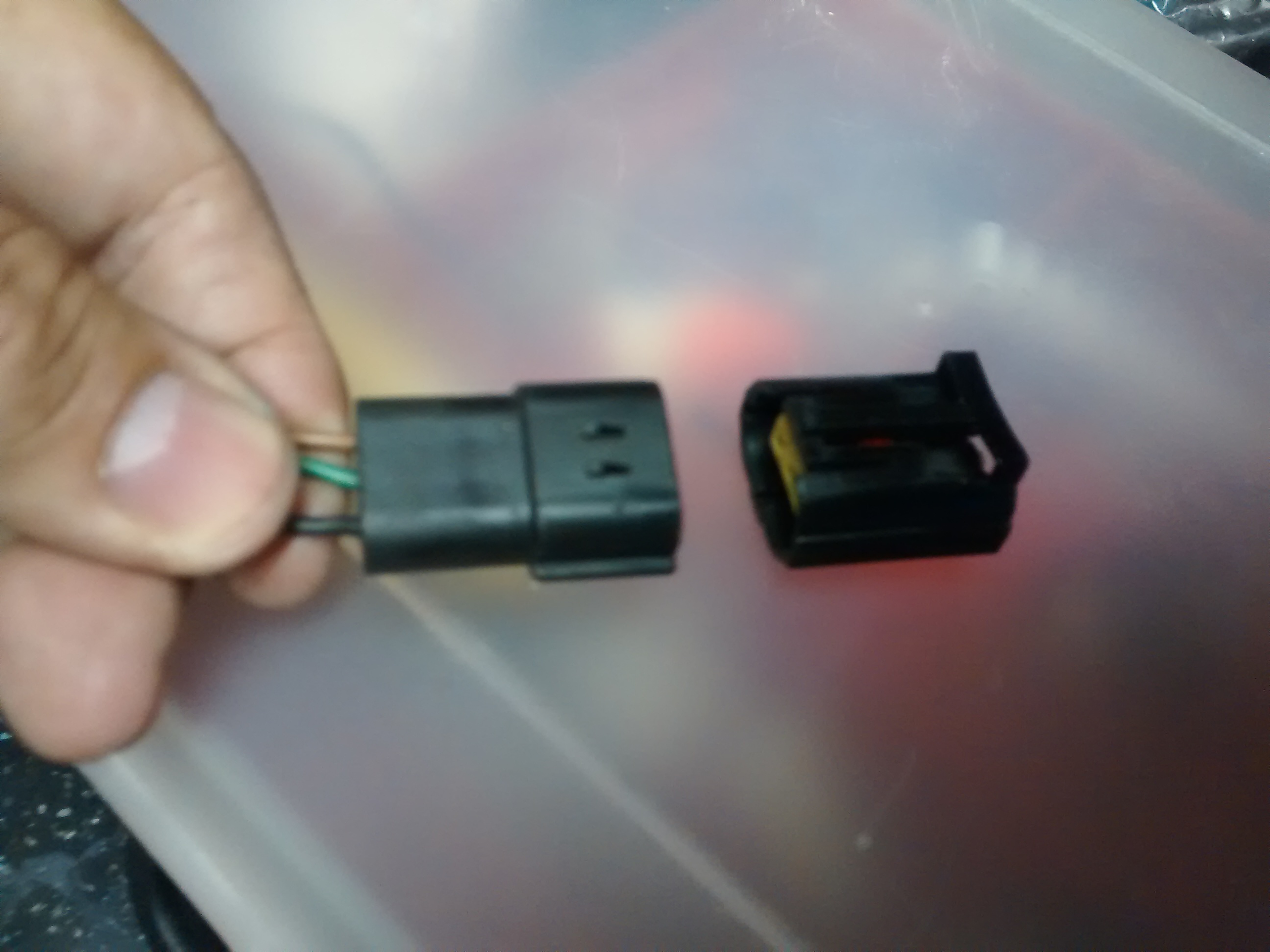

    hi, i have taken my side stand sensor off and need to know how to over ride it.?? when i put the bike in gear it just cuts out. please help..thanks
  2. punchy
    punchy Member
    Sep 11, 2016
    lancashire
    Hi, which 2 wires, i have 3, blackn yellow, green and a brown . Ive tried all combinations of taping them up but still won't let me get a gear ...any ideas please . ..

    Hi, so if i cut the black/yellow wire and cut the grey wire, join them, would that do it ?

    Hi, well i cut and joined the 2 wires and guess what . . .it still cuts out when i put it in gear . . Cant think what the fix can be . . Help

    I just tried it not wired together n got the same . .

    Cant see anything else, wires just go back into loom . .

    Sounds like a problem further up the loom, can you test the continuity of the wires, from sidestand switch back to source?
    You got a multimeter to test?
    If pulling the switch and permenantly wiring them together doesn't work, sounds to me like a break in the wiring further up the supply / return.
    Just a guess.

    Cant see anything else, wires just go back into loom . . . Ive just been trying different things, seems theres no power in the grey cable ? Lets me start it, runs no problem . . Tap into gear and it cuts out . ..the main fuses are ok, is there another fuse anywhere that could be causing the cut out . . Help . .
  16. MrOrange
    There will be no power, from the look of the wiring diagram, it looks like the switch provides an earth back to the ignition.
    If wiring has broken between the switch and the ignition, or switch to earth, then bike will cut out? Just best guess.
    Are you able to check continuity?
