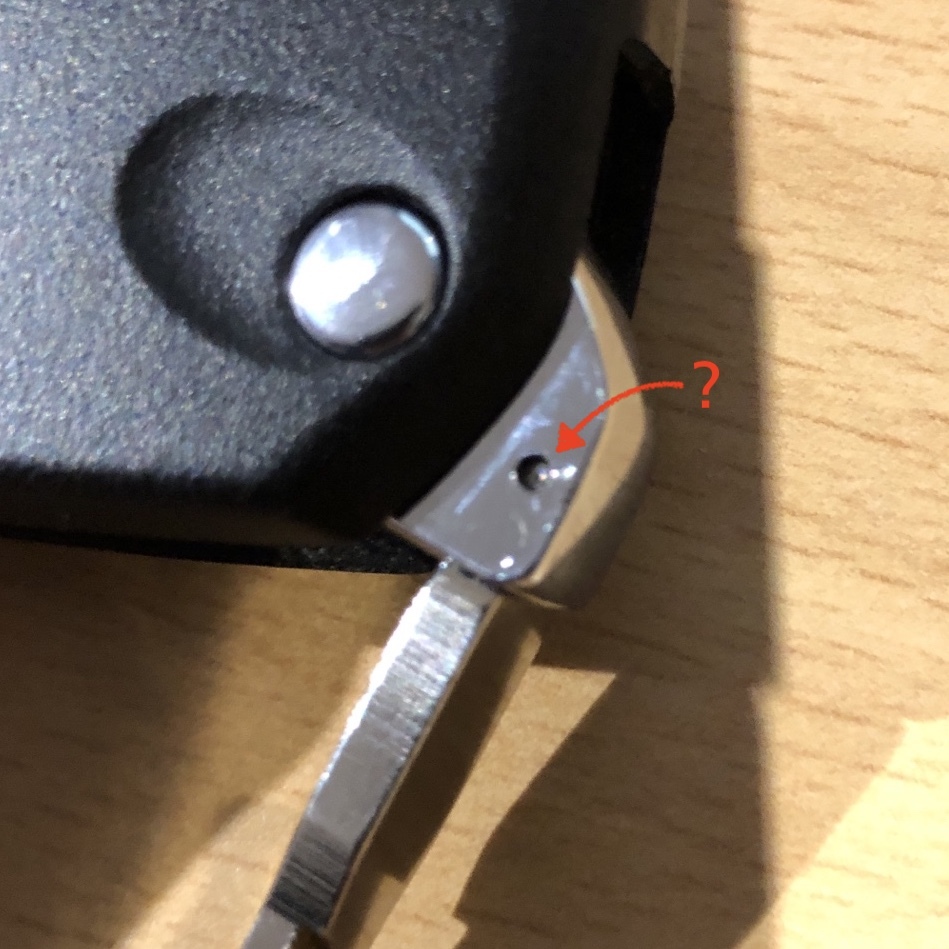

    I took the battery cover off to have a look (1.5mm hex key) and then removed three torx screws (microtorx 0.6) and the battery, but it makes a 'glue unsticking' sound as you prize it apart from the keyring end...and the key blade end doesn't budge a millimetre. Got scared and put it back together o_O

    Alternatively, you can probably knock the pin out with an old drill bit and a hammer...but I'm definitely not trying that.
