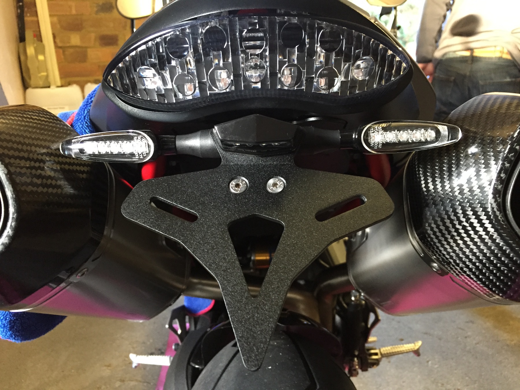

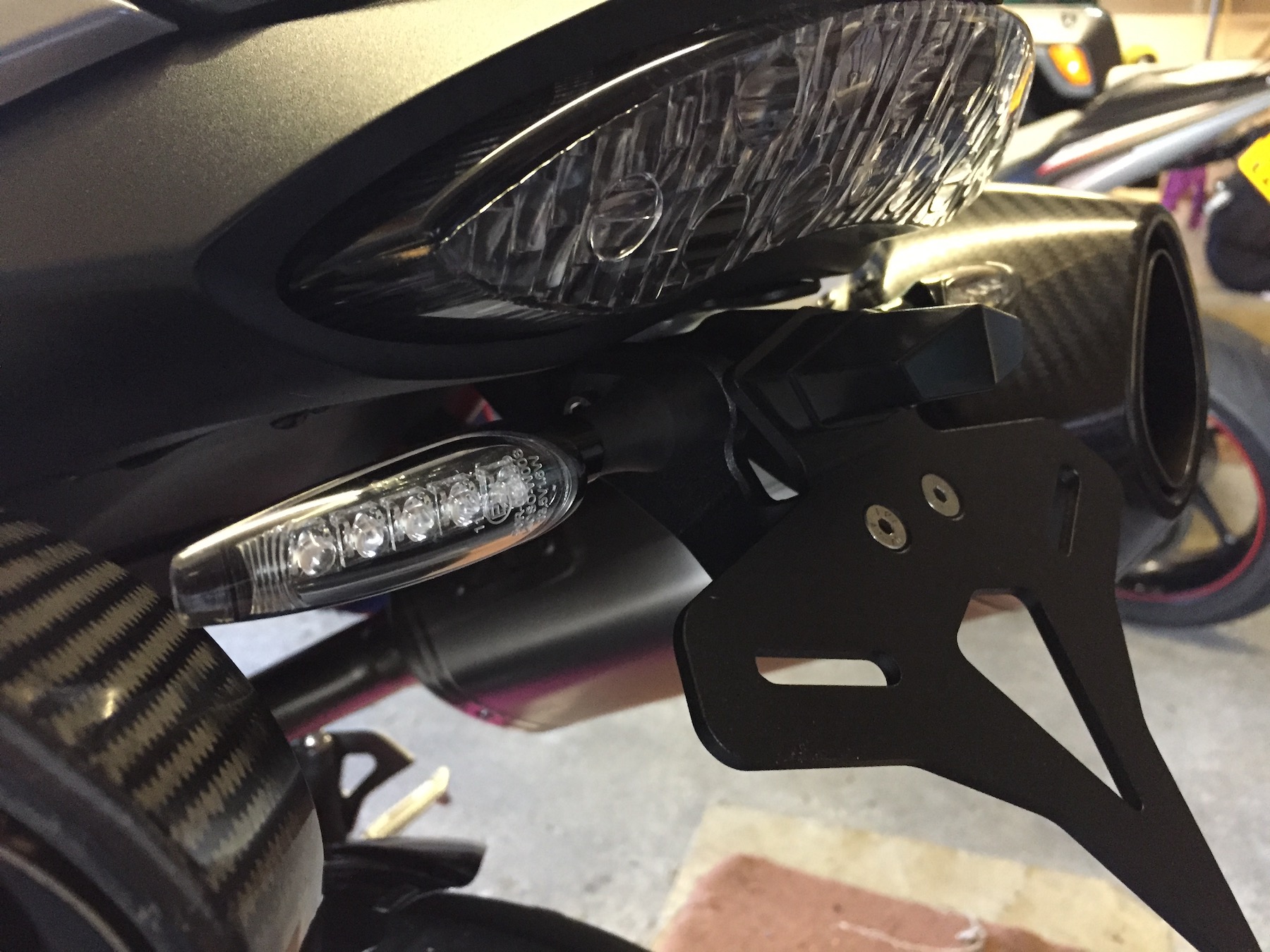

    Thanks gents. I was able to get under the spring clips using a razor blade and then work them off the rest of the way with a flat head screw driver.
    The final part of the puzzle concerns the license plate lamp. For some reason the wires leading from the lamp in my kit are bare - unsure whether this is intentional or just missed by the manufacturer.
    I'm left with the adapter seen below which looks to take a pair of plugs - am I likely to find these at an electronics store? Or can I buy one of the black plugs instead (presumably I'll need a crimping tool to go with it).
    Many thanks,
    David

    I can only assume it's been missed when manufacturing, as mine have bullet connectors on, you could just solder the wires together or look on ebay for some bullet connectors, saying that I'm sure you local bike shop would have a couple knocking about.
  3. ScreaminWargasm
    Feb 25, 2017
    31
    In the pack should be 2x bullet connectors that you need to crimp on to the bare wires.
    Funny enough, my came exactly the same I.e they didn't send them!
    I emailed Evotech who apologised and sent them out a few days later so it's obviously an issue when they pack up the components for dispatch.
    You can get the connectors at pretty much any DIY store but shouldn't have to.
    When you have them just crimp them on and push them together.
    Mick
  4. Base
    Base Member
    Jan 12, 2017
    35
    I would of suggested contacting evotech but as David is in Oz it has to be easier to get the parts local to him, always bloody annoying when something should be straight forward!
  5. Appoooh
    Appoooh New Member
    Apr 20, 2017
    9
    Sydney Australia
    I was able to source the bullet connectors from Jaycar which is a local electronics hobbyist store. They didn't have the crimp type so I soldered them - all up a bit more work than I'd anticipated but very happy with the result!

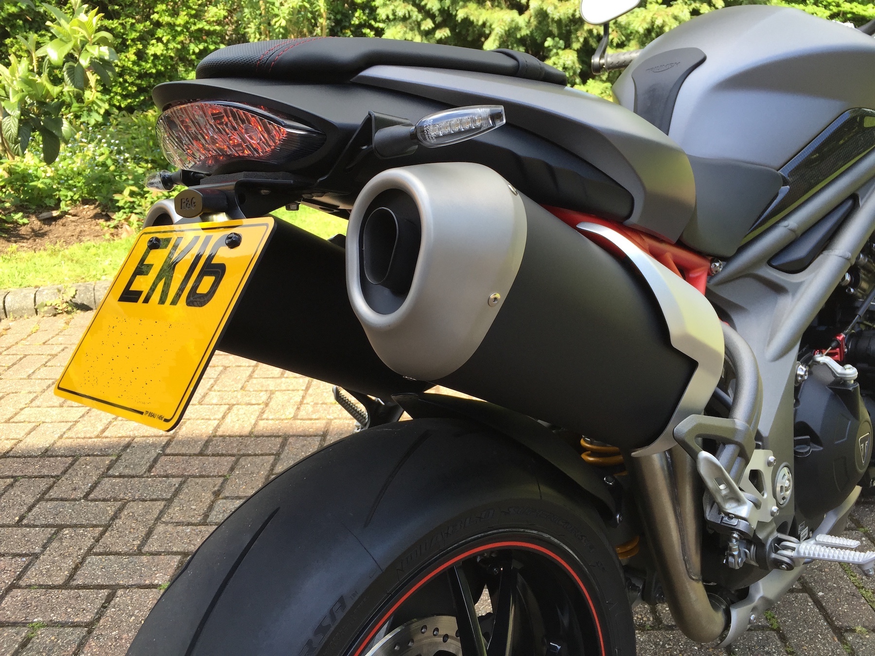

  12. jonesy
    jonesy Active Member
    Mar 26, 2016
    84
    worcestershire
    6x4 show plate

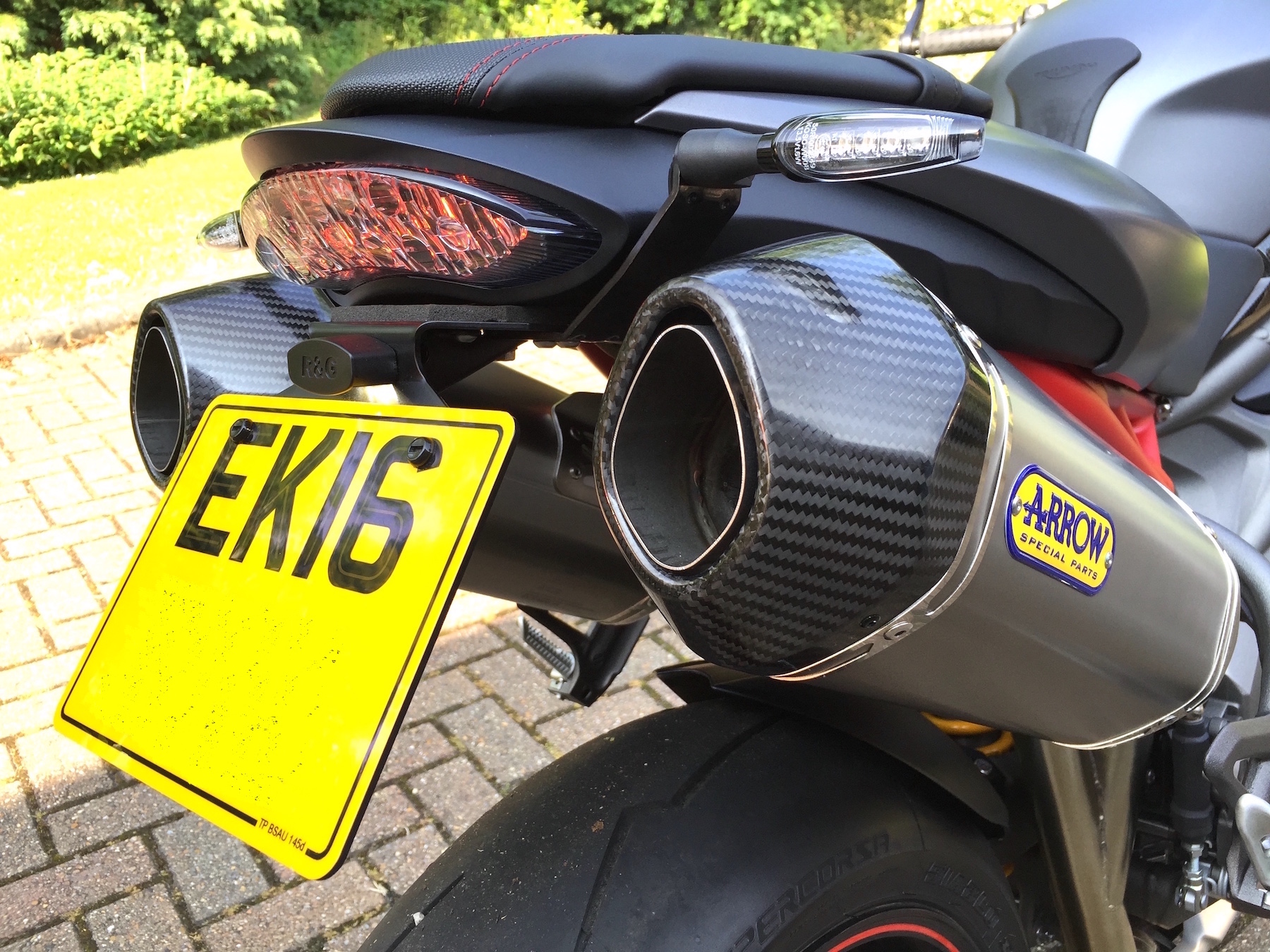

  13. Glenn Lewin
    Glenn Lewin New Member
    Jan 7, 2018
    Leicester
    Hi Jonesy. I'm trying to fit the same tail tidy you have on your bike. Am I right in thinking the OM indicators wont fit with arrow cans. Yours look different? If this is the case, have you any suggestions where I can get the indicators from. Thanks.

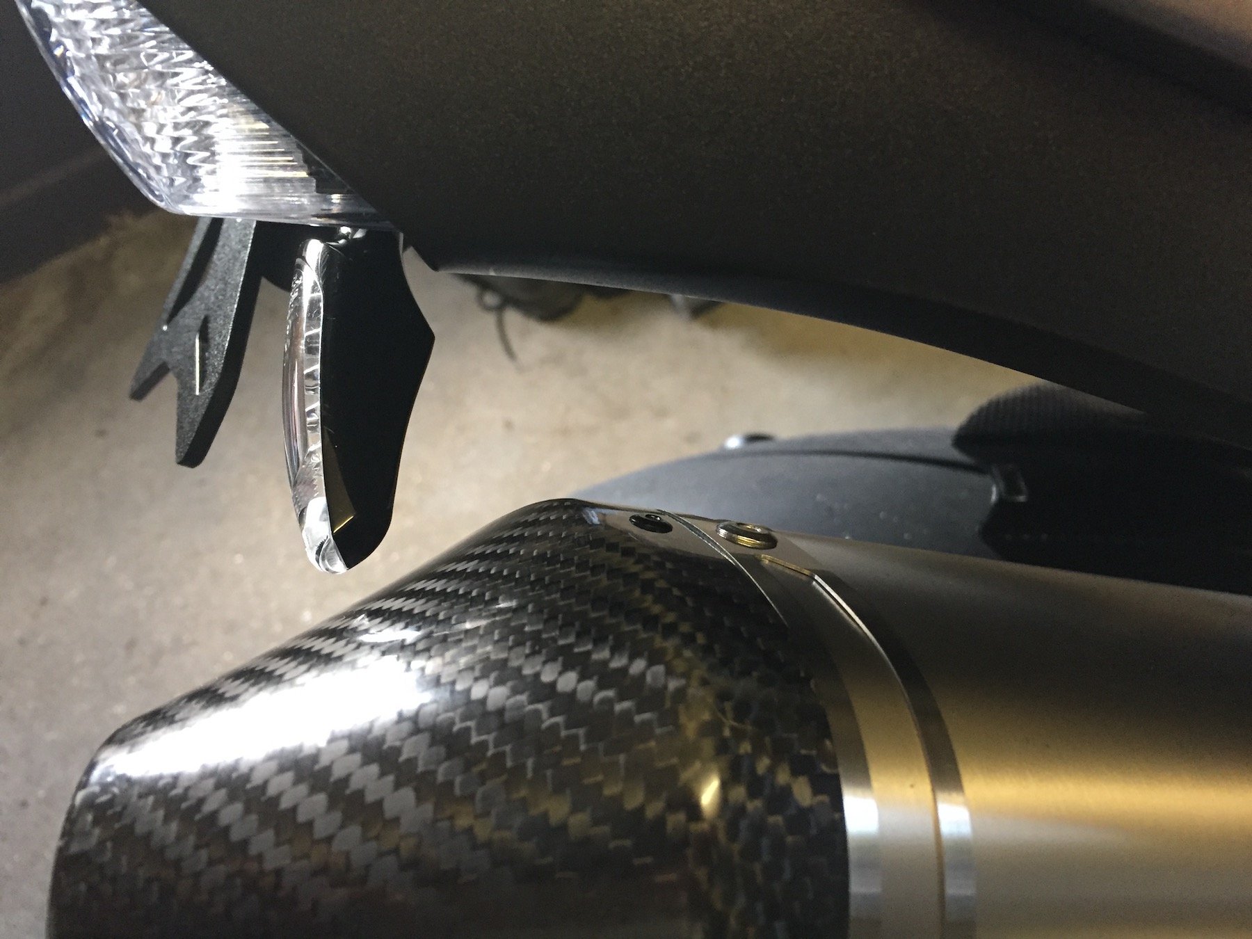

    Excuse me for jumping in.
    If your fitting Arrows and Evotech tail tidy, the standard indicators will fit.
    I did have to give the mount bracket on the exhaust, a little bend (only a bit) coz the exhaust was almost touching indicators.
  15. jonesy
    Mar 26, 2016
    84
    worcestershire
    They are the standard indicators. Everything lines up perfectly straight out the box
  16. Bomber
    Bomber Member
    Aug 4, 2017
    5
    London
    What size is your reg plate, it looks spot on for the arrows and evo tech
