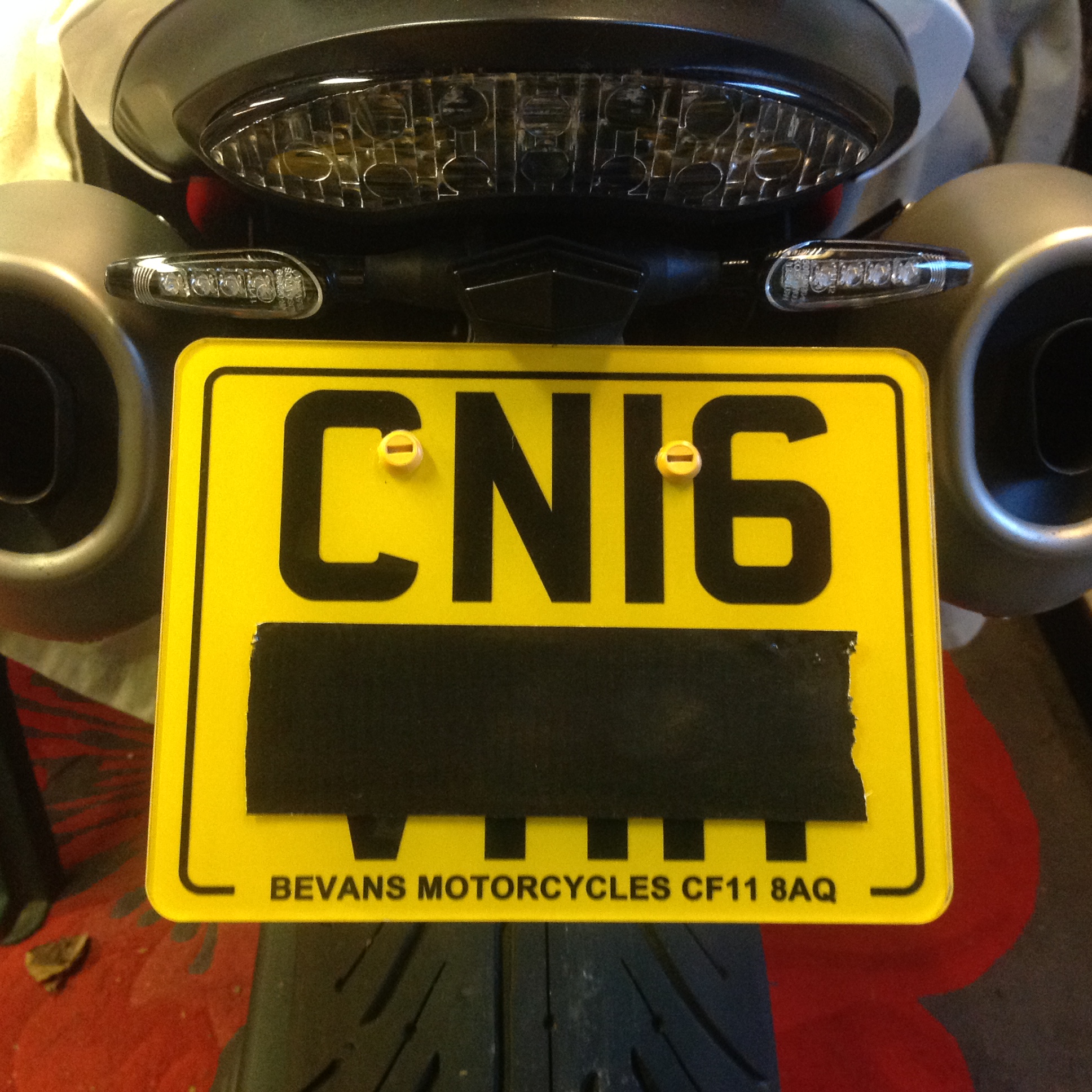

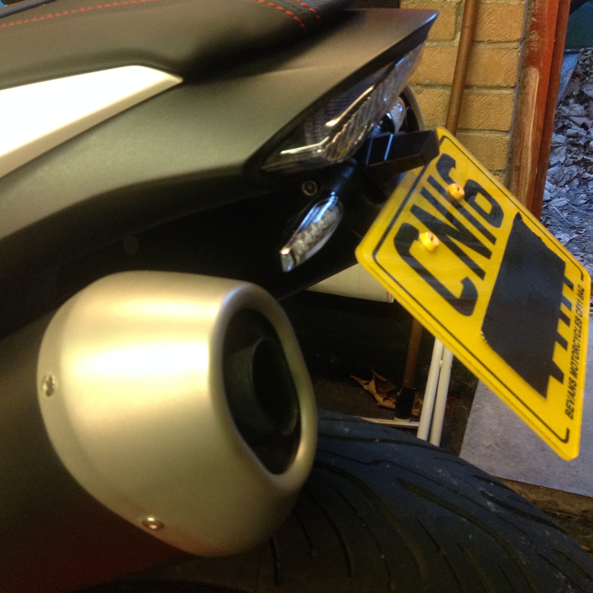

    This is my Evotech tail tidy, with 8x6 number plate.
    Evotech is top quality, think some people on here sent the R&G's back

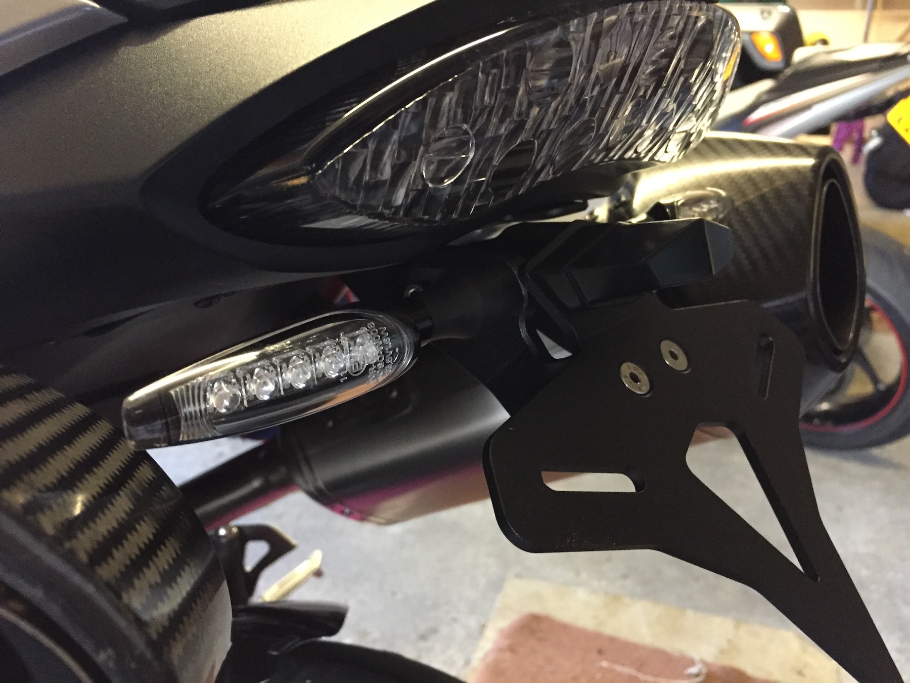

    Evotech tail tidy with high level arrows straight out the box 20170122_140707.jpg

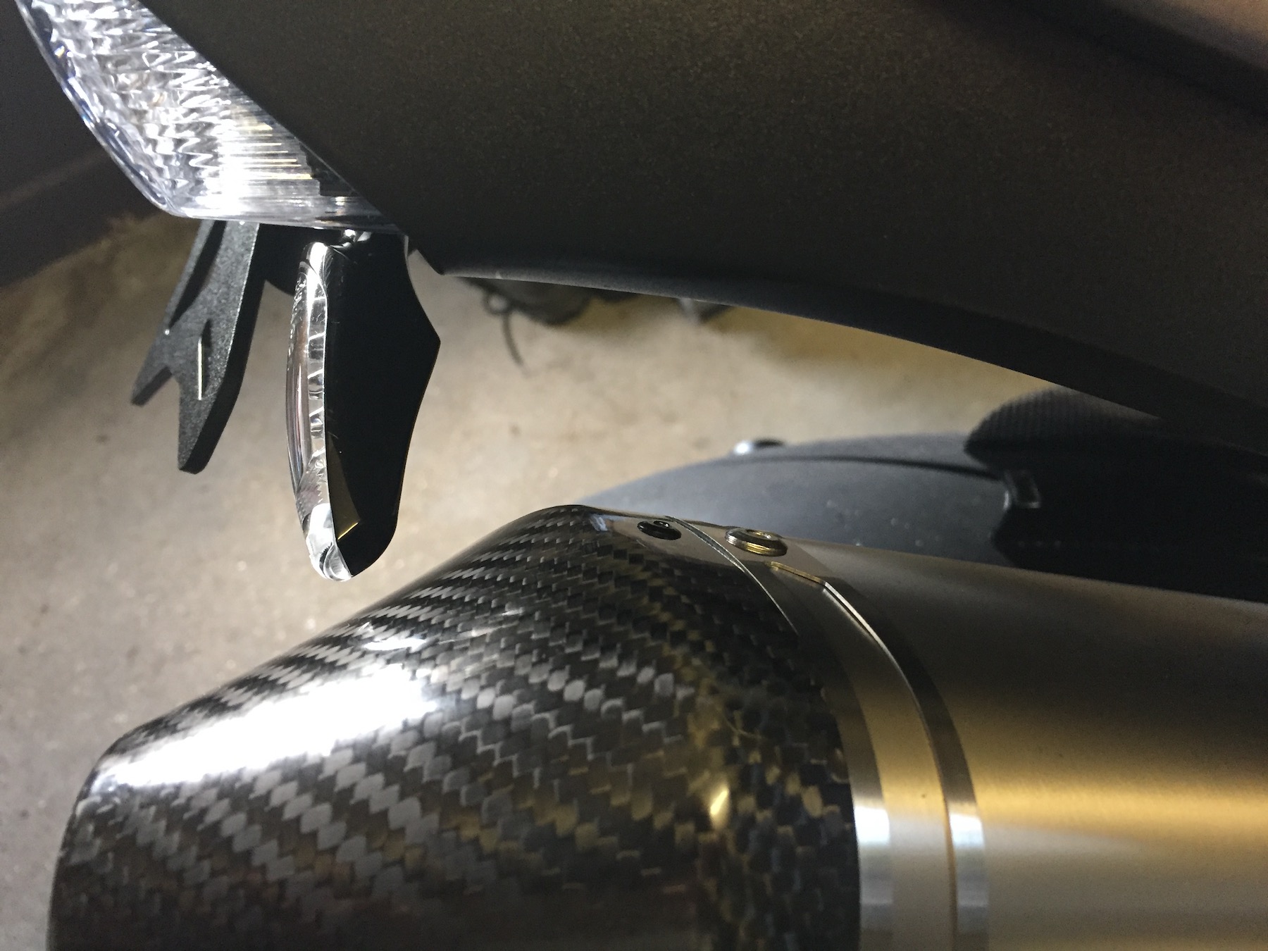

    Just joined today - so here's my first contribution...
    The tail tidy has been an ongoing project for me, especially given the lack of options when the 2016 model hit the showrooms...and I've messed about with several configurations, so if this helps, here's what I found.
    I started by replacing the stock tail untidy for the R&G version. It was relatively straightforward to fit, although it did seem to need a bit of encouragement to line it up straight and I struggled with the LED number plate light until I realised that the black wire connects to yellow, and yellow to black. Obvious mistake.
    Then my Arrows that had been on back order turned up - and as people confirm on here, the LED indicators are pushed up at 30 degrees and touch the carbon tips. I called R&G and they had no solution, but my local Triumph dealer sold me a set of R&G brackets made to raise the indicators out of the way.
    The brackets bothered me - it's not an elegant look (OK, I hate them) and after discovering Evotech and buying their radiator guard, I contacted them to ask if their tail tidy would fit with the Arrows. They didn't know.
    I bought one anyway and it's amazing. The quality is superb (it makes the R&G version look like it's made of tin foil) and the fit is millimetre perfect. It looks like this:
    3-TailTidy_EvoT_Arrows.jpg 4-TailTidy_EvoT_Arrows.jpg 5-TailTidy_EvoT_Arrows.jpg
    R&G tidy with high and low brackets going spare if anyone needs them ;-)

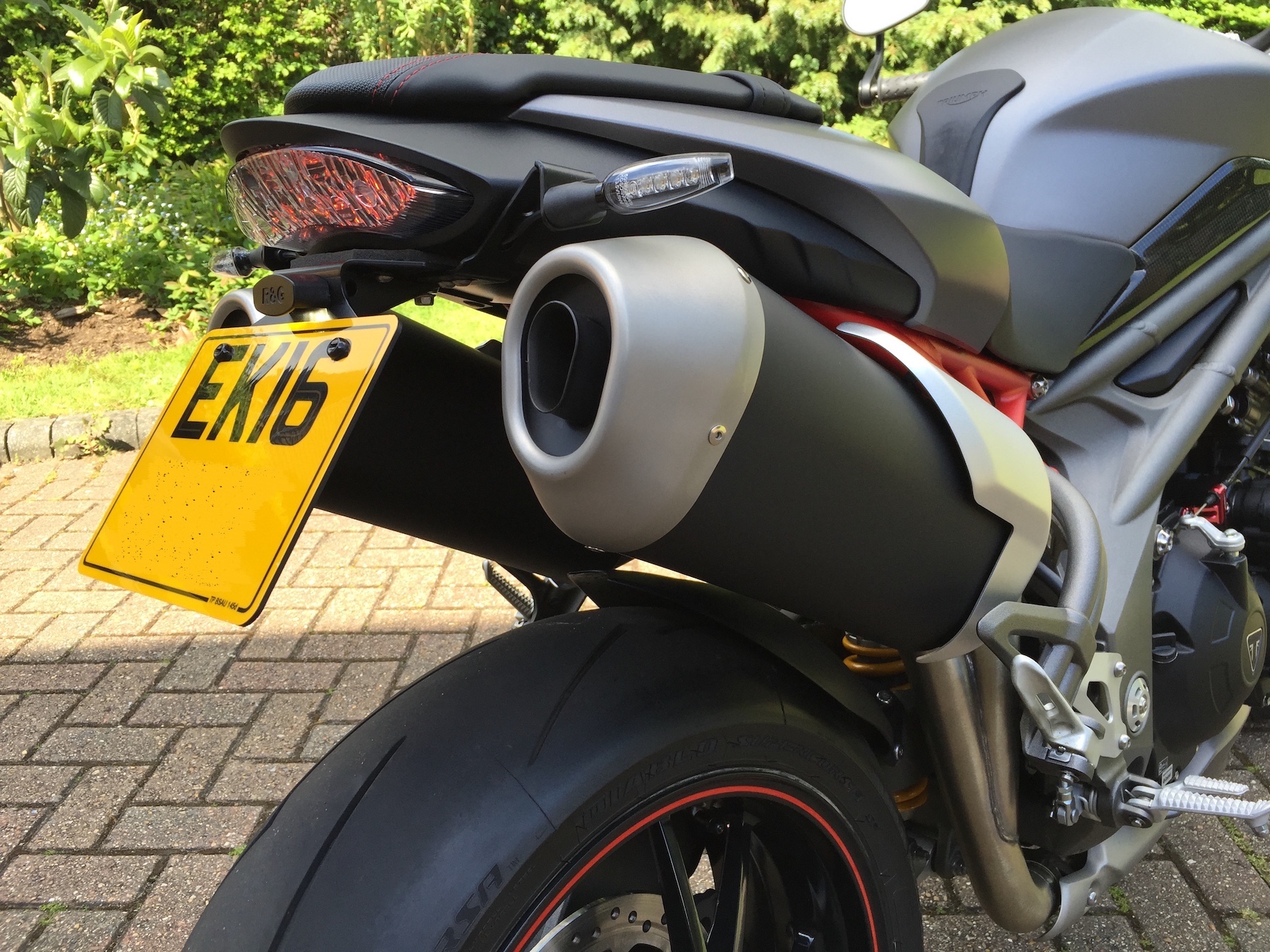

    Definitely the best - much nicer than the 'chicken wire' style.

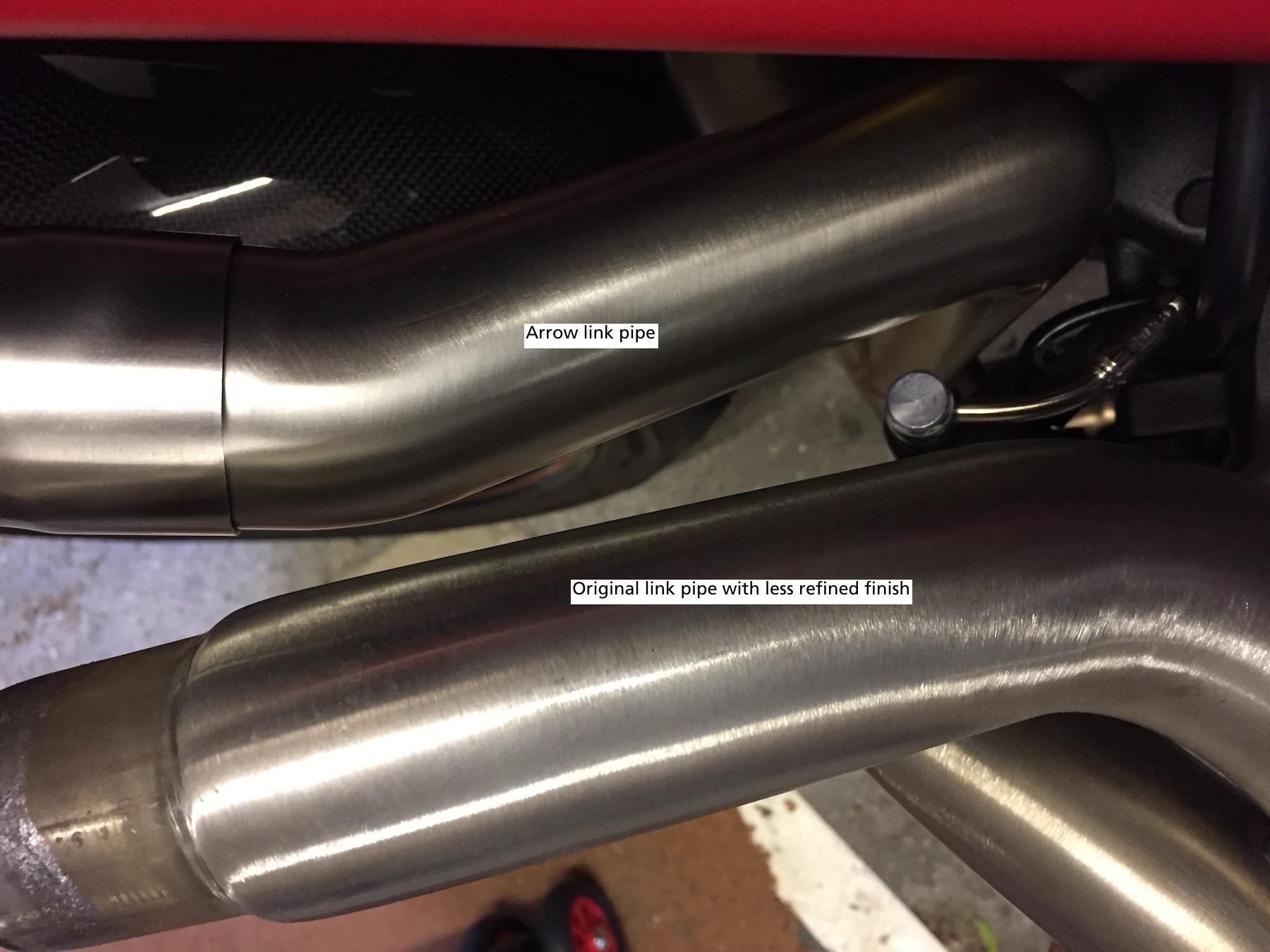

    I recovered the link pipe from the loft and took some photos (for what it's worth!). I can't line things up to get a proper idea of size comparison, but the stock pipe is much bulkier with less refined bends and looks like it would push the cans further out.

    I did some more thinking. Proper considered thinking.
    It can't be the link pipe can it? The problem is the distance between the hanger and the tip of the can...which is fixed.
    I'm going to lose sleep over this :eek:
