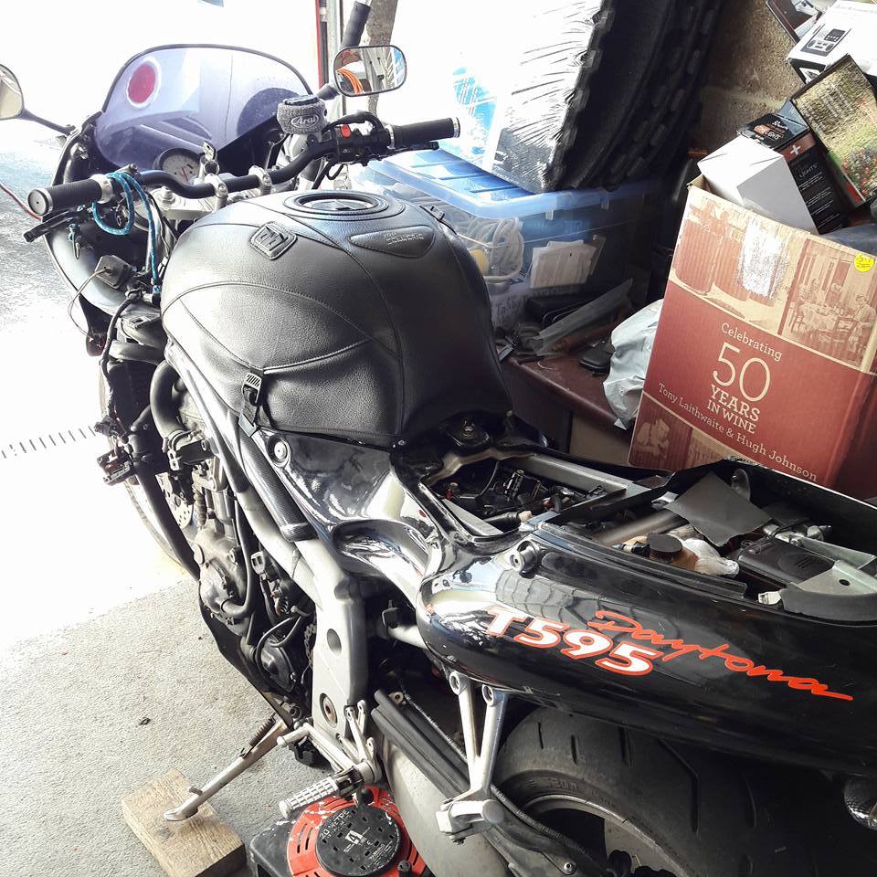

    Some photos of bike, so we can see the general condition, would be good ( every little helps)
    You checked the connectors have you checked the relays, take then out one at a time clean and check then replace firmly
    Put everything back to where it was when it stared, after you replaced the solenoid ( you could have let the battery dip below starting power.)
    Is the fuel pump priming?
    It seems to me this is not a huge problem. dont change masses of things with out changing them back You dont want to be making issues as you go or its circles for you. I had the delay with the starter and it was a connection.

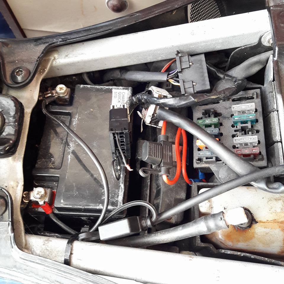

  15. Bernie
    Bernie Member
    Oct 4, 2017
    32
    Kingsbridge, Devon
    More pics
  16. Sprinter
    Yeah before you know it you can cause another problem that masks the first. A determined little girl there:). I have heard of TPS causing that type of problem, Good Luck:).
