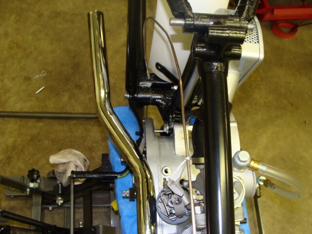

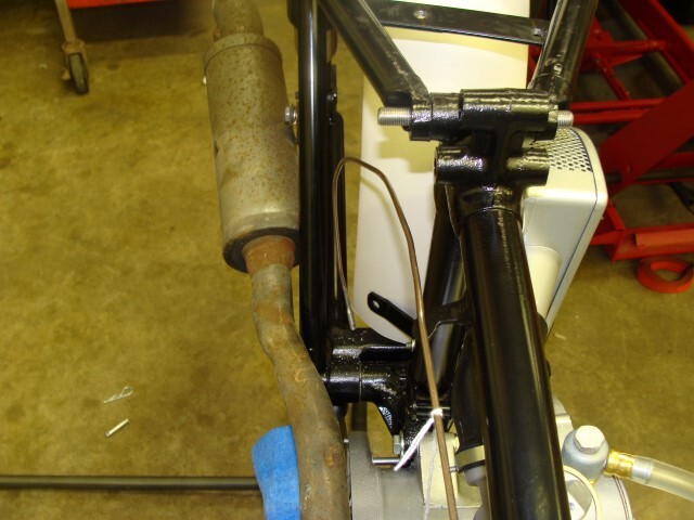

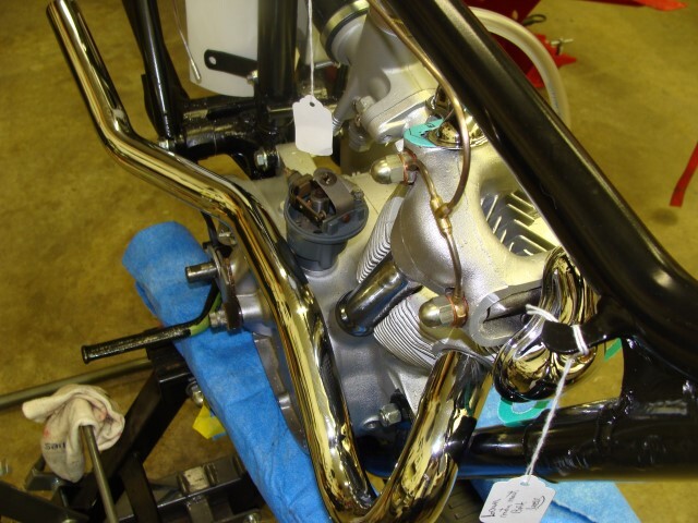

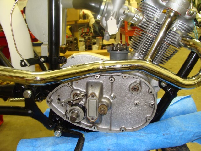

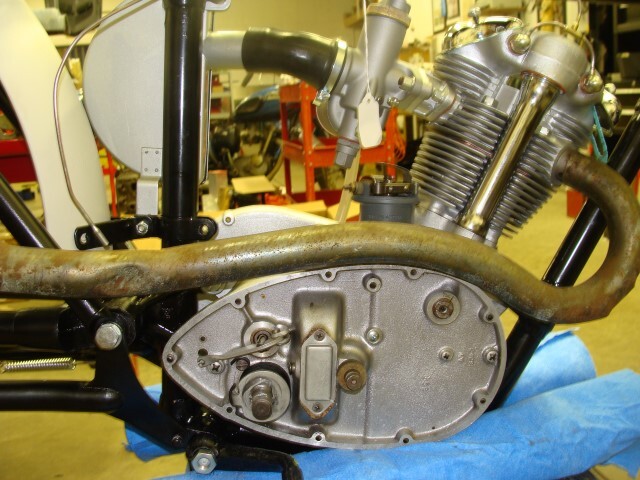

    I have enclosed a few pictures of the restoration of the 1960 T20S. I have been unable to find the correct exhaust for the bike. The closest I have found, hits the distributor, and does not hug the frame tight enough.
    The original exhaust is junk, but has the correct bend. Someone must make a correct header pipe for this model. I would greatly appreciate any help finding one. Thanks, Mark DSC06612.JPG DSC06873.JPG

    It's always going to be a game of chance with aftermarket pipes and the smooth bends on that original make the replacement look a little bit agricultural. I guess the original is beyond practical and economic redemption?

    We have looked at your pictures and believe that our high level pipe for the distributor model does resemble the original one from your bike. It certainly does not kick away from the bike like the one you have obtained in the USA. The pipe is ARMW23 £ 55.00 (not on our web-site yet)

    My personal view is that this pipe looks a LOT better than the new one that you showed from Baxters, but I really don't have a view on whether it's worth a punt at £50+ plus postage. I'm happy to buy, and resend if you want to take the punt but it would not be practical to return. That said, it might easily be realeable in the US, though Cubs of this year are not exactly plentiful!
